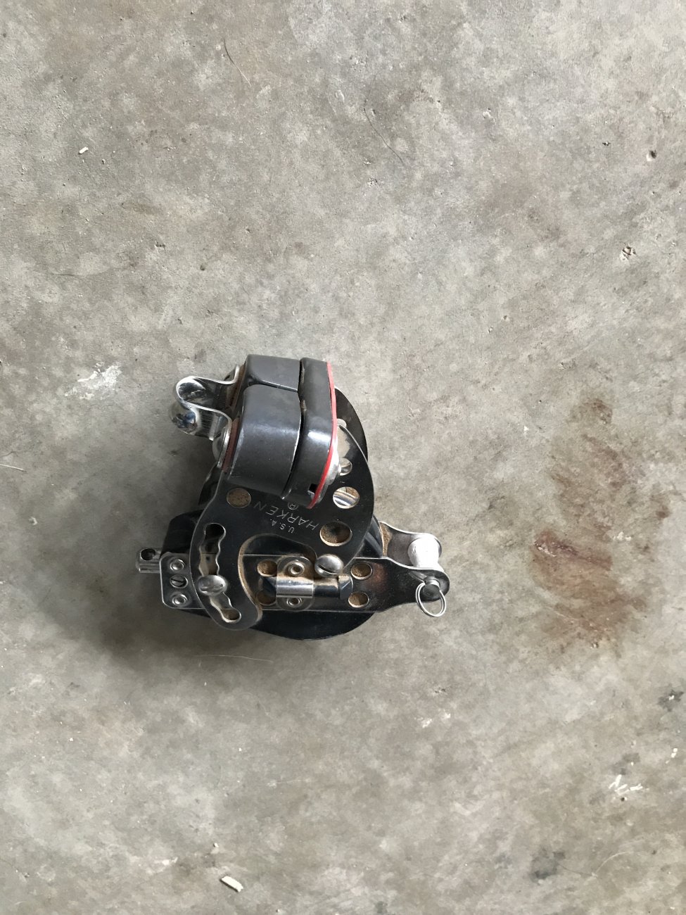

Has anyone put blocks on mast foot to control out haul topping lift and reef line the original set up seems difficult to control without going to mast. would a couple of these work?
7,993
-na -NA Anywhere USA
Just to be sure take a photo of mast base. My thought is no due to metal but send me a private message for better suggestions and if you use them, then I would ask to post under boat info boat mods. Also describe topping lift and size of line.
