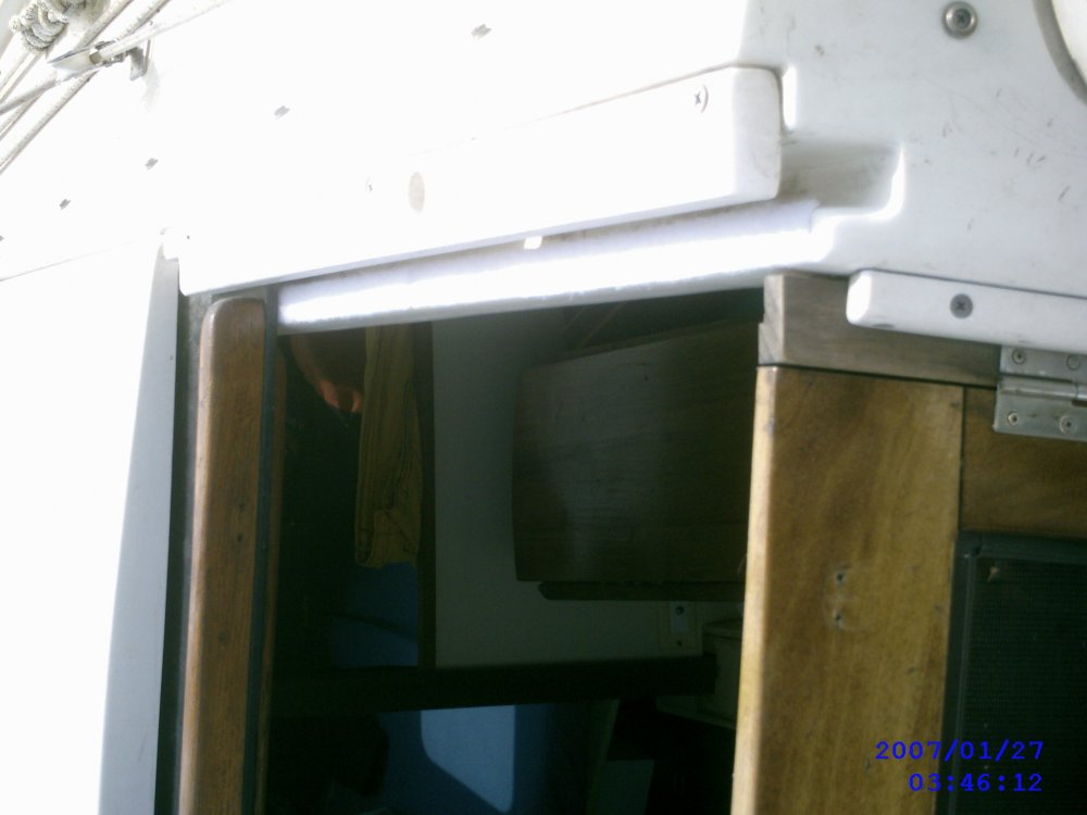

Doug, mine was fairly obvious, just look at your lexan and see it is touching the vertical fiberglass sides of the hatch opening. Mine was actually wedging itself between the two .
You're right! When the lexan heats up in the sun, it expands and gets too tight on the sides. I will sand down the sides a little. You're also right about it being obvious. I didn't see it before.
