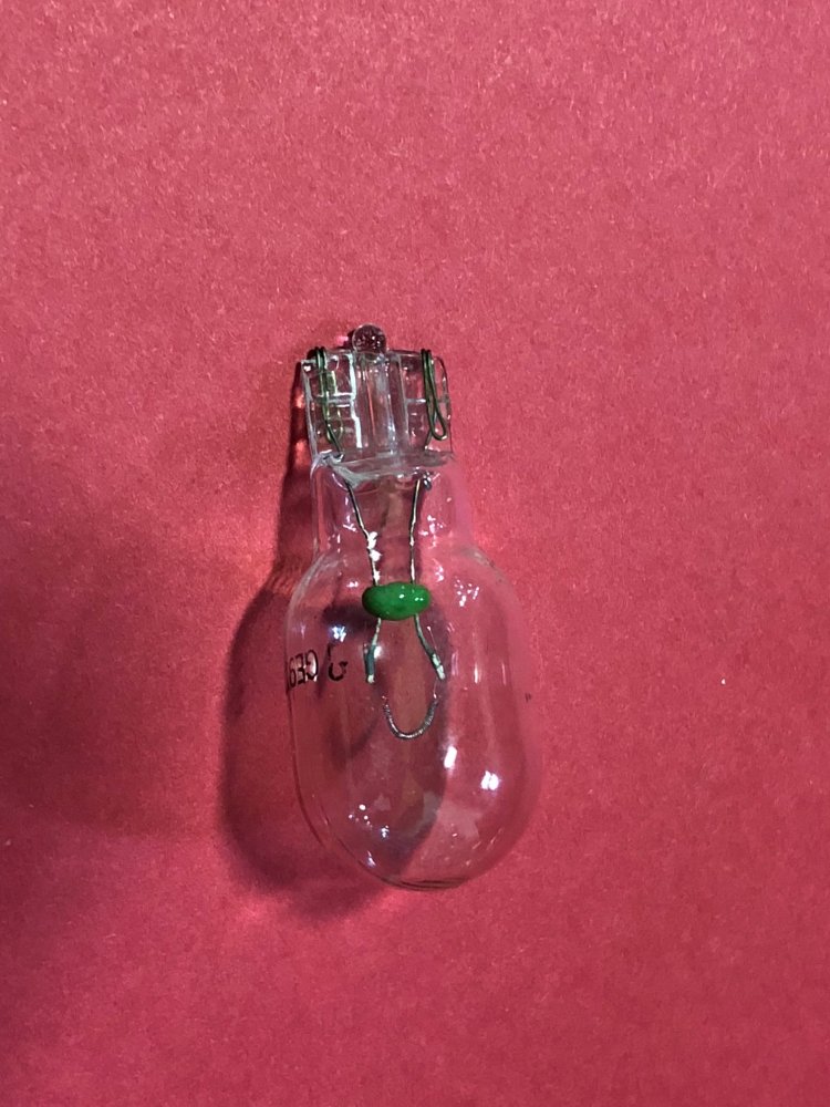

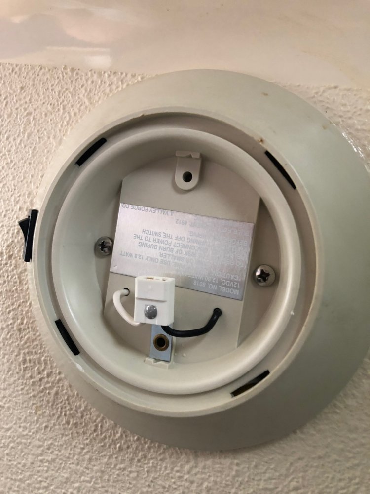

OK attached is a pic of the original bulb and fixture, the bulb seems to just push in and I am still having trouble finding a LED replacement. On the original bulb it has "GE9121" printed on the glass. thanks Chris

@Charisma that label on the fixture calls out the replacement bulb type. I can't tell for sure but it looks like the last three digits are 912. It also indicates the maximum rating of the bulb is 12.8 Watts. Between that an dthe photo of the bulb I'd say that's an automotive type #912 bulb, just like this one:
https://shop.advanceautoparts.com/p/sylvania-912-longlife-mini-bulb-pack-of-2-912llbp2/25984881-P
A little more digging finds this as an LED replacement for the 912
https://shop.advanceautoparts.com/p/sylvania-912-led-mini-bulb-912slbp2/11920754-P?searchTerm=912
These bulbs are quite common. Check out your local auto parts store and see what they have available. Often if you check their website first, they will tell you what the local store has in stock before you make the trip.

Check the "heat" output of the LED. Some put out enough heat to melt the plastic cover.
