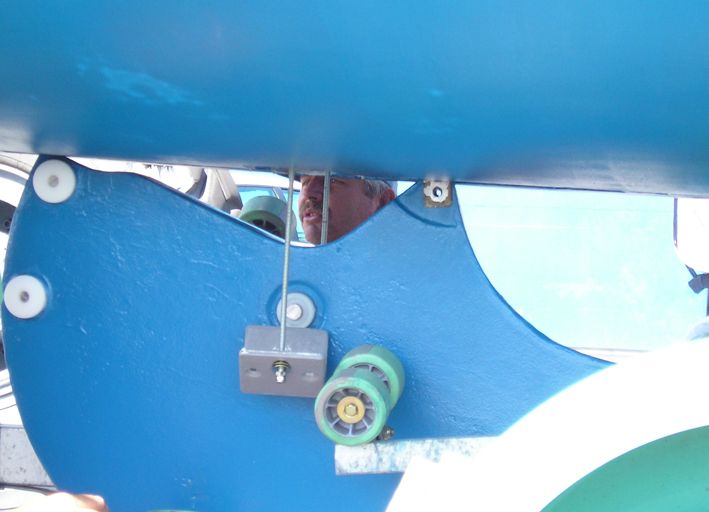

On the Hunter water ballast centerboard brackets are two white plastic Derwin sheaves that are designed to snug the centerboard from slapping sideways. If that is happening I would suggest inspecting the centerboard housing. I would not run any lines secured to the lower section of the centerboard thru the centerboard housing.
I don't see that on the H26 centerboard bracket drawing, unless you are referring to the "chafe blocks" which would indeed limit some lateral motion (not sure how much). When the boat is out of the water again I will inspect to see if these are visible and undamaged.
