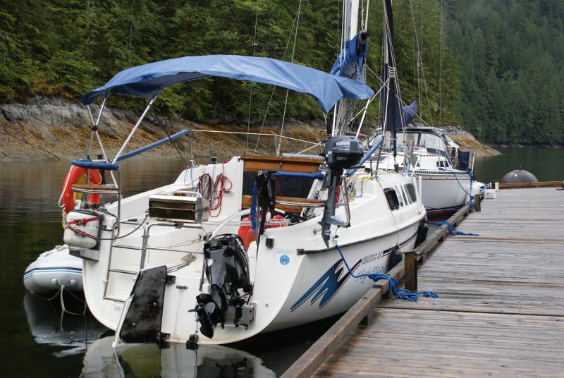

Great work! I presume you have the same lifting hatch I do on my 2008 H25. I am also going to install a dodger (from a pop top cover with a front window) and would like to see how your supports are connected.
Sep 28, 2008
68
Hunter 26 Ghost lake
The main hoop is placed into the holes in the cover track and the front supports are thru pin mounts on the edge of the pop top opening. I have never needed to use the pop top so as you can see the solar panel covers it partly so the dodger is short.

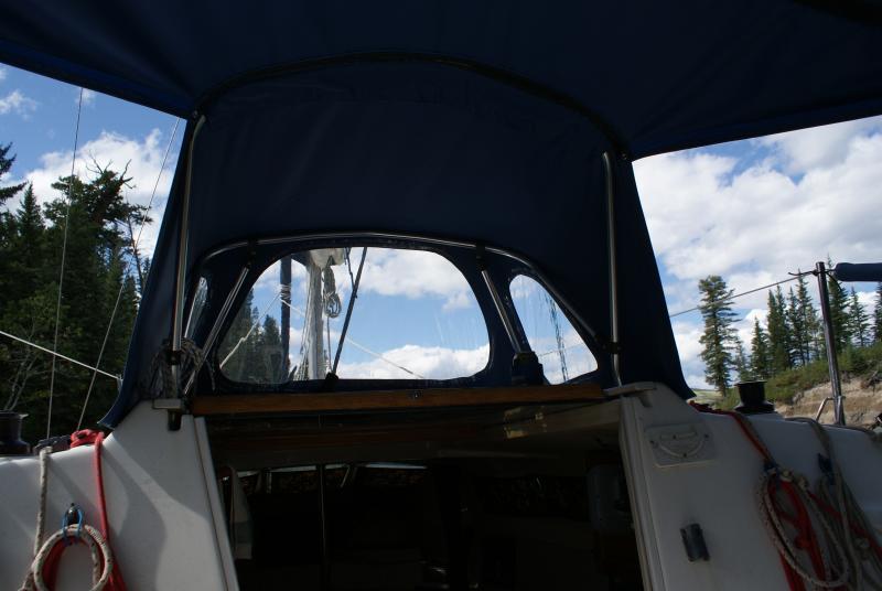

Dodger looks great! I'm guessing that you cannot close the sliding hatch completely if you are using the holes in the cover track and that you have to remove the dodger when you lock-up.
Sep 28, 2008
68
To close the clear hatch cover I used the holes to mark the interference area on the hatch and the cut it out, beveled the edges, tapered the leading corner and the hatch now slides open and closed with the dodger up and intact.
