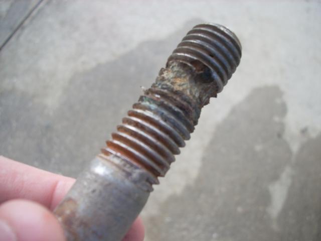

At 7y/o I pulled the main 3/4" bolt that attaches my CB bracket to the boat and found it corroded by about 25-30% and our boat was rarely in the water the first 3yrs(on a lift or trailered). Either really cheap Chinese stainless or lightning was my guess. No other obvious signs of a strike and for the past 4yrs the boat has spent 7mths a year in the water. The CB support bracket has no signs of corrosion or galvanic issues. I've replaced the bolt.
I'm sure your boat is fine but it's almost time to replace the CB line so check that bolt too. Pic of the bolt and CB bracket too.
