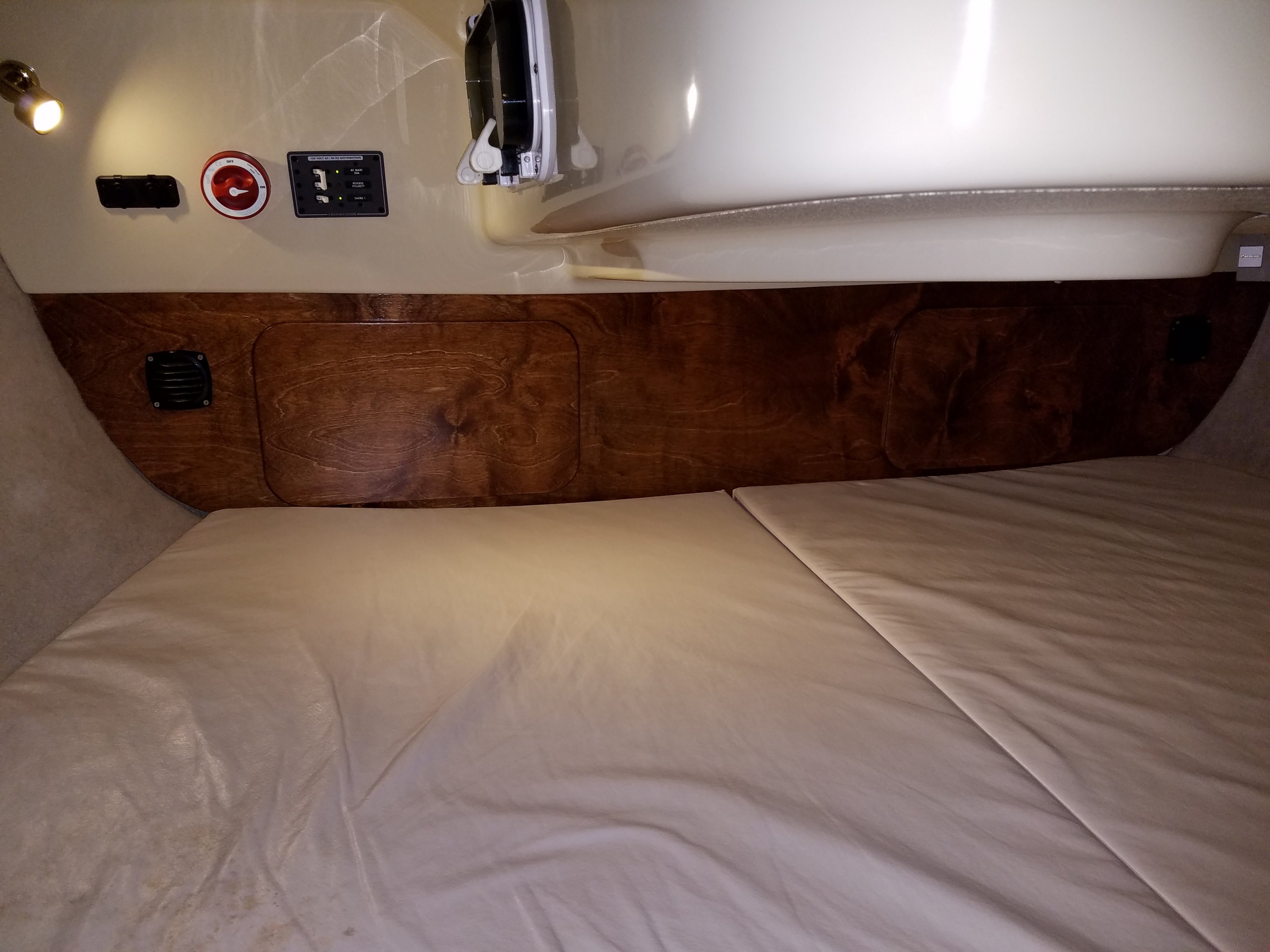

I happen to have just measured recently. The starboard side on my H26 is about 83" and the port side is about 93". That is measuring down the center of the boat from the center of the curve of the seats. They are not too wide and not very comfortable. I modified my table so it does drop all the way down. I actually leave the table down most of the time now and have lots of sleeping room. If only I could move that darn post in the middle.

I have a H26 and have slept in the v-berth with the table spun around. It's nice because you can look up at the stars through the windows and can open the hatch for nice ventilation.

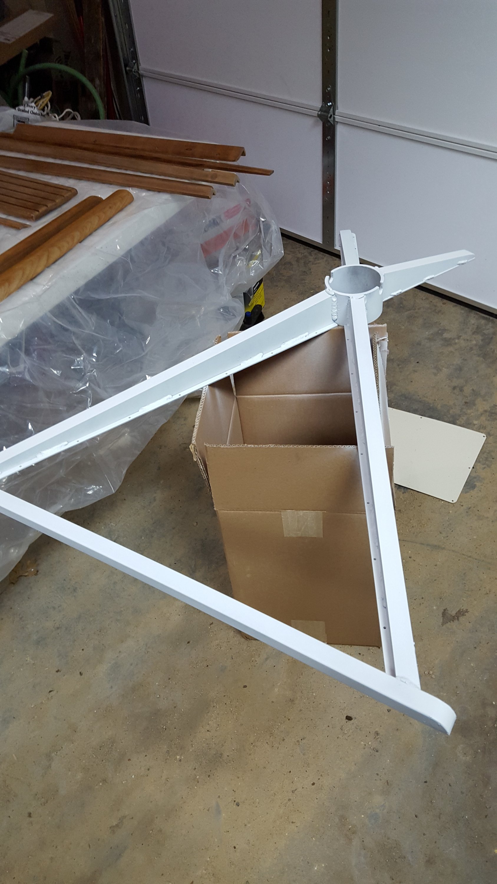

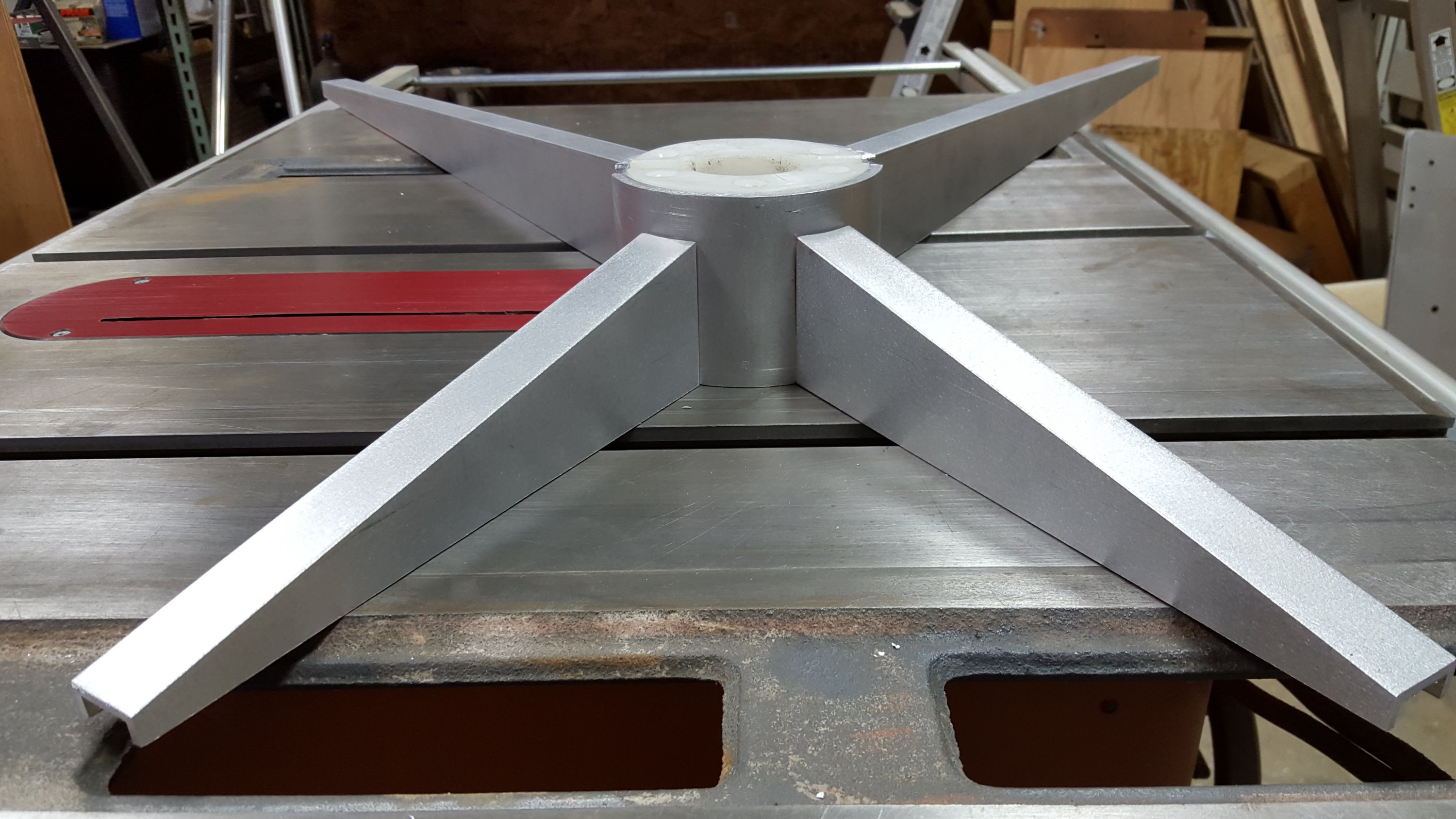

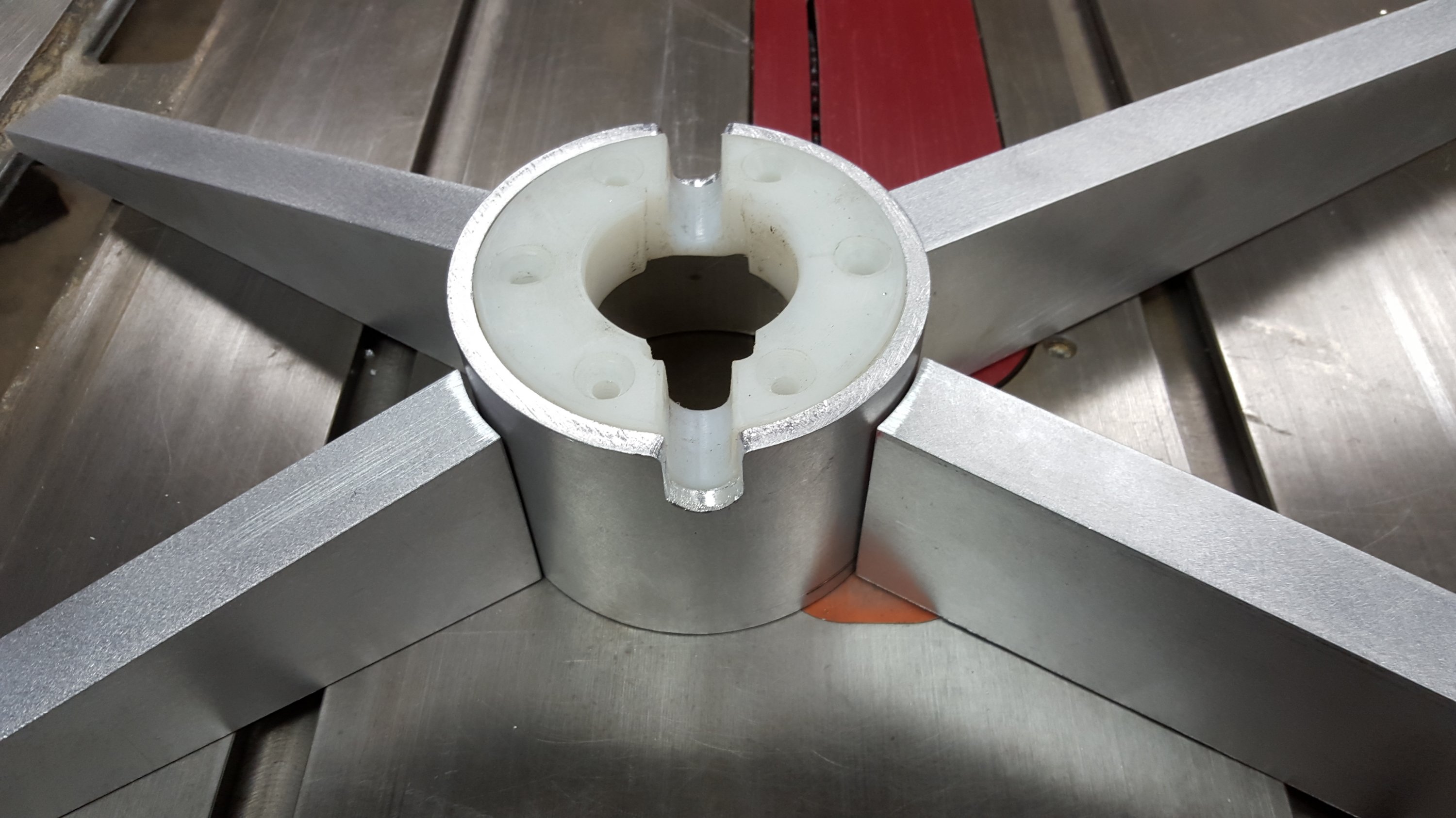

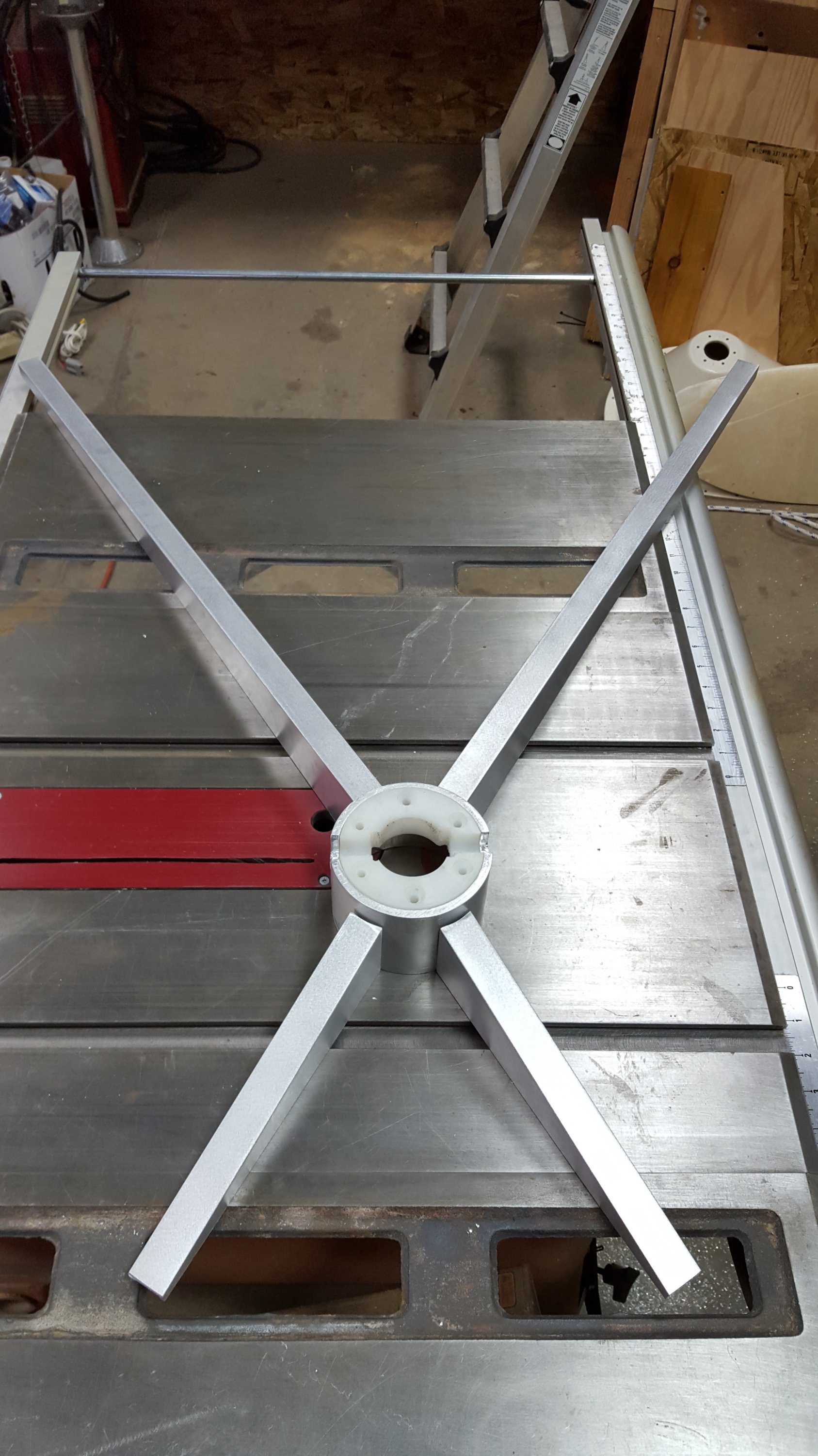

Here are some more of the bracket I made. It is upside down here, of course. It is aluminum and I only have a wire feed welder so my welding isn't pretty but it works. First few shots are when I was cutting the parts. Last one is it welded and painted. The hole in the center holds the plastic ring from the original support cone. I also cut a couple more of those rings and stacked them in there too.

Oh, now that is really nice! Would you say the table is as sturdy as the original cone design?
I would say it is strong enough for me. It might not be quite as strong as the original but its pretty close. I'm happy with it.

rade0041
is that tapered channel or did you rip regular channel on a bevel to make the tapered channel ?

rade0041
beautiful work !
Thank you. They started out as rectangular tubing. I cut the taper on the table saw.

rade0041
what type blade did you use on table saw to rip the aluminum, and what size rectangular tubing did you use ?
