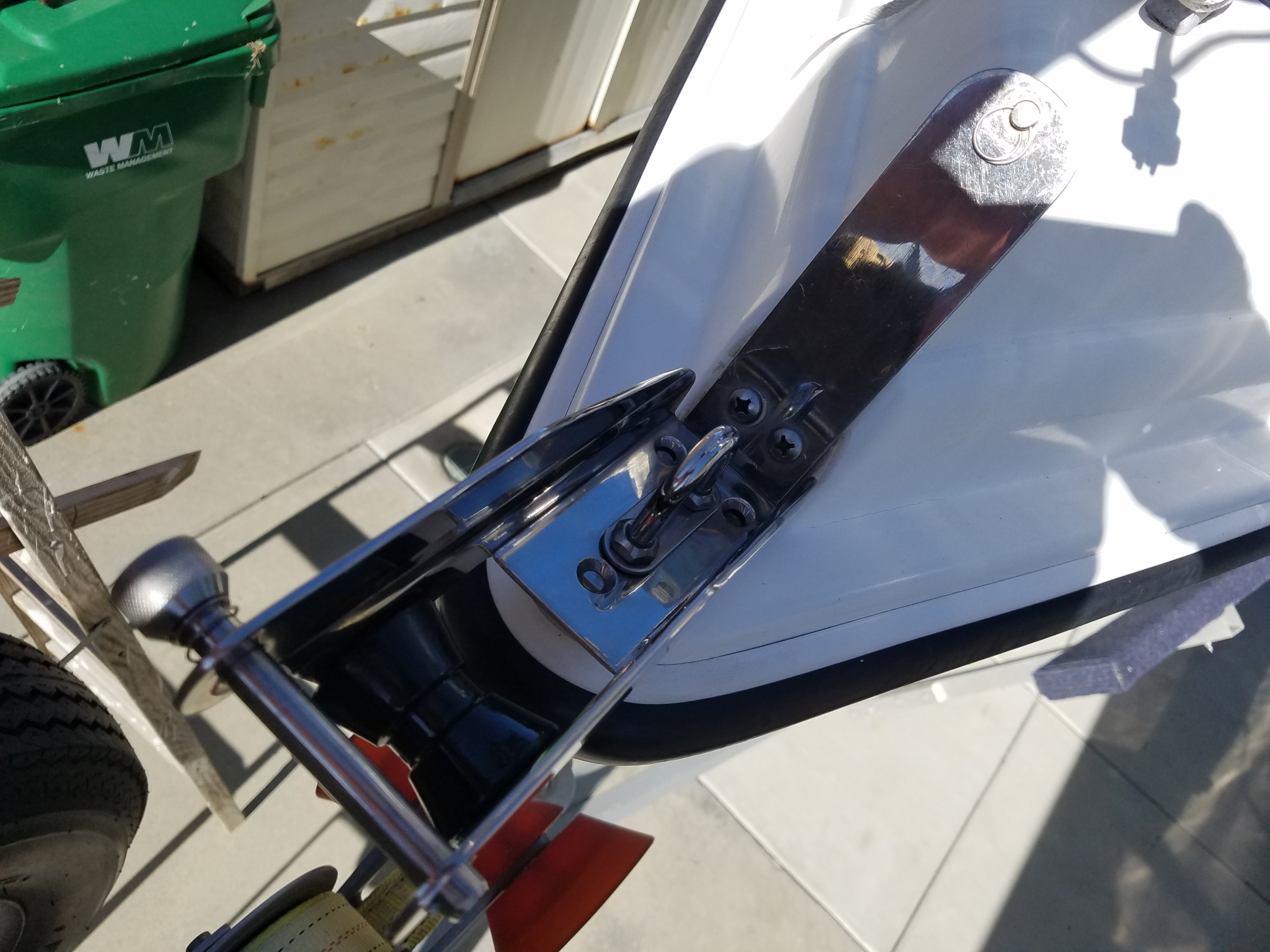

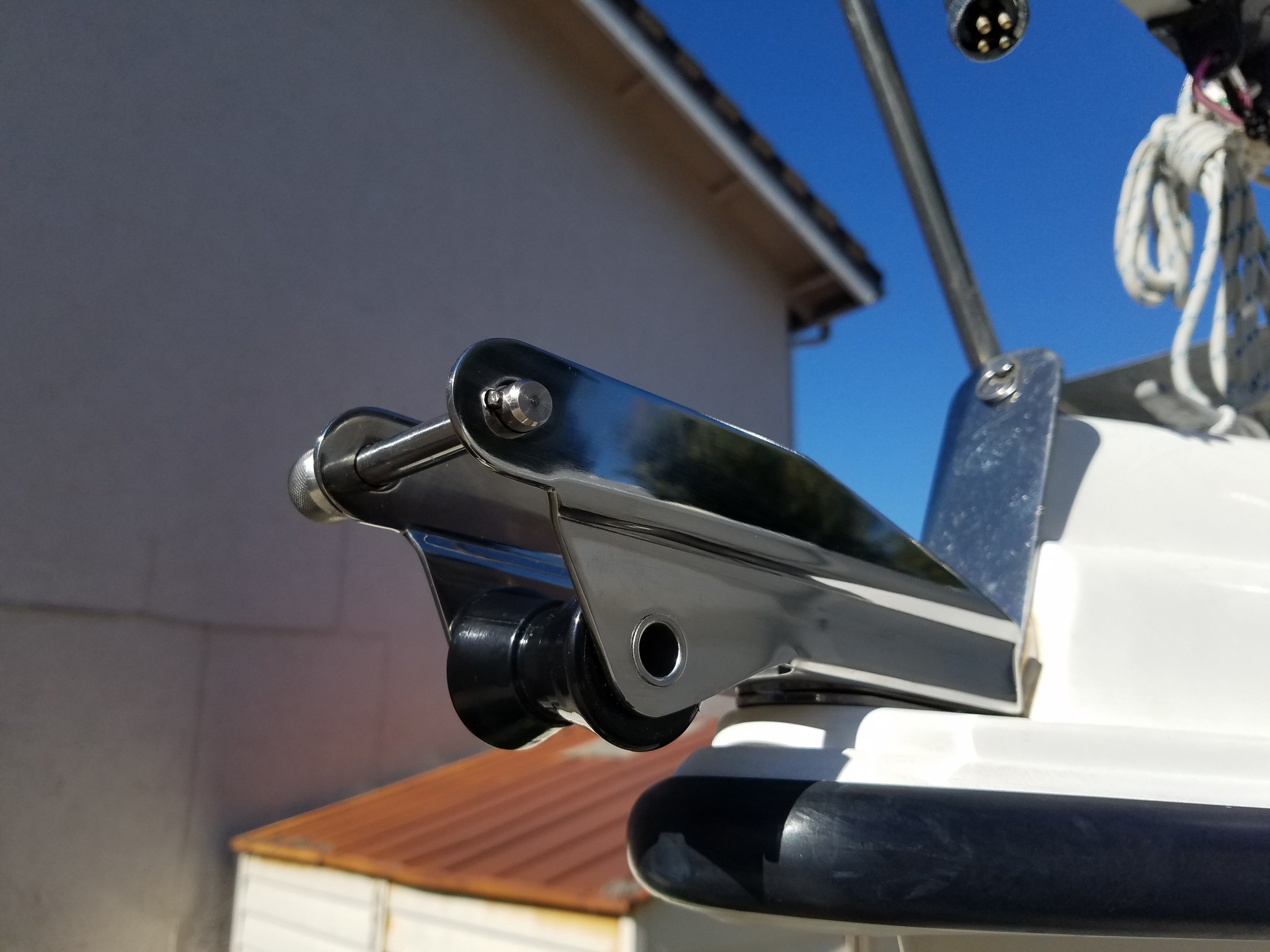

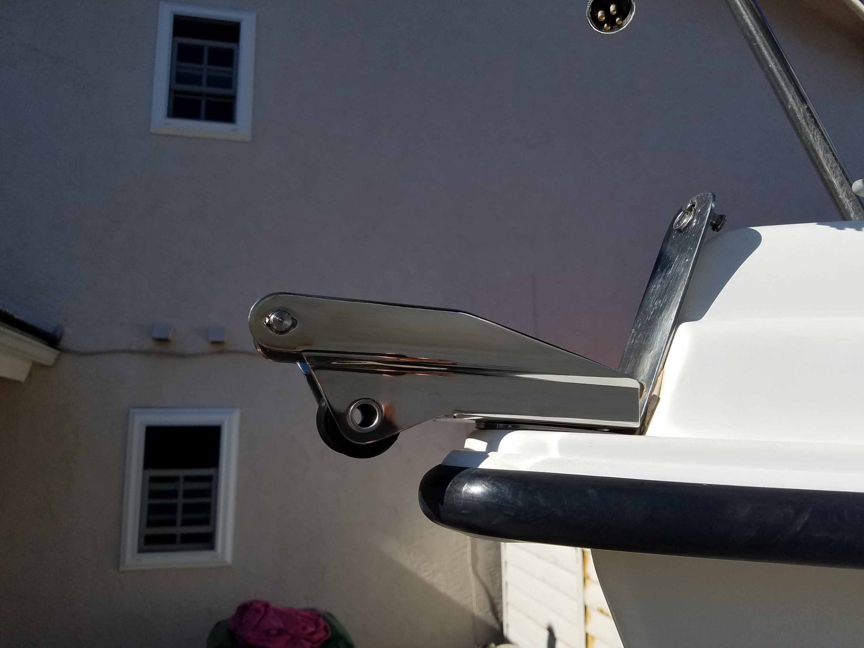

I love my H26 but have been wishing it had an anchor roller. I've been envious of the anchor roller that the 260's come with. There didn't seem to be an easy way to install one on the H26. I just finished this mod. It was easy to do and didn't even require drilling any new holes in the boat. I haven't tried it yet, but it's very sturdy. I think it will work well, and I think it looks good too!

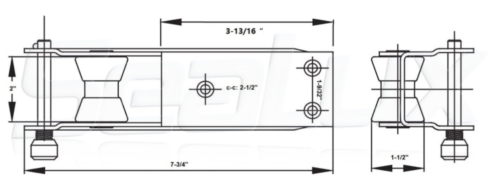

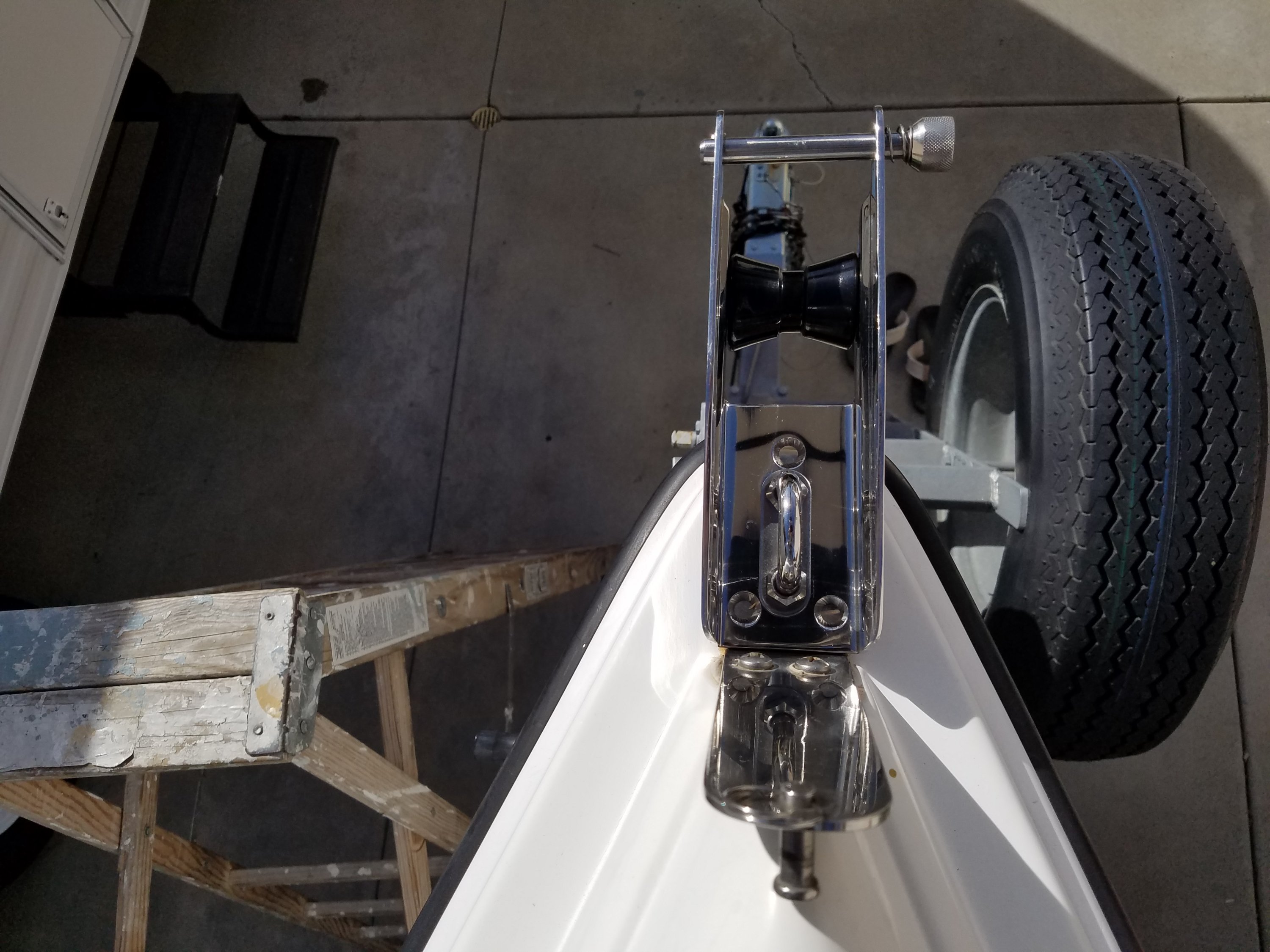

I think the size fits nicely. I drilled 2 new holes to allow the existing u-bolt to go thru and simply used the u-bolt to fasten it down. This is a SeaLux 316 Stainless Steel Bow Anchor Roller with quick release pin.

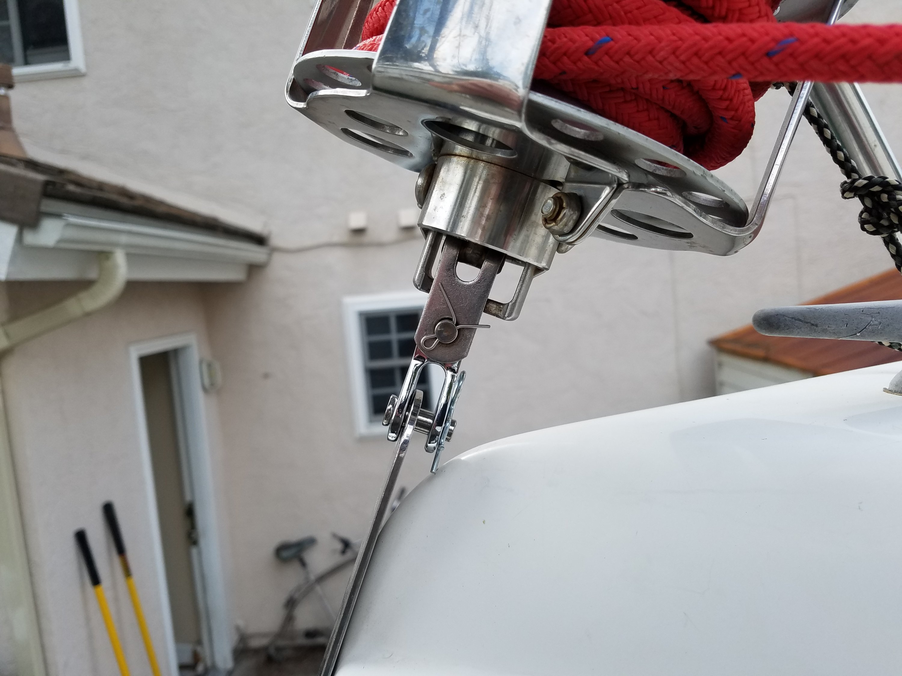

I know some H26's connect their head stay to the u-bolt. I had previously moved my head stay connection to the tang shown in the picture below, freeing up the u-bolt. But I think if you use an extension for your head stay to the u-bolt, this would still work for you.

I figured a roller installed under that u-bolt would work well. I looked for a short one to fit and installed it. Can't wait to try it. I didn't like dragging the rode and chain over the rub rail making more marks, and also I think it will be easier on the back.

I'll be using it Feb 10th, will let you know how it works out. Should be fine, it's plenty strong. The only potential issue may be that it's straight off the bow, so I'll need to work around the headstay with the furler drum.

You could raise the drum using two tangs but would require shortening the forestay some. Should not affect the Sail at all. If twisted the wrong way with the tangs you could use a twist shackle. Food for thought

Hopefully the furler drum won't be a problem, I don't think it will be. I really don't want to go through the hassle of shortening the headstay.
