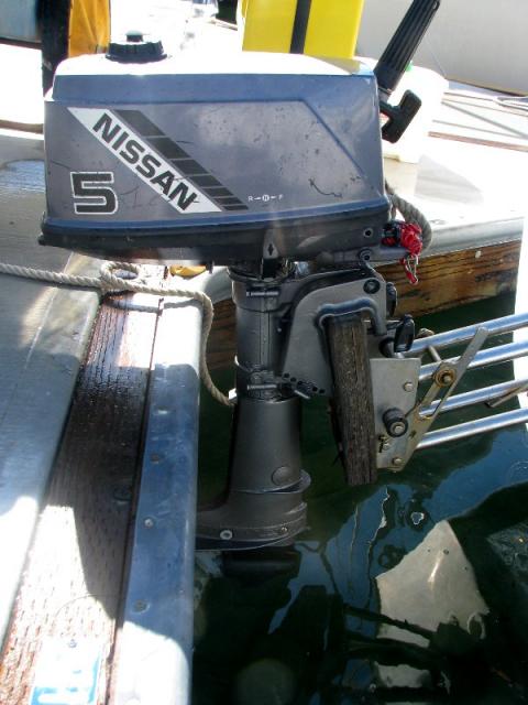

I know this is likely a much discussed topic, but since I am a new H25 owner, I found out quickly that my "longshaft" Nissan 5hp was not well suited to my new-to-me vessel!
I journeyed several miles in glasslike early morning, magnificent San Diego conditions yesterday with a friend aboard as crew to take my vessel to its new home. Noticed pretty quickly when I sent my buddy forward, that my Nissan 22" shaft would cavitate when his weight went forward! Take a look at the photo taken back at the slip and you will observe the cavitation plate is 2" above the water line.
So we spent the rest of the journey (no wind/early SD am) hanging 10 off the transome.
Not one to let sleeping dogs lie...after I worked my tail off scrubbing yesterday, I spent my evening searching for an Extra Long Shaft and found a nice Johnson with a 26" shaft in PA and quickly closed the deal (geez, I love the internet...thanks Al Gore)!

Wow.. I am surprised that the motor was able to cool itself. The water intake slots are really close to the existing water line on the motor.. The longer shaft is the answer! You are going to enjoy the boat, JB..

Had a problem like that once and modified the bracket so the engine would seat lower. It is likely that bracket was set at a height to match a much heavier engine. A long shaft is still the best solution but look at the boat balance to make sure the stern may not be sitting to high. Placement of batteries and other gear will affect balance.

Kloudie...you are right about the cooling...I kept a close eye out and both myself and my crewman were hanging ten at the aft of the transome to make certain that cavitation plate stayed in the water which it did when we were aboard.

According to where my outboard bracket is, a 20" shaft works quite well. I am actually relocating the bracket to provide just a bit more depth; but that's all it needs, just a bit. The biggest problem with this boat is going over rollies upon entering or leaving a harbor, having people on the foredeck and having the cavitation plate come up too high out of the water. It's just a process to change rather than to go to the ultra-rare 25" shaft length.
