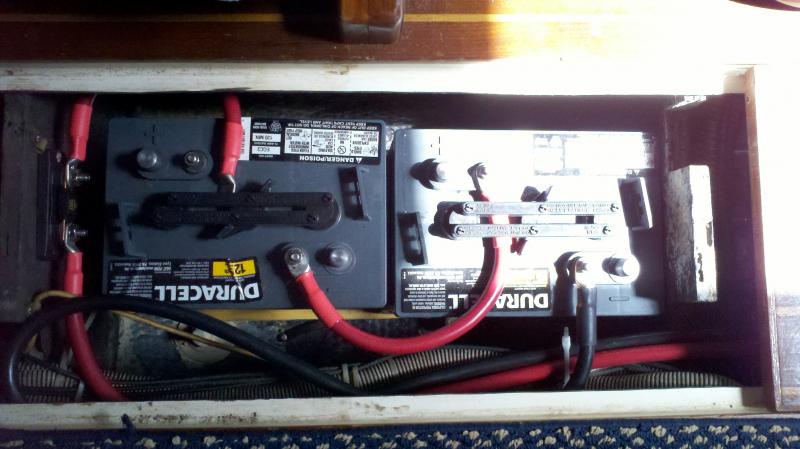

Maine Sail convinced me JC. Two winters ago, after ten years of very expensive Gels and AGMs, I converted. I cleared out a locker with five batteries totaling about 380 amp-hour for the four house batteries at a cost of $1000. to replace. In their place I have two 6V batteries in the bilge with 225 amp-hours that cost $80. each. These are DuraCells from Sam's Club.
