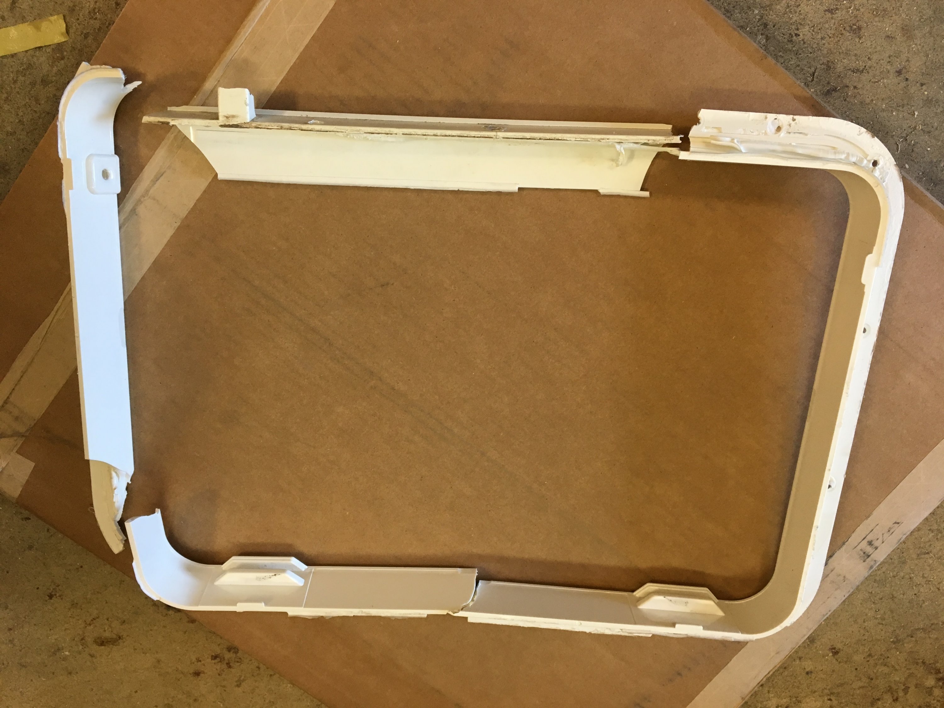

One of the few things that needs attention is the Bomar hatch under the cockpit seat. It looks like the hinges are cracked and it appears to be made of a type of plastic that doesn’t take well to glue.
Is there a fix for this, or is there a new hatch in my future? If so, how do you measure a hatch size? Has someone else replaced this part and knows the part numbers? Any help would be great.

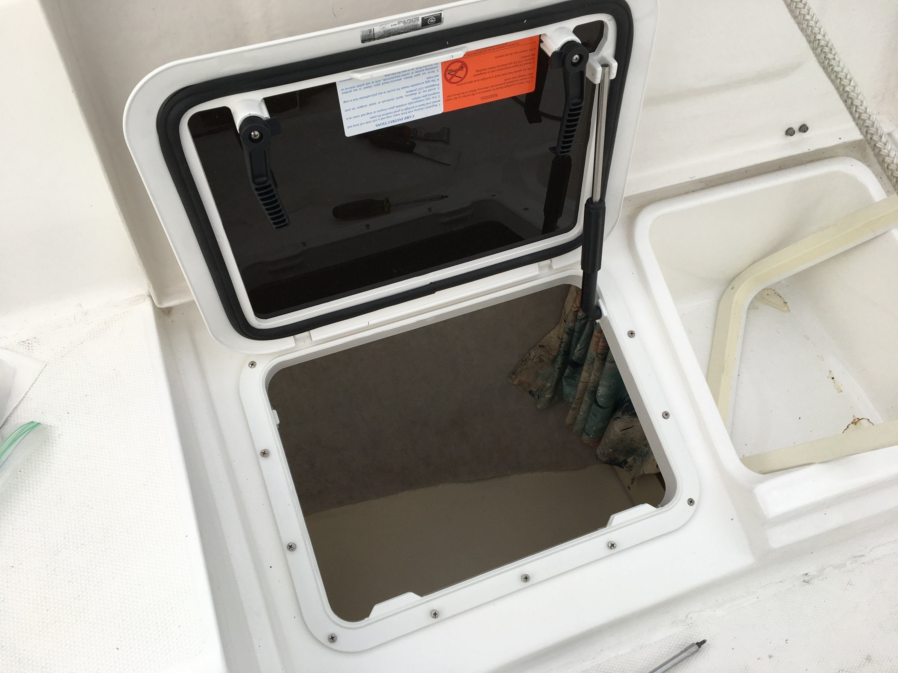

The new hatch showed up a few weeks ago; I checked it over good and put it back in the box to wait for warmer weather (I’m such a wimp!) Well, the boat is now in the driveway and it’s time to start on the projects. First I removed the screws and then I started working around the edges with a putty knife/scraper. I was going to try the fishing line trick, but since I wasn’t planning on re-using the old part, I chose a more aggressive approach! The hatch was actually pretty easy to remove.
After the removal, I cleaned up all the old adhesive (it appeared to be silicone) using a plastic scraper and my finger. Once clean, I counter sunk the screw holes a bit to prevent any more gel-coat cracking. Apparently, Hunter doesn’t countersink, and driving screws into just pilot drilled holes will cause cracking.
After countersinking, I cleaned the gel-coat surface with Isopropyl alcohol.

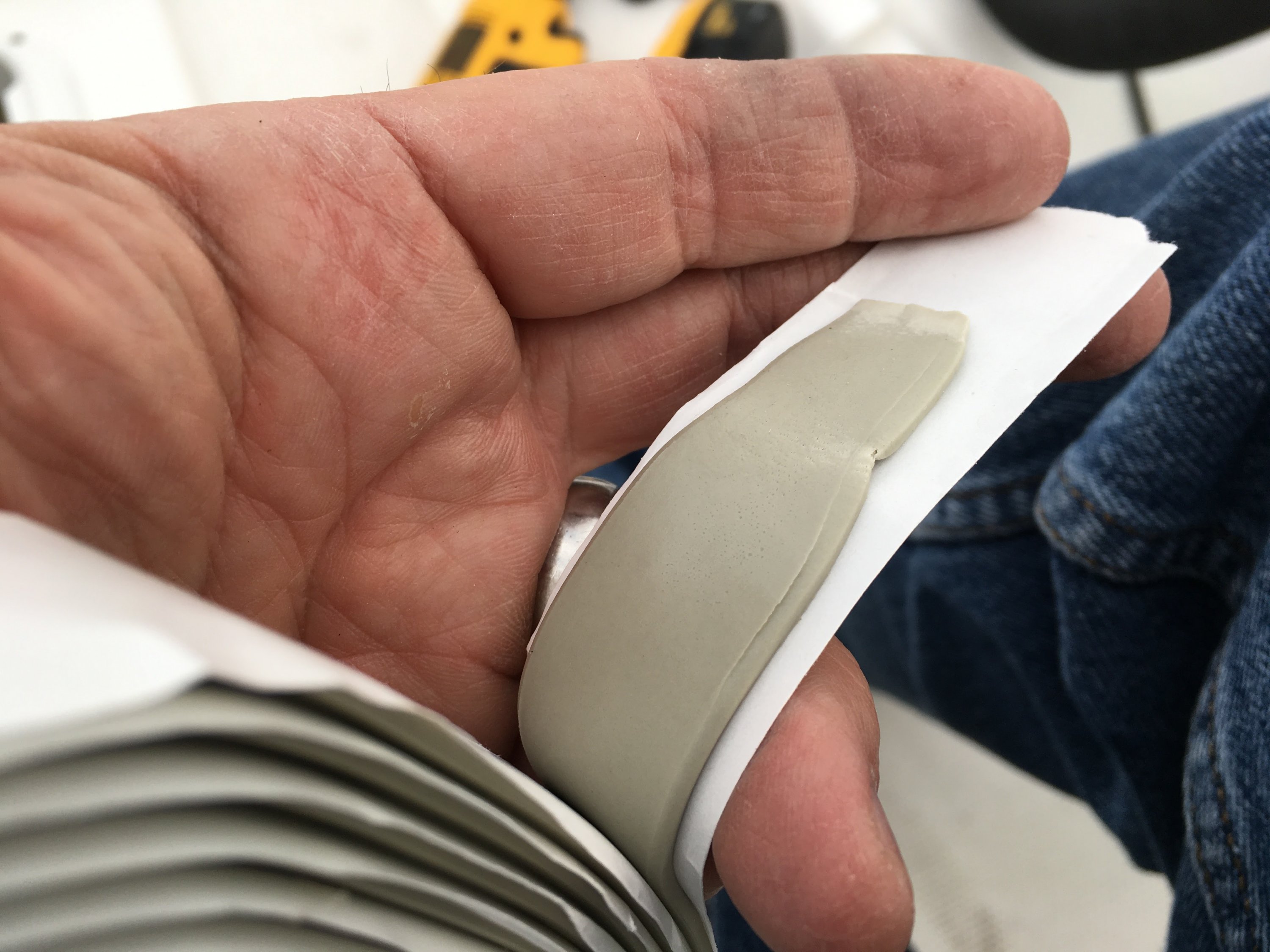

I decided to bed the hatch using butyl tape. Butyl has to be one of the best bedding sealers ever, but it takes patience. The butyl will continue to squeeze out for several weeks and needs to be cleaned up by scraping with a plastic scraper. It’s worth the hassle though; the stuff is amazing at sealing and stays soft for years. There are many how-to’s available about using butyl.

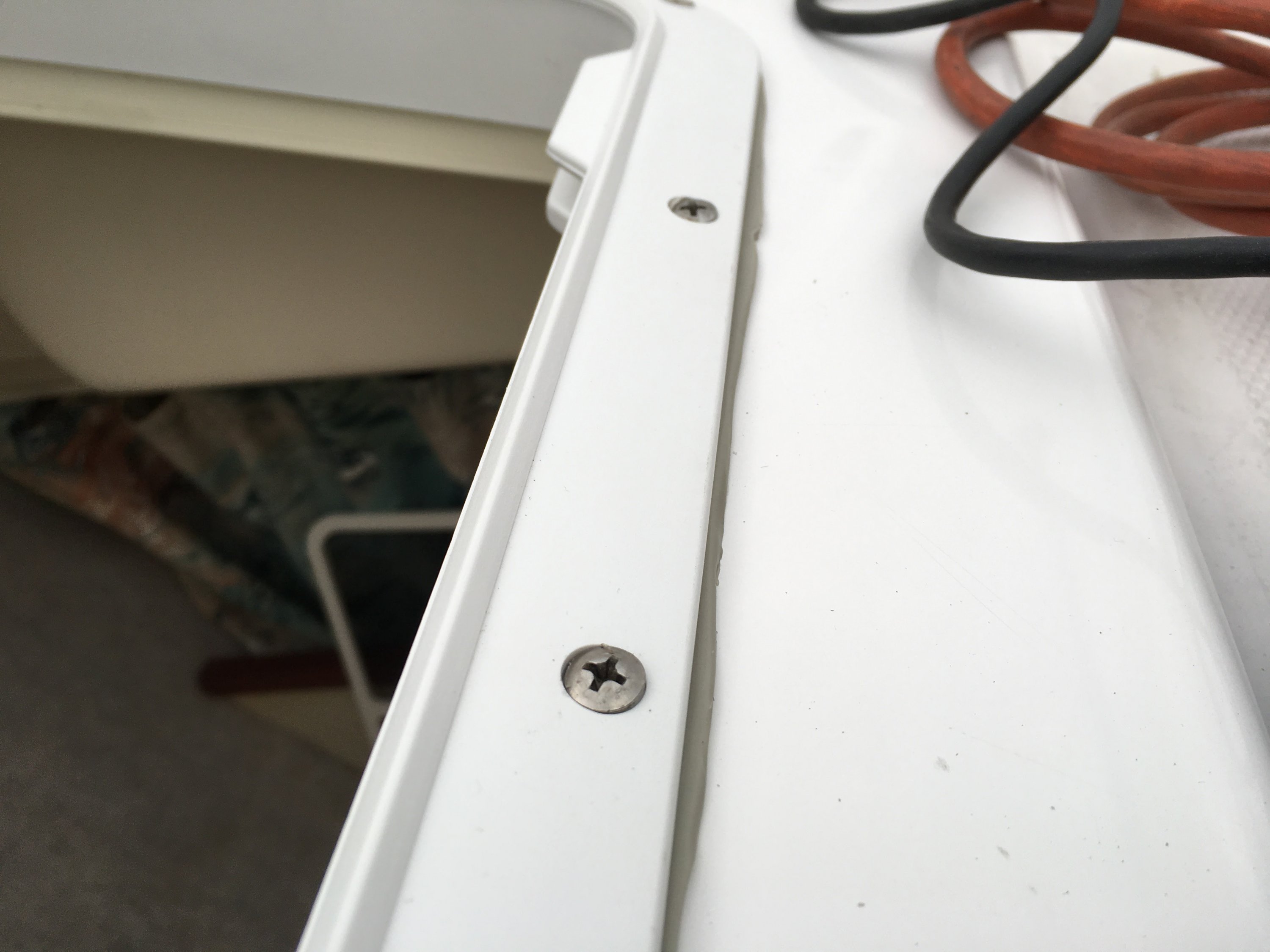

After replacing the screws, You slowly continue tightening until the squeeze out stops (or slows). The downside of butyl is that the squeeze out will continue for a long time and will need to be scrapped when it happens. The squeeze out will collect dust and dirt so it is much nicer looking if it is scraped off. The upside is that it will never leak! For me, it’s worth the tradeoff. After the topside was done, I reinstalled the trim ring from below and job done.

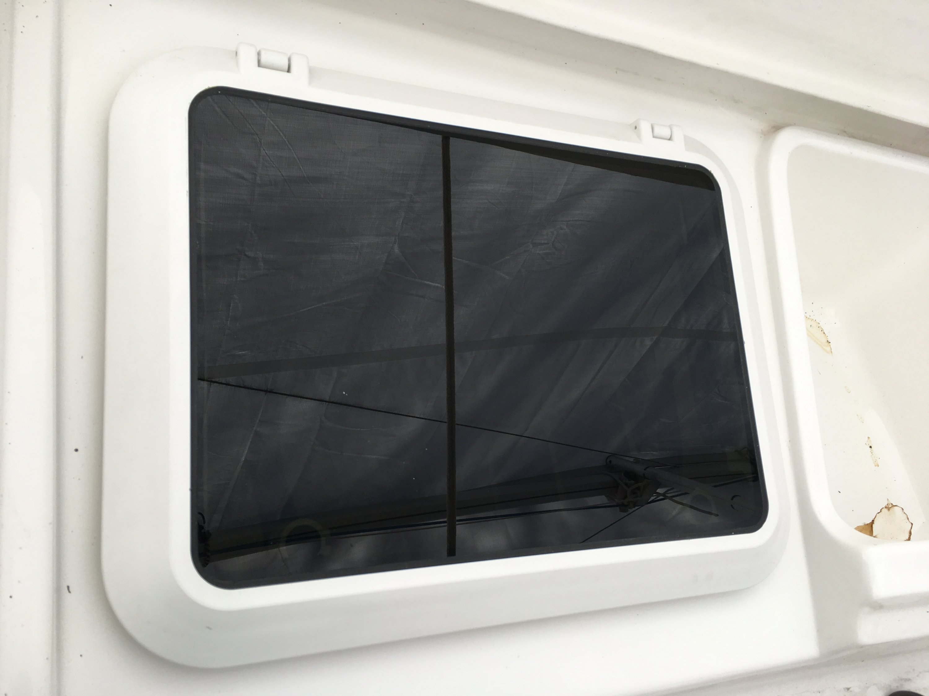

Here it is, all done and ready for sailing. I will continue tightening on and off for a few days and I will then scrape off the excess. Pretty easy job overall, it took about an hour and a half. It would be less than half that if I knew what I was doing.
