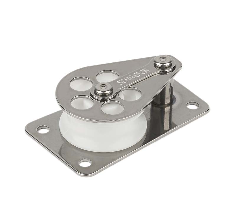

The centerboard uphaul cheek block on my 240 has bent and the sheave no longer turns freely. No doubt from the force exerted on this part raising the board.
Any reason not to use a ball bearing cheek block to replace? The Schaefer 300-09 is the same size/load rating as the original 30-27 part. Hoping the hole pattern is the same... Thought it might help reduce a little friction-
Anybody tried this?

Should not be a problem at all. When I replace parts like that I often upgrade if possible. The Schaefer 3 series 300-09 with delrin ball bearings is an upgrade. And for a cost difference of only around $10, it's what I would do.

Not sure but send a photo and lety me look. I would upgrade to the ball bearings and the bearings. If sending to my email personal make sure in the comments that you say hunter 240
crazy dave
10,531
-na -NA Anywhere USA
300-09 with the ball bearings would be the route to go. Remember you are taking machine screws out of the backing plate encapsulated in the fiberglass deck. I do think a call would be wise to see if any issues with the lifting mechanism. Ask Kermit for my cell phone number. Kermit ok to give out phone. Issues with this damn computer.

Thanks for the feedback- I'll get the ball-bearing replacement. The uphaul looks OK- it has always been very hard to raise the centerboard. It is a '98 model, with the original line. How long do they usually last? My problem is no lift anywhere near me to get it off the trailer and pull the board.
