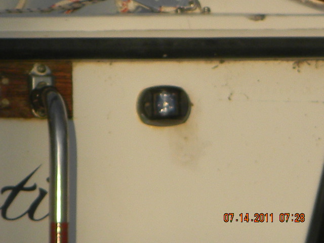

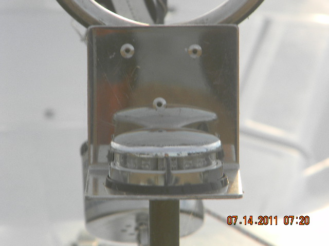

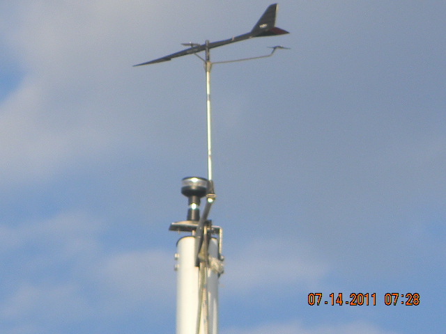

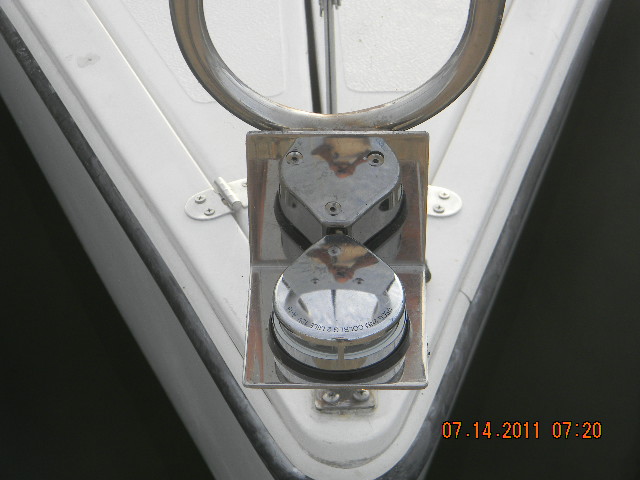

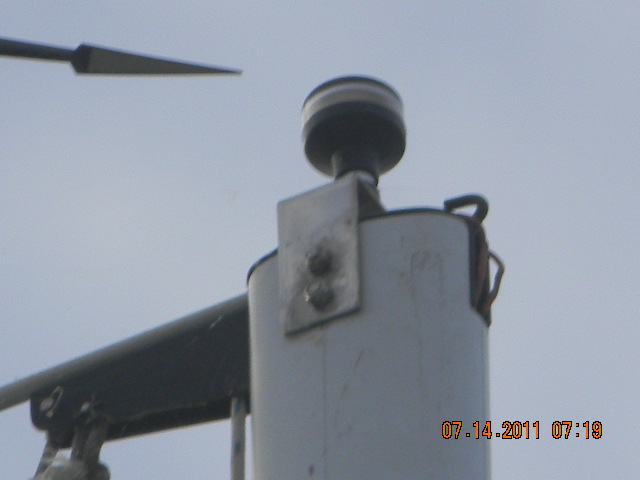

All these lights are USCG 2nm
Bow light is a SeaDog Combination
Anchor light is a SeaChoice 4"
Stern light is a AquaSignal
Bow light bracket is 4"x4"x4" 10 gauge polished stainless
Anchor light bracket is 4"x4"x2" 10 gauge polished stainless
Both are from Garhauer
The Bow light bracket is riveted with SS rivets
The Anchor light bracket is thru bolted
All new wiring in mast
I just replaced the festoon bulb in my steaming light as I only
have it on 5 min. entering and leaving the marina
