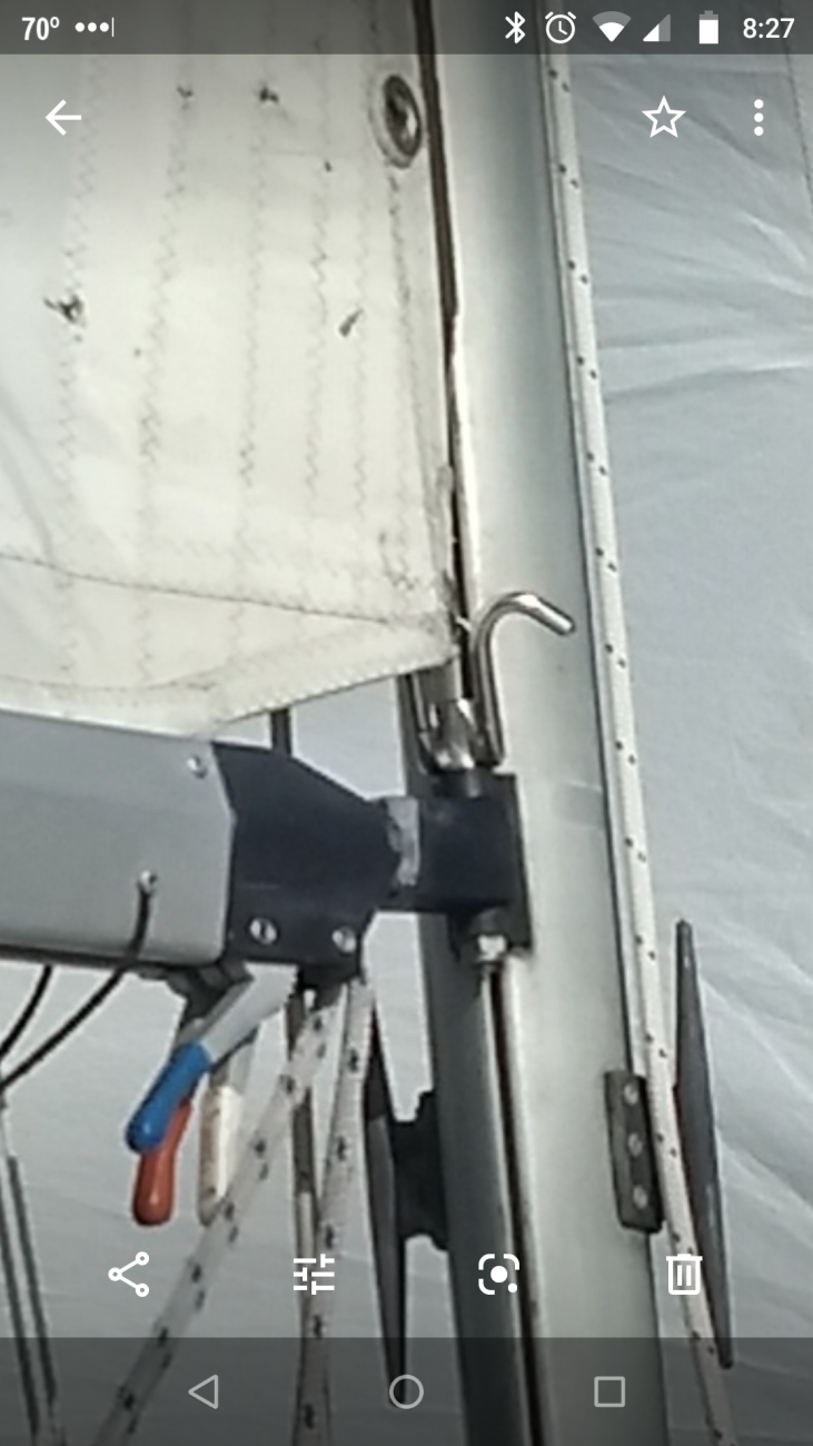

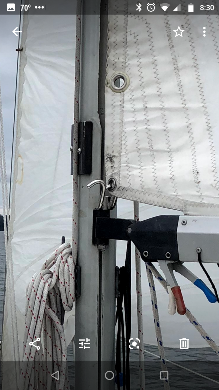

In P100D photo, the hook is used to hook into the grommet in the sail seen just above the boom in line with the reef points on the main.
booms and mast first came from Kenyon Isomat and parts can be gotten from Rig Rite as the forum store I believe cannot get them. The other mast came from Z Spar now US SPars. You can get parts from the forum store as they know what is needed unless you go direct. Suggest forum store.
