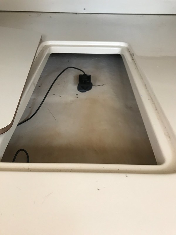

I was following an earlier post by Dave Congdon and still having no luck getting a reading. I chose a spot under the starboard rear berth bilge access sanded it to bare fiberglass about the size of half dollar. Did the water bag test and tried Vaseline on the transducer and nothing. I tested it by dropping it in the water and it's working fine. I had the bottom painted professionally over the winter, could that be the problem?

Sorry for this unfinished business. I did get the depth finder to work by placing it in the center opening under the rear berths. I still have issues with intermittent readings I believe I can resolve this by sanding some more and remounting it in more plumber's putty. Thanks for all your help!

the key when installing without a thru hull is to sand the gel coat off getting a smooth surface and then emersing the transducer into what you are attaching with like the plummers putty with Kermit boat, H 260. There was never balso core in the 23.5 and please do not reference that junk again on the 23.5

When I mounted my transducer to the inside of the hull I used the center aft bilge access, like others have mentioned. Ive had great performance in that location. I didnt do any sanding of the gel coat. I just used epoxy and let the epoxy set with a weight on the transducer so it made solid contact with the hull material. Im not sure why so many want to use a putty to attach these things. Its clearly inferior to epoxy. Its not like epoxy is some expensive and hard to use product. I highly recommend trying epoxy.
Side note: When I was testing locations the water bag test did not work here. But using petroleum jelly it did work.

The manufacturers instructions recommend the epoxy, I was nervous about the permanence, I will give it a try, Thanks for the advice,

Experience is the best and one thing by sanding the hull first off helps to give you more of a flat surface. As for the gel coat it too had air bubbles probably from the application of it in it. That was another reason. As for the location of the depth finder, well there is only one place in the water ballast boats and that generally is under the rear berth adjacent the bilge pump. Do not even think of drilling thru the ballast tank as that is the dumbest idea of all. As for attachment I have tried all and of course the best is thru hull but there are ways to get around it. As for application of attachment using epoxy, plumbers putty, 5200/4200, emmersion methods inside the hull and so on, I like the plumbers putty and it works. With anything though you have to make sure there are no air bubbles when attaching inside in the epoxy, plummbers putty and so forth. The use of epoxy I never even suggested. It is heck to get off first and what if you make a mistake and there are air bubbles between the transducer and hull? Not so good and cursing. That is why.
As for the water bag trick and you do get a reading, suggest placement there. I note petroleum jelly was used but when cleaning that up, you have to make sure all of that is cleaned up or adhesion will not take place. PS Plumbers putty was suggest by a member on the production line as to attachment many years ago but did not think that was viable. I was proven wrong by those who did use it.
