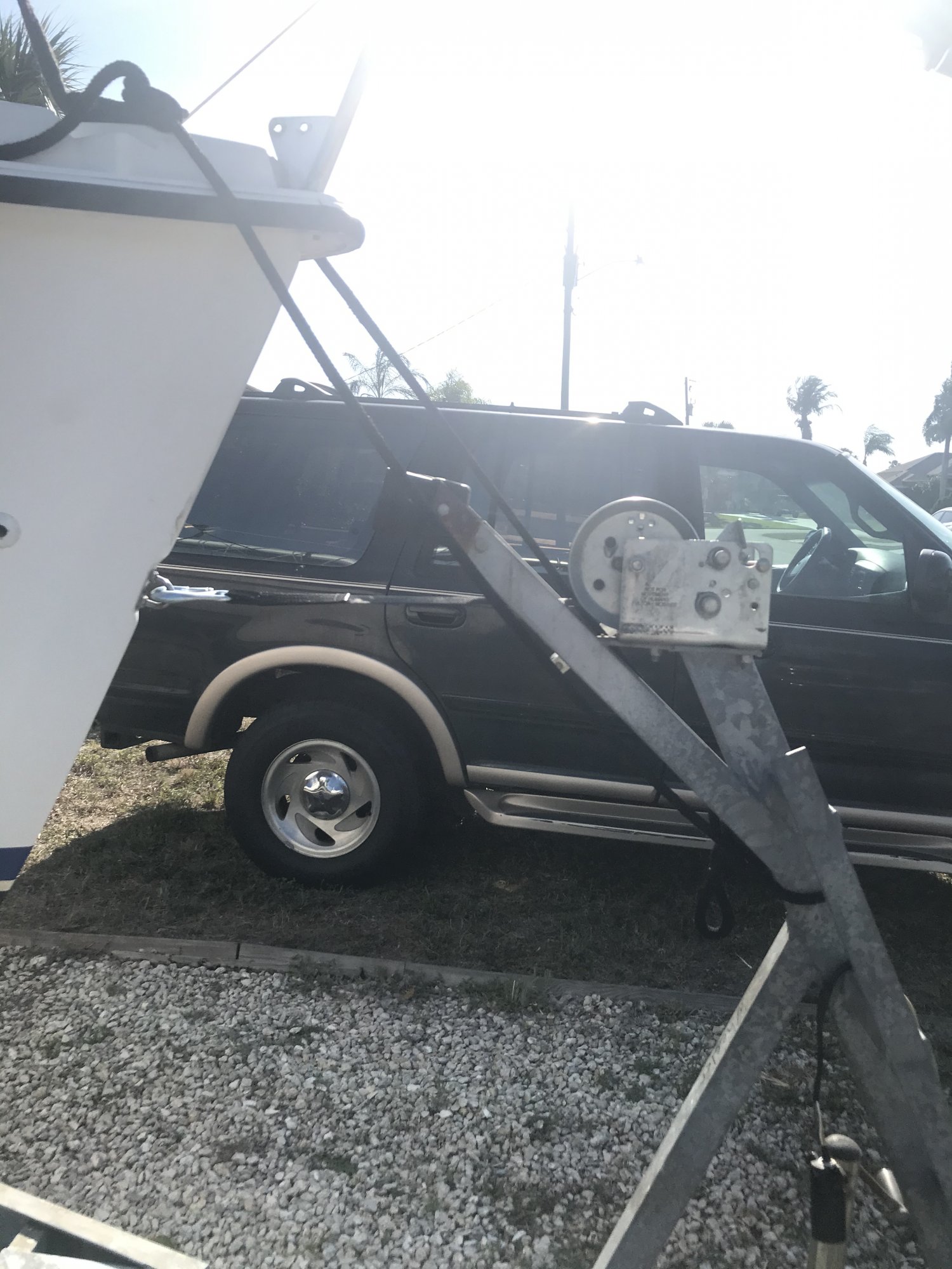

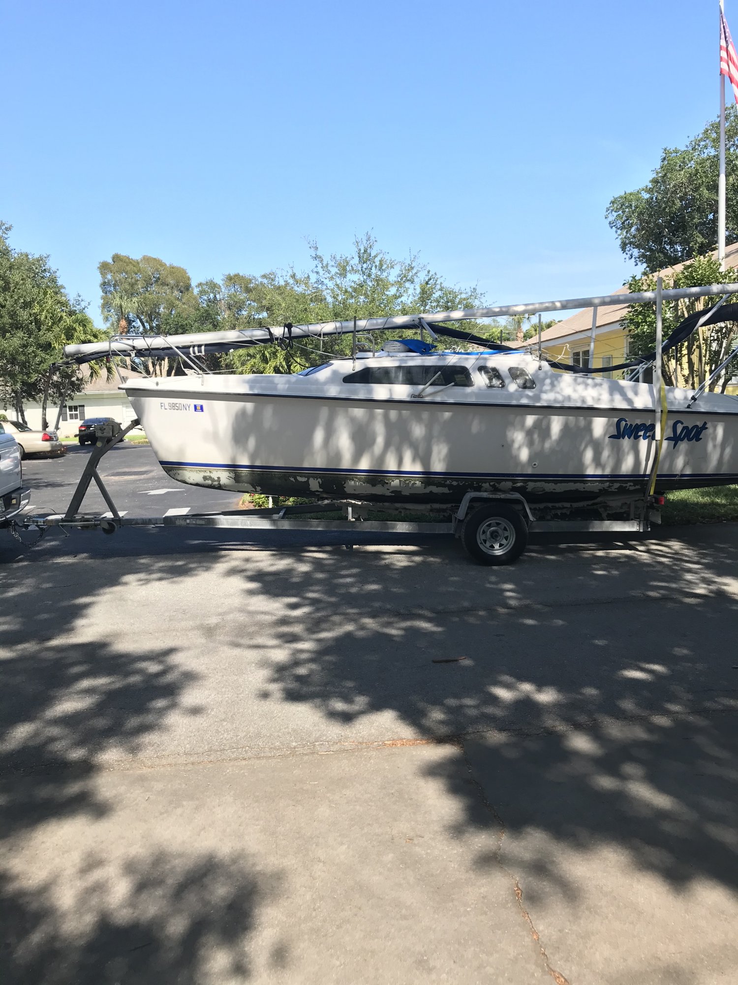

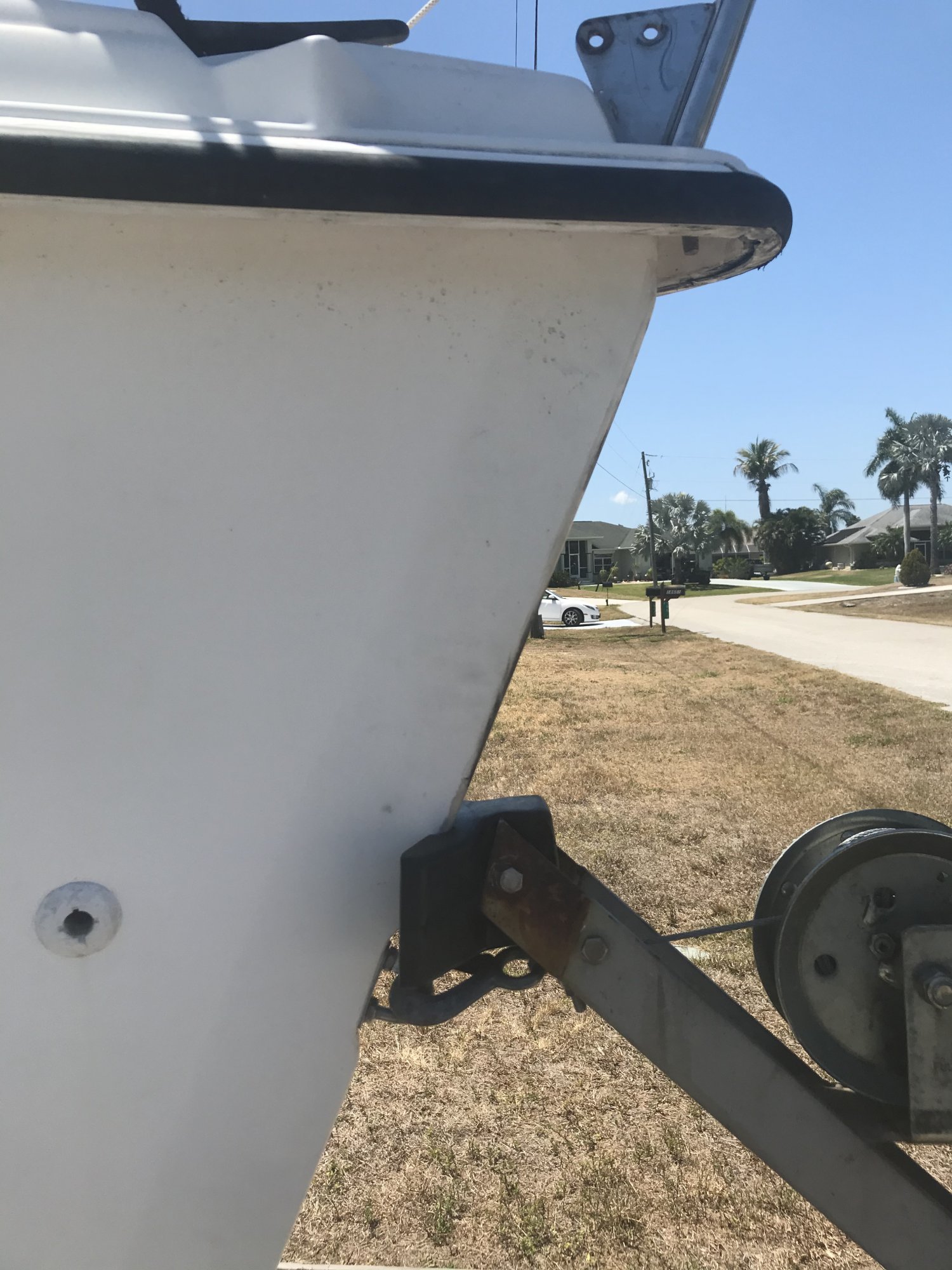

I have The original 1993 Hunter 23.5 boat and trailer and Hunter and serial number Stamped on the trailer. With the boat Bow eye I’ll be against the bow stop on the trailer, if I board the ladder at the stern of the boat the front of the trailer pops up ???? Obviously there’s no Tongue weight but why , There’s no room for adjustment ?? I’ve noticed another 23.5 hunters on trailers they have four bunk supports on each side I only have three. My bunks are 12 foot long 2 x 6s . Anybody come across this issue ?? Thanks joe

No movement, trailer stern strap, bow eye all the way up on the trailer bow stop . No gear or weight in the stern that can be removed . I like the trailer , just odd for the trailer to pop up while trying to board the stern ladder when not attached to the truck .and I’ve had had a lot of boat trailers over the past 45 yrs . I use jack stands and wood under the stern and raise the tongue jack til the stern touches the wood on the jack stands . But , you have to remember to remove the stands before raising the tongue to hitch to the truck , or to much pressure on the stern with the jack stands , that can spell disaster!!! I just bought the boat , going to replace the trailer bunks a couple of supports and all the bolts and nuts . It has a nice beefy new axle ,springs , hubs and tires/galvanized rims . Turnbuckle bent from previous owner (I replaced that ) and gin pole slight bend ( is that a problem ) ???? Not sure I like the t-ball mast stay wires ???? I’m used to mast tangs that I think are easy to inspect. Welcome to any opinions on this stay wire design. Like to inspect the swing keel rope , some way easy !!! Previous owner put 10 lbs of silicon around the windows !!!!! Ballast valve seal may need replacement, does the ballast tank stay full while under way with a bad seal ????? Where’s the fresh water tank 5 gals ) the hose is disconnected . Anybody step the mast after launched , difficult or not recommended????? Otherwise pretty sleek and spacious design. Joe

It really isn't unusual for a small boat on a single axle trailer to lift the tongue if you stand on the back of it.
The 23.5 weighs 2000# without the water ballast, according to sailboatdata.com, and I'm guessing the trailer might weigh 500-750#, so the tongue weight might be around 250-300# without accounting for any gear/outboard motor/etc.
Standing on the boarding ladder exerts pretty good leverage on the whole thing.
I don't think there is anything wrong here, you just need to be aware before you climb on board. No problem if you're currently hitched (assuming the bow is tied down, not just attached to the trailer winch). Otherwise, just put jack stands, blocks, whatever beneath the back end of the trailer frame before climbing aboard.
I used to have the same problem with my Catalina 22, and it weighed more than the Hunter 23.5. I haven't had that problem with my Hunter 26, but it is on a 2-axle trailer.

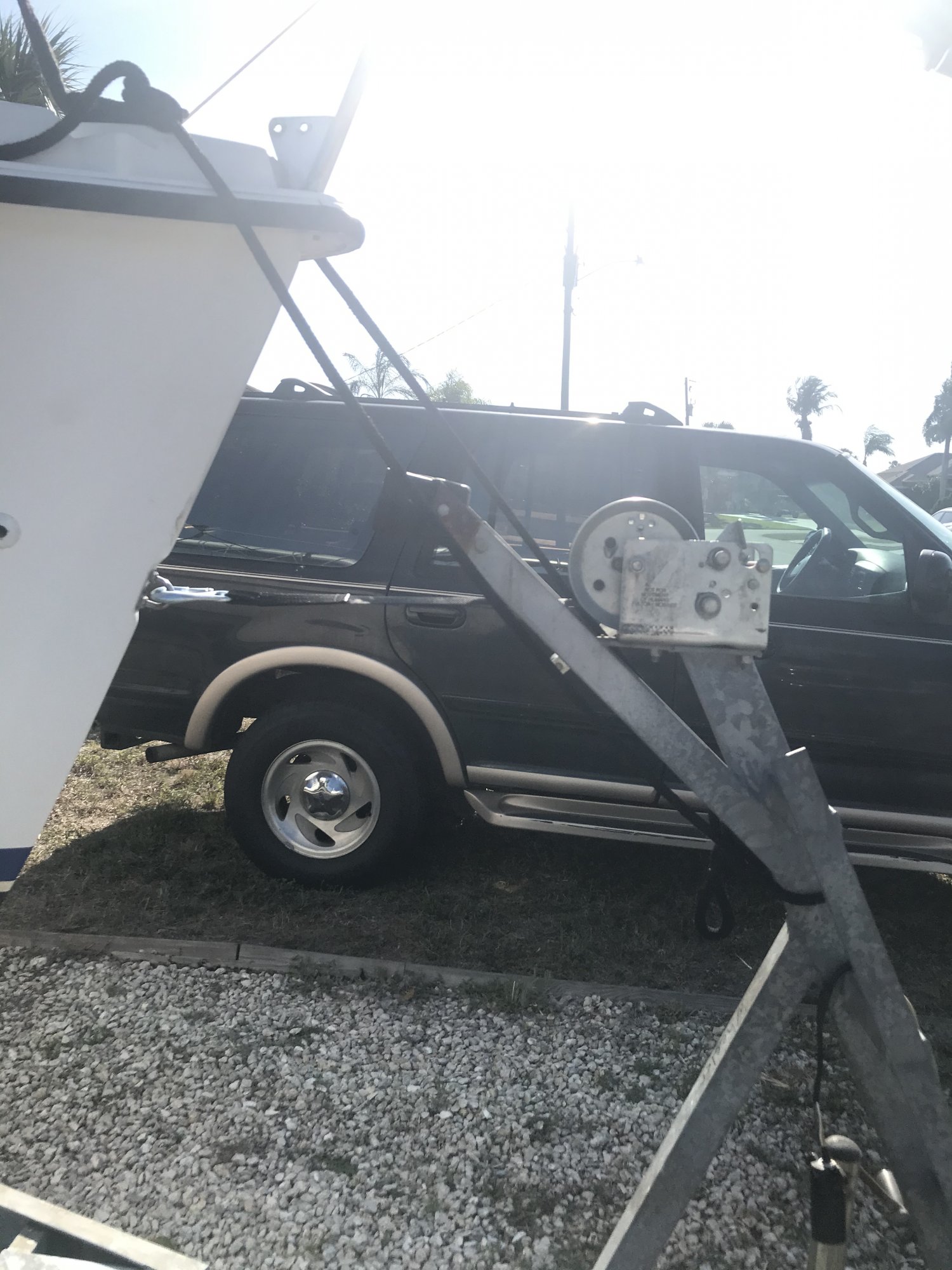

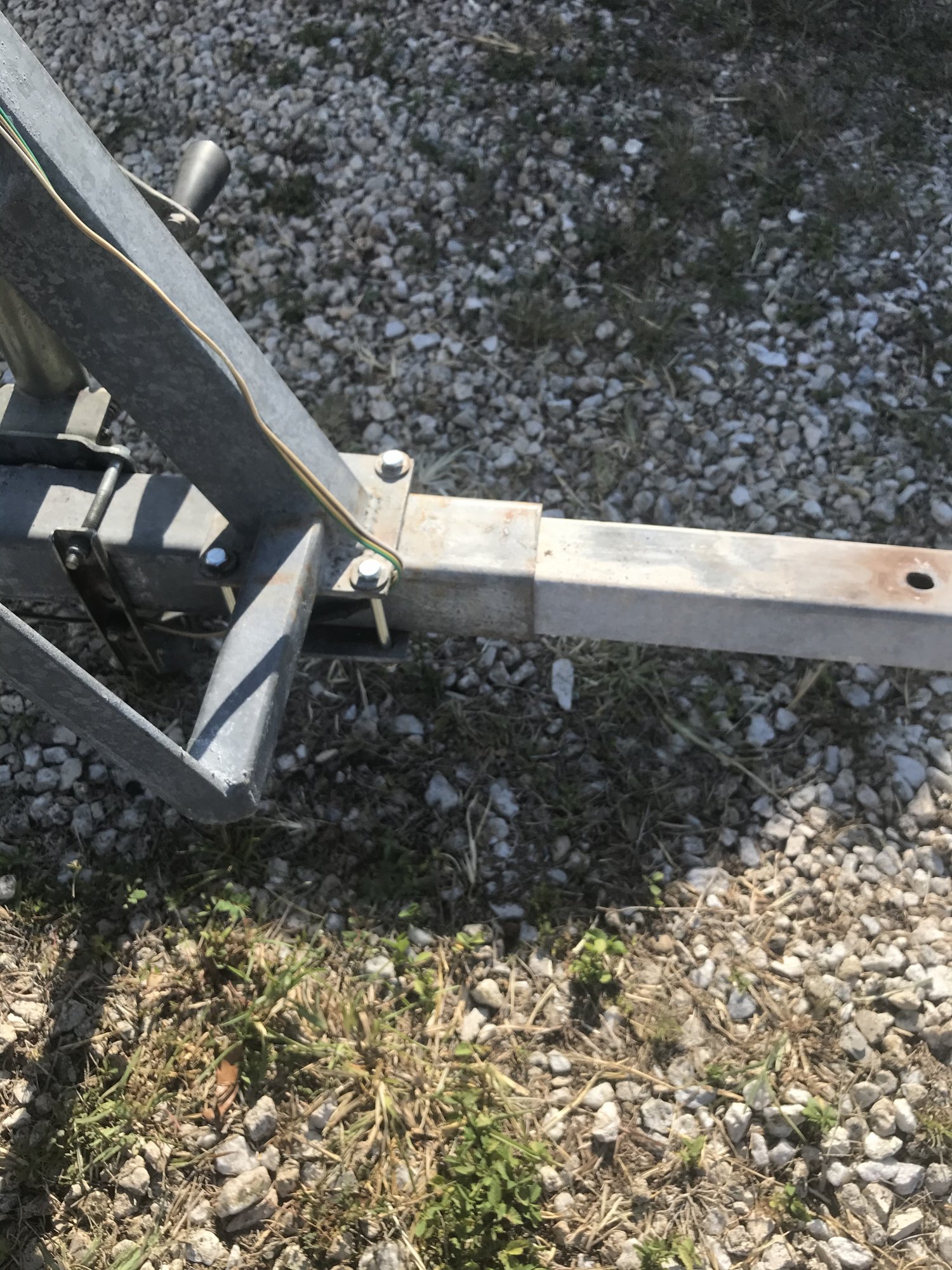

I going to move the winch support forward and maybe ad 6inches of square tubing that the tongue extension slides into

I launched the other day couldn’t get the bow up flush to trailer bow bumper . Going to slide the winch mount forward and maybe add 6 inches to trailer to slide the winch mount 6 more inches to the front . Not going to do the “ hunter bump “ .

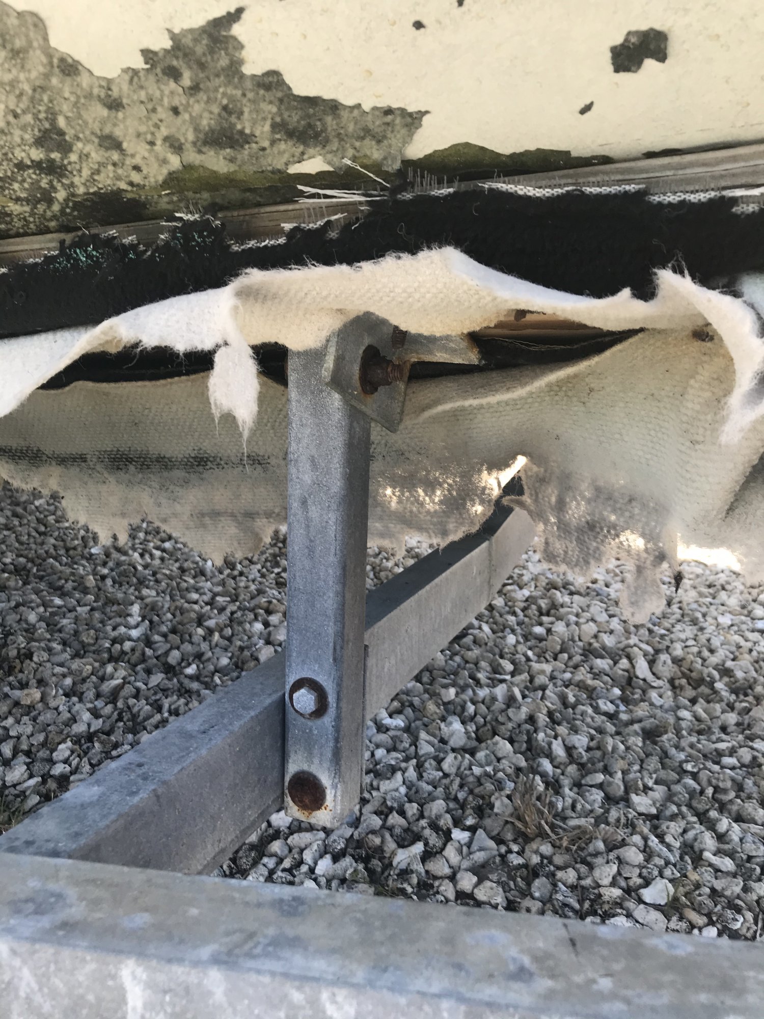

In one of the pictures, it looks like the boat is sitting on bare wood bunk boards. if that is true, you need to replace the Carpet. The boat will slide easier.
FYI, the originall plans came from me for the 23.5, designed the mast raise pole system, and was present when the trailer was being designed. l was a dealer who introduced that boat and sold quite a few.
As for the bunk supports, I cannot recall if you had three or four supports on each side for the bunk boards. Can you advise the year of the boat and manufacturer of the trailer. Again, is there any carpet on the bunk boards?
The boat dry wieght is 2000 pounds without motor and gear but displaces 3000 with the water ballast. The bunk boards carry the wieght of the boat on the trailer as it does not have a keel tray for that. you have a centerboard weighing about 100 t0 110 pounds that sits on a tray while on the trailer.
