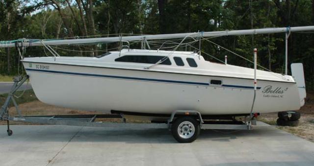

One of the reasons I chose the exact boat I bought was the Roller Furling that was already on it. I thought it would be nice to have. Unfortunately, I was really disappointed with it. I keep my boat on the trailer with the mast down and the jib when not in the water. The RF makes raising the mast more dangerous and difficult to raise due to the added weight. This is my 5th boat and 1st with a RF. When sailing, the RF is nice but the difficulty at the ramp makes it not worth it to me. I plan to buy a new forestay and jib for daysailing and use the RF for multi day trips.
If you keep your boat with the mast up and don't have to raise it each time, the RF is great but If you have to raise the mast each time, I'd forget about a RF ...just one guys opinion.
