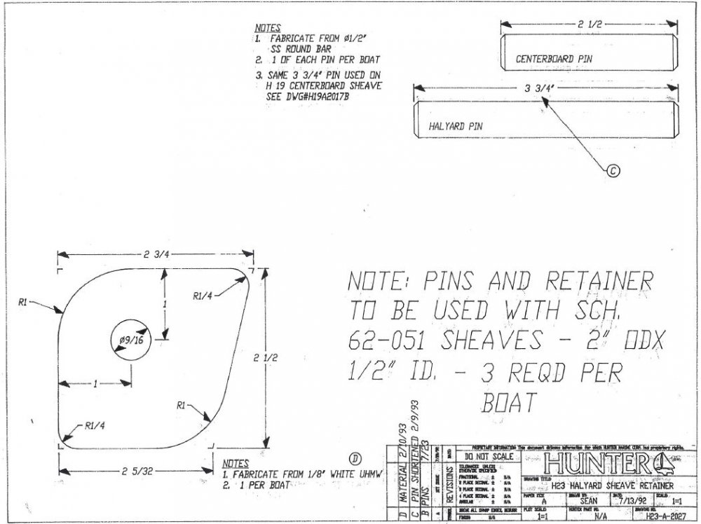

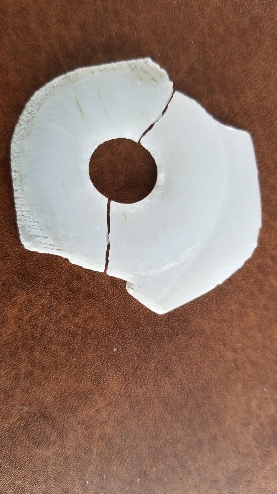

The photo shows the broken spacer. I have none at all now and the main halyard binds between the sheaves. I don't know if there was originally one or two or three of these, but now they're all gone. I'm wondering how many should there be, and what is the shape of the corners that are broken off? I think a close up photo of spacers in place will be enough to answer the question?

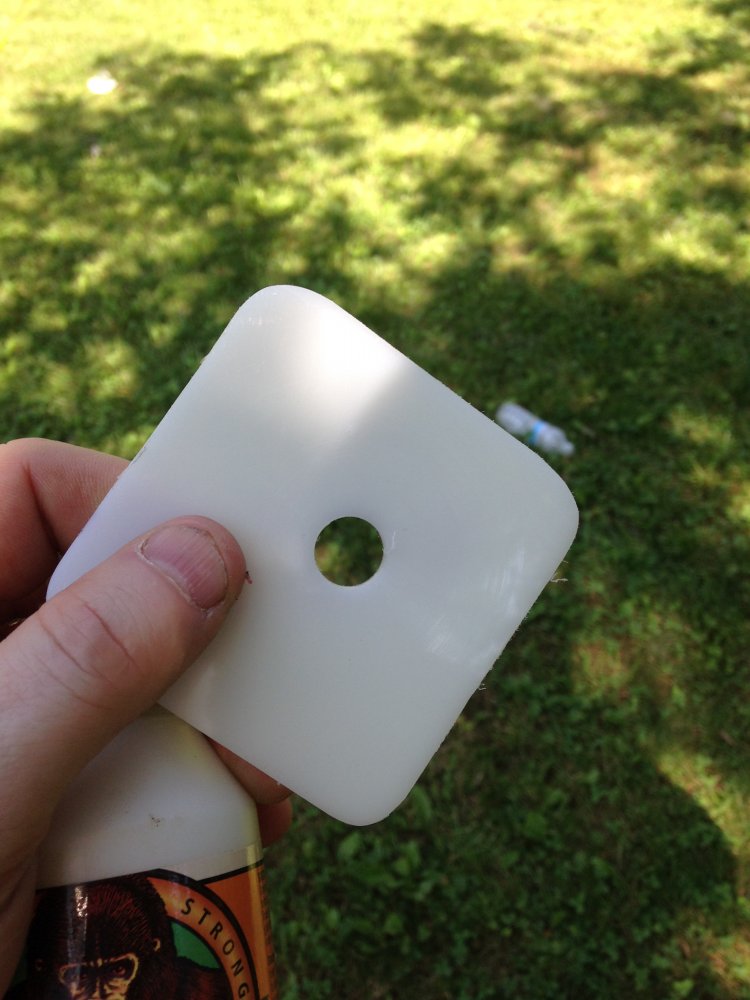

I bought a cheap Dollar General white plastic patio end table that goes with the while plastic stackable chairs.I paid about $8 for it. From the flat table top surface I traced and cut out 4 sheeve separators and then cut away the rest of the flat surface from the scrap for future use. The first separator has lasted me about 5 years and finally cracked after I accidentally stepped on it. BrianW

Thanks Scotty! The manual for my H23.5 doesn't have that diagram. I remember it was slightly odd shaped, not that it's too critical.
