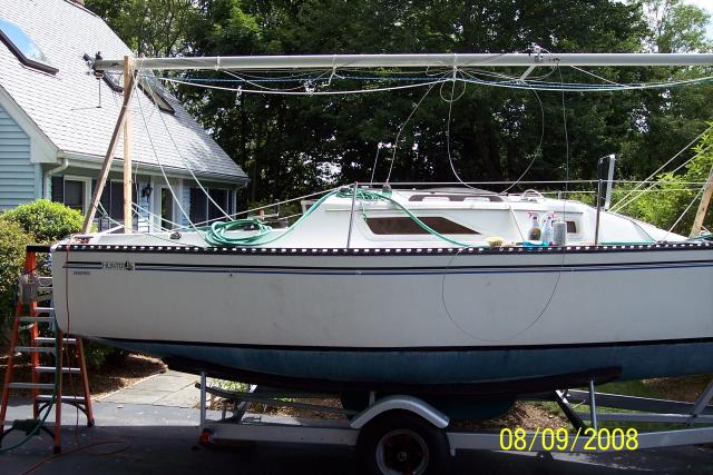

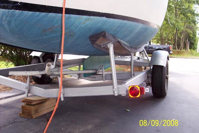

Well mine is a swing keel... bunks are 2"x6"x12', 5' apart aft, 2'2" apart fwd, 18" off the trailer aft, 12" off the trailer fwd ... with accordingly hull shape in between, supported at 6 locations (3 aside), plus a keel roller fwd.
Still working on finding the pictures on disk ... our weather will clear in CT this weekend, affording the opportunity to snap some fresh ones, if needed.
