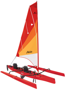

I understand the thrill of the go-fast boat. I have a hobie 16 in addition to a few other toys. I also have a crush on these...
There is a LOT of beautiful salt marsh where I live now and one of these (with a paddle as back up) would be a lot of fun and open up a lot of "private" beaches to explore.
