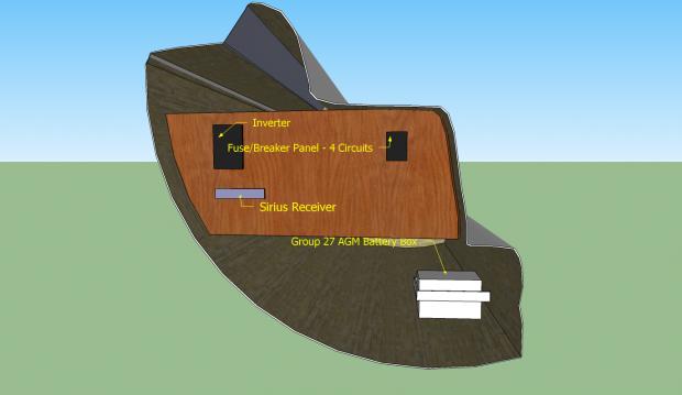

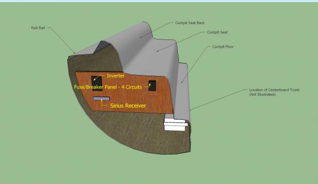

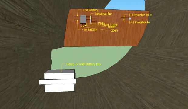

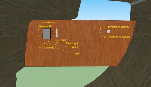

Sketch Up
Hey guys, I spent some time last night sketching up my plans. Although I'm targeting the port side, I went ahead and sketched out the starboard side - (it was easier to draw for some reason). There are 4 jpgs attached, each showing a different perspective. This is a rough model and it is not to size or scale.
Notes:
- I am considering having a stainless bracket (much like the hatch board bracket) fabricated to hold the battery box in place. I will screw (or rivet) the bracket to the trunk. I am waiting for Hunter's response on whether this is doable in the trunk material or not
- I am not sure if the battery box and battery will fit under the cockpit floor hangover until I measure and test it
- The panel components are much closer together than portrayed
- The panel is mounted using heavy duty liquid nails and "L" brackets for support while setting up
- The cable runs are not illustrated but will have support every 11 inches using plastic eyes screwed in with small screws and fabric ties with velcro to ease the pain of taking the mast down and disconnecting applicable wiring
* I used Google Sketchup for the first time last night so the sketching was a learning experience...

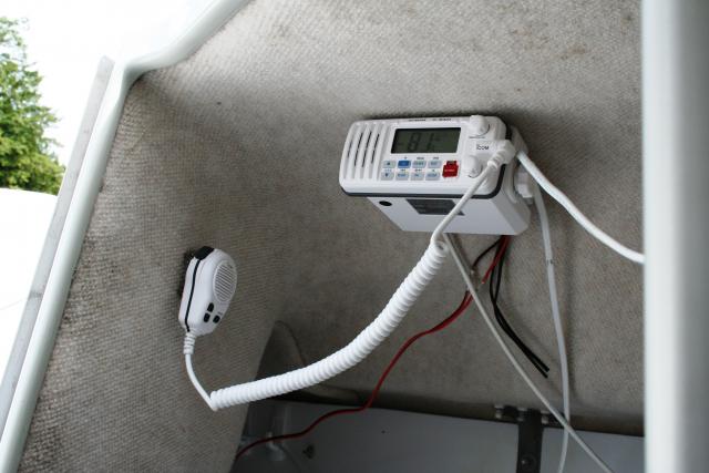

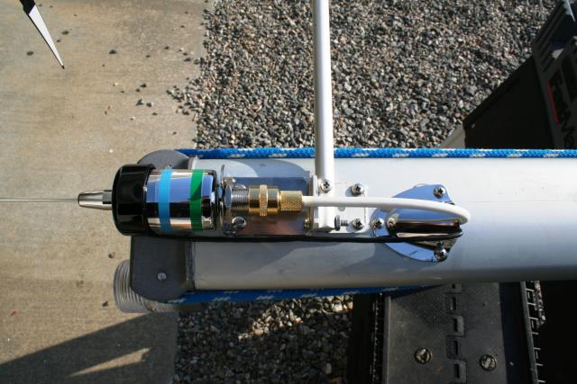

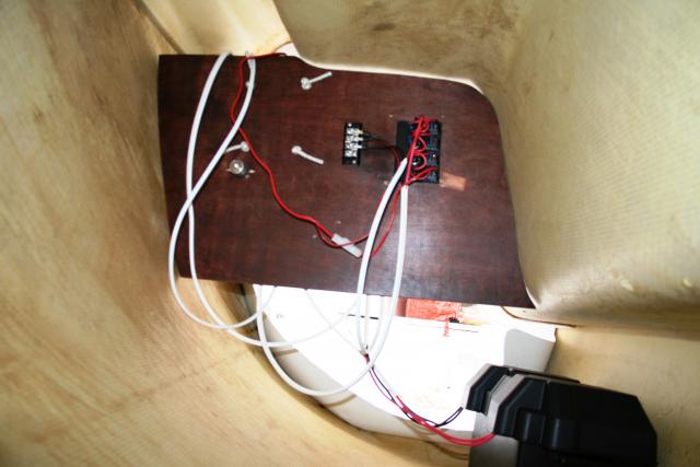

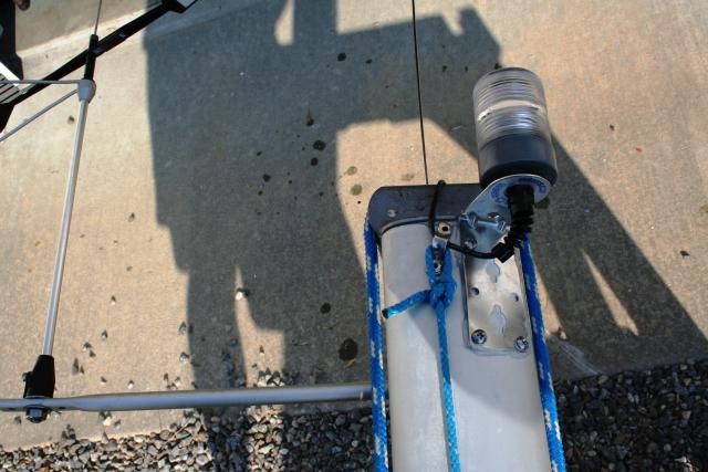

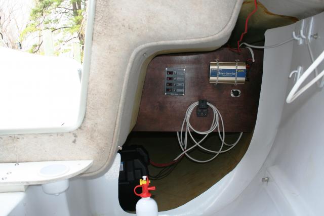

I will be adding this information to the 216 improvements area once 100% complete. This weekend we created and fit the bulkhead in place, modified the mast head, mounted items to the bulkhead, mounted the radio, and wired up the system. Because the mast is raised temporarily until I get some additional sunbrella added to jib (created by Jerry Latell in DVL last year), we have to take the mast down again to re-attach the jib. As of now the cable runs are not secured and the bulkhead is not secured. Next phase is to build up some mounting blocks with epoxy to attach the bulkhead as well as secure the battery.
Initial tests are positive. The VHF was receiving transmissions from ~25 miles away from the back of the creek surrounded by trees. Transmission were received clearly from some folks a few miles south. The inverter was powered and everything was sound.
So here are a few pics of the in progress installation. Please ignore the messy cables - they are only temporarily hung to keep them off the bottom of the hull while she is safely secured at dock.

Nice job Paul. Include photos of the mast base connections for your modifications article.
