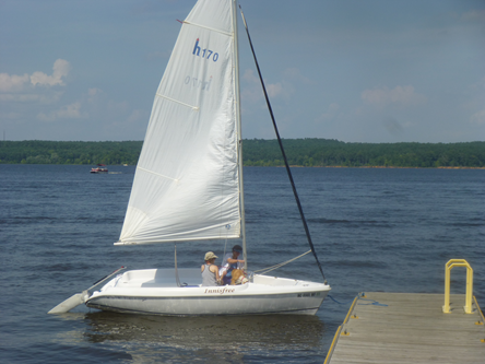

We purchased our H170 (used) and sailed it for about 8 years, mostly on Falls lake near Raleigh NC. We did the usual maintenance (replaced both sails when they wore out, etc), and we also became quite expert in repair of the ACP plastic hull. Cracking of the plastic hull is legendary on these boats. Living in NC the boat was not exposed to extreme cold temperatures, but did suffer from some minor (non-structural) cracks in the deck and forward interior surfaces. Pretty much every year we would go around and fix new cracks that showed up (always on the inside, the outer hull never showed any cracks).
It also suffered from delamination of the plastic from the structural foam under the deck resulting in flexing of the deck (a “soft” feel when walking on it). That flexing eventually causes more cracks along the edges of the walkway, especially near the center of the boat. We undertook to cut holes in the deck and inject 2-part structural foam into the voids. It was a lot of messy work, but it gave us several more years with a good firm deck.
We were content to continue repairing the ACP problems indefinitely, until we bought a house at the NC coast and wanted to sail the waterways around the barrier islands. Due to the shallow waters and channels it became essential have a motor on the boat, but the motor mount suffered from the same delamination issues as the rest of the deck and was not secure enough to support a motor. There are other discussion threads here from owners that have torn out and rebuilt the motor mount deck area, but we decided we had spent enough time on repairs and it was time to sell the H170 and buy another boat more suitable for our new sailing environment.
We really loved the H170, our kids (and dog) spent many years on it, and the open transom design was so great for dropping anchor and taking a swim on a hot day. So it was natural we would take a look at the H18 and see if it would make a good replacement since it was about the same size and similar design. It was very hard to find a used H18 (and cost of a new one was out of our price range). I spent a long time scouring the internet, finally finding one at a NY yacht sales yard. We had only a few photos to make a decision, but since the seller was a certified and reputable boat dealer, we took a chance and bought it without laying eyes on it. We had it transported to NC (uship.com) for about $800.

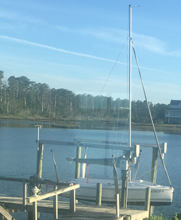

It did not take long to realize the H18 we bought was a “hybrid” combination of a H170 and H18. It has been discussed here and other places that Hunter replaced some of the cracked H170 hulls with H18 hulls to satisfy disgruntled customers. But the replacement hulls were fitted with the old H170 sails. This H18 had an H170 serial number, H170 sails, and a mixed bag of rigging. The Seldon mast was from the H18 design, but the boom and sails were H170 – which meant they were smaller than the sails designed for the boat. The boat was a bit of a mess with rigging that just did not work.
After consulting with the folks here at hunter.sailboatowners.com, we decided we wanted a properly rigged and outfitted H18 so we bit the money bullet and bought a new boom, main sail, spreaders, jib furler, and standing rigging. Turns out the mast had been modified a bit so we could not use the H18 spreaders and standing rigging, so we had to make do with what we had.
In the end, we have almost a normally fitted H18. We sold the H170 and have been sailing the H18 for 2 years now, including in the NC coastal waters.

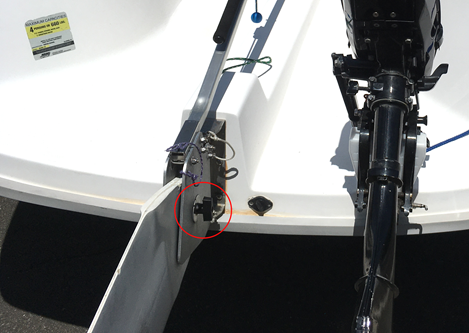

Rudder clamp
OK, I cannot really figure this one out. The H18 rudder has a screw clamp in addition to the 2 pull ropes for raising and lowering the rudder. The pull ropes did not work all that well on the H170, and they are no better on the H18. It takes a lot of force to raise the rudder out of the water, and the rope is under so much tension in the jam cleat it can be almost impossible to release. I really dislike this method of raising and lowering the rudder (on both boats), I wish Hunter had come up with a better design.
But what is the purpose of this clamping knob on the H18? It is impossible to tighten enough to hold the rudder up, and there is already the rope system for that. It is also tricky to get to on the water because you have to lean way out the back to get a grip on the clamp handles (there is one on each side). If anyone knows what this is for, I would like to know… (and no, the user manual does not show it or mention it).

Rudder Pivot Bolt - Quick way to take rudder to side plate play out even while sailing. While this is pretty much a set and forget adjustment speaking from experience do take it apart occasionally and spray lube on where the bolt and nut meet the aluminum plate. Let it go to long and the Al. corrosion will freeze things up to where the plastic handles will deform around the nut when trying to loosen and become useless.

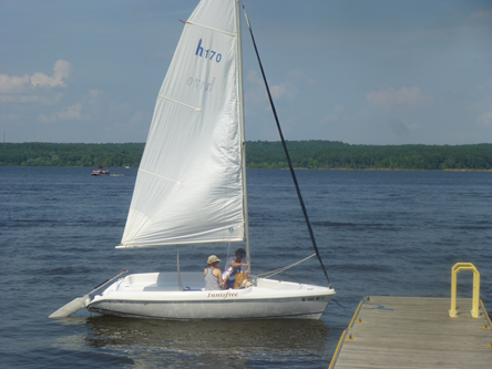

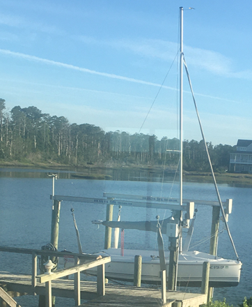

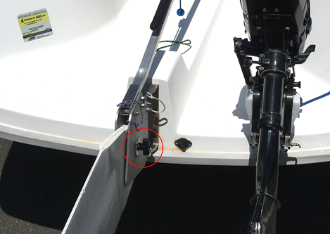

Rudder clamp
