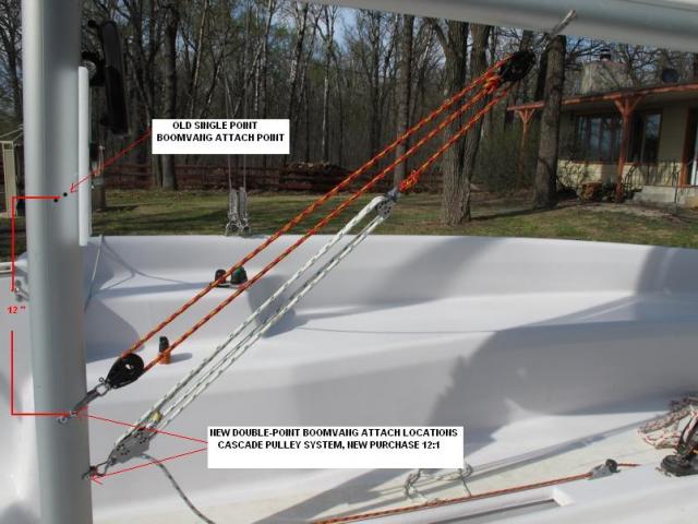

So I finally got around to taking few pictures of the boom modification I did this spring. First thing I did is lowering the boom attachment point by about 14" - so far so good. Everything works as it did before. I haven't had the boat out yet on any windy days but I can notice the difference in the heeling angle already. Also despite being a 6'1" guy I still have plenty of room underneath the boom without having to do any acrobatics while tacking.
Another thing that needed changing was the original boom vang setup. Two things that always bothered me about it were insuffucient purchase on the original blocks and the awkward angle at which the line was being operated.
After moving the boom down I had to shift the attach point for the vang as well. I dropped it 12" plus I added another mounting eye on the mast for an additional set of pulleys. All in all I used the existing boom vang rigging in conjunction with two more Harken small blocks to make up a new cascade vang system.
Two things I noticed right away about the new vang set up. For one its far easier to operate with increased 12:1 purchase - hardly any strain is required to get the needed tension. Another thing is the changed angle of the control line, its much easier to jam and un-jam the line from my sitting position in the back.
Last little thing I added was small pole for going wing on wing with the jib poled out. Works like a charm without having to fight with the spinnaker.
See the attached pictures.

By the look of those pictures the boom seems to be in the same spot as before. I think the marketing dept. at Hunter wanted to keep this boat as 'safe' as possible by avoiding having people wacked over the head with flying boom.
So far the modification I made on my setup has been working great. I was out last week on a gusty day and there's a noticable difference in the heeling angle. Biggest difference is in the way my boat responds to wind gusts, I have more time to get things under control before she starts heeling too far over. In the end I still have tons of room under the boom.
