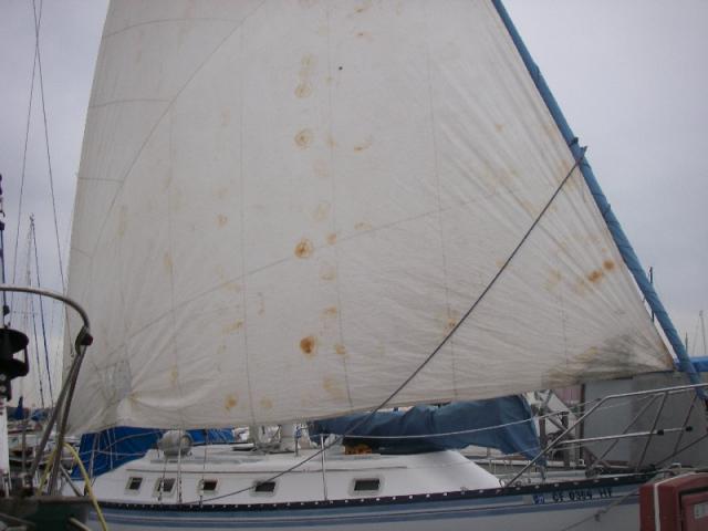

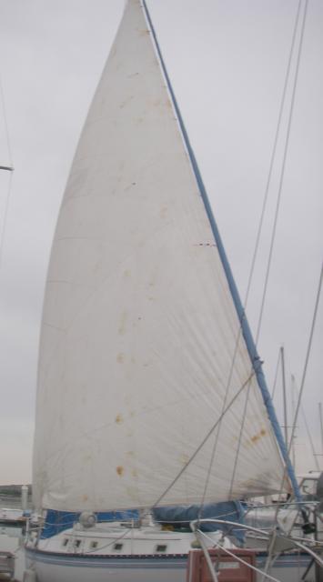

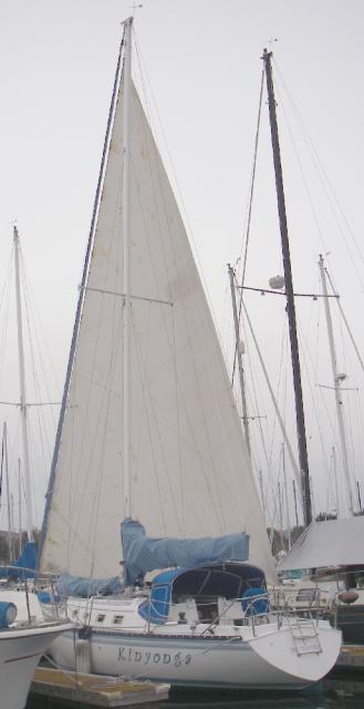

I was given a genoa that is pretty beat up but still usable as shown in the picturs.
The clew comes to within about 2 feet of the jib winches. One winters day when there was light wind in San Francisco Bay we raised it and were amazed at how well we could sail, with and without the main. Balance seems to be no problem at all and although the currents make it hard to judge we seemed to be able to make 5+ knots upwind in about 4 knots of true wind.
Tacking is another issue. I figured I would have to help it around the staysail stay but that big old light soft genoa would'nt even go around the mast or lowers without me going forward to help it.
We really liked the way it performed and based on that have invested a few bucks and some labor on repairs so we have it for those days when you just could'nt otherwise sail.
BTW - I have been questioned as to whether the winches can hanle it and the answer is yes - it is the forces it generates, not the size of the sail that is the issue.
