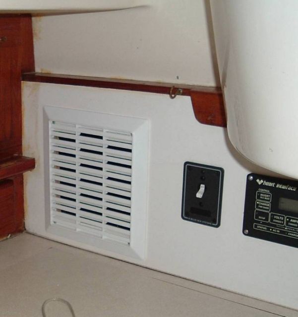

Midnight Sun has had Adler-Barbour systems since they were invented. The first units using R 12 would make ice in a half hour. The new ones aren't as efficient but still work well. They last a long time. I have never had one die of natural causes. Usually power surges, (one was killed in a lightning strike) or low voltage. In our boats, the key is to insulate the entire top of the ice box, not just the lid. I also sealed the cockpit loading lid. The compressor unit is mounted on top of it.

Like many I also have an Adler-Barbour unit. And I sealed the lid in the starboard locker after insulating the inside-top. Also insulated the top and lid inside the boat. It uses two to three amps an hour once it is cold. I mounted the compressor so that it draws air from the interior. Instead of running wire to the panel I added a breaker right over the ice box and take the 12 volts from near the batteries.
