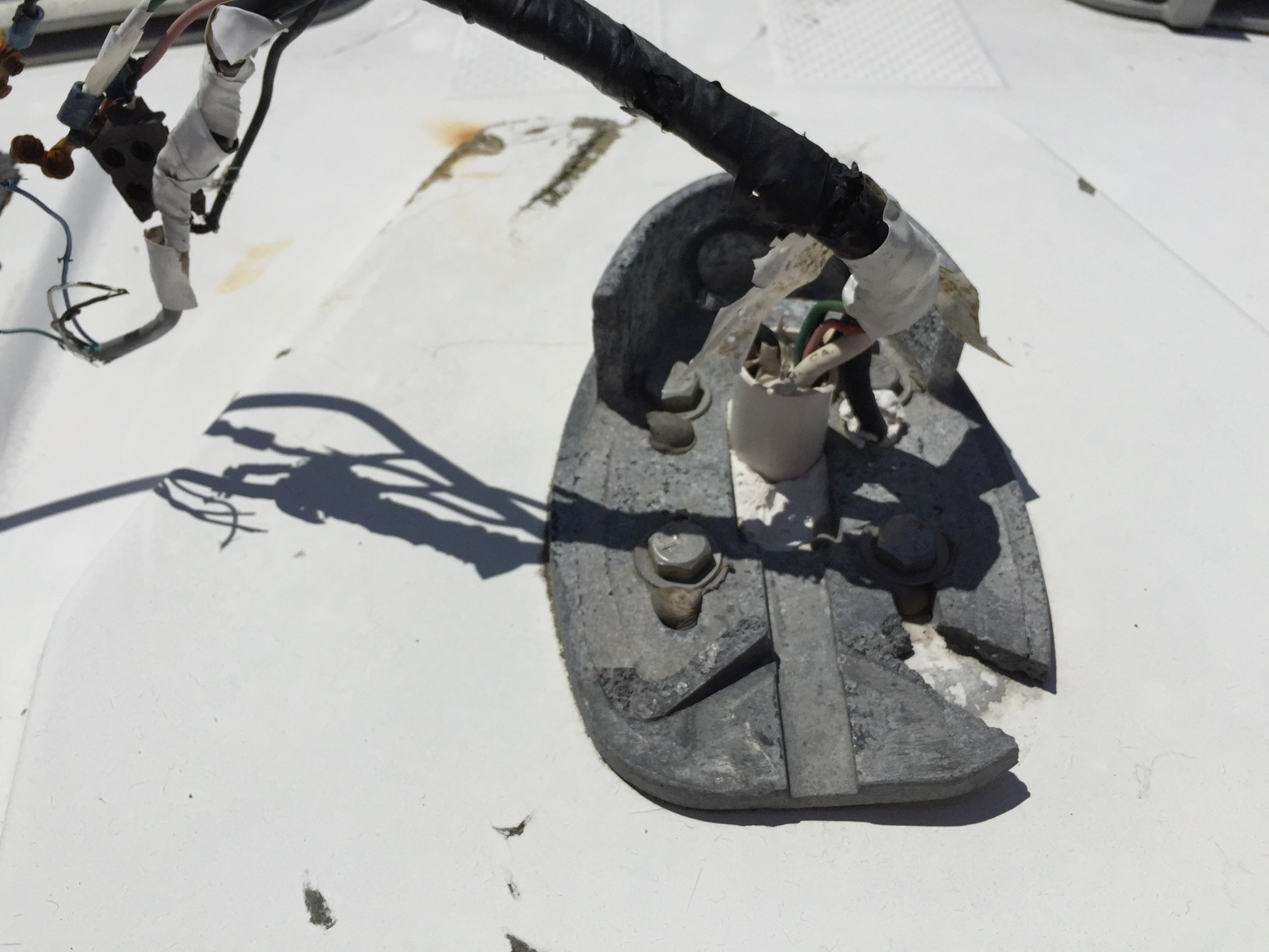

help! My 1984 h 34 mast foot was damaged when mast was removed! The bolts securing the foot to the deck / post are they machine bolts and can I unscrew them without removing the wood surrounding the beam inside? Or are they lag screws? What am I up against here when trying to remove the foot? Tx CR
10,257
Those are machine bolts that are threaded into an aluminum plate which is embedded in the fiberglass. That plate is almost as big as the raised area under the mast. You can unscrew the bolts to remove the step. You may need an impact driver to release them.. the stainless bolts and the aluminum plate will sometimes freeze together..

I don't remember what the foot looks like on my other h34 but based on my picture here how much of the step was lost in the bad de maskting job?

Hi, I got the foot off easily only the bolts were packed with 4200. I need a pic of a complete foot like mine for the machines to copy the height of the legs and etc. any help here would be greatly appreciated. Tx CR
