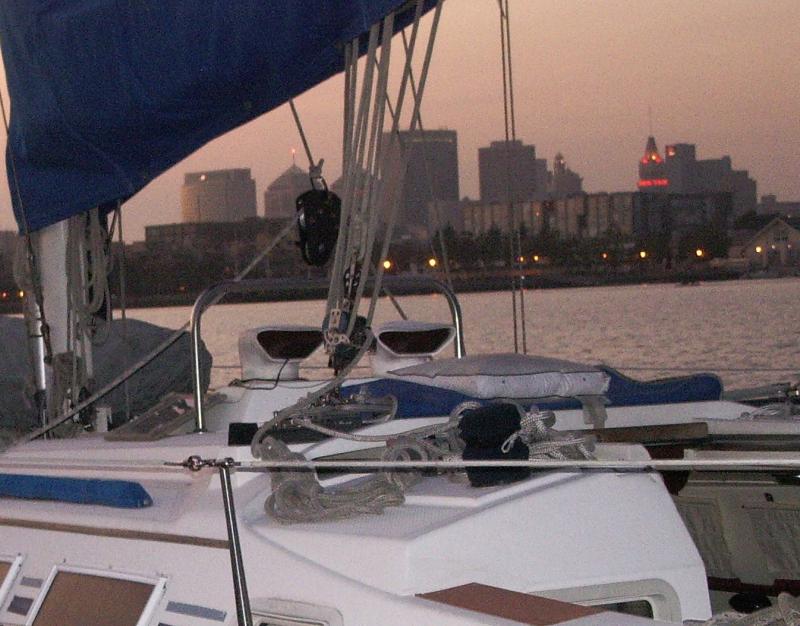

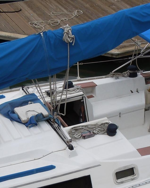

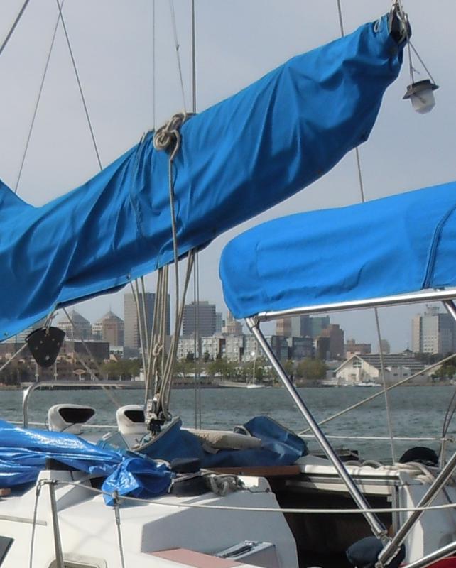

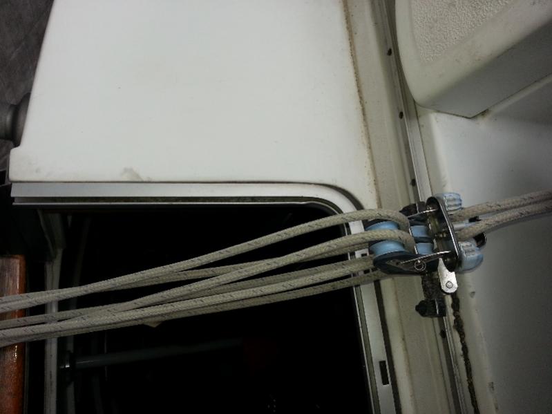

I felt the same way with our setup when we first bought our new H34 in 1985. It took forever to grind that mainsheet in when heading up using that non self tailing winch. Within a year we changed it so we could sheet it in like a big dinghy. No winch required. Of course we still don't have a dodger so it allows for rigging it this way. If you can tell from the pictures I attached a triple block with becket and cam to the traveler car, then one more block and becket on top of that. I continued to use the three bales on the underside of the boom and created somewhere around 8 to 1 purchase. I have never had trouble sheeting in even on the windiest day out in the bay, or the slot. Like I said, its just a 34 foot dinghy.
Good luck in your research.
Allan

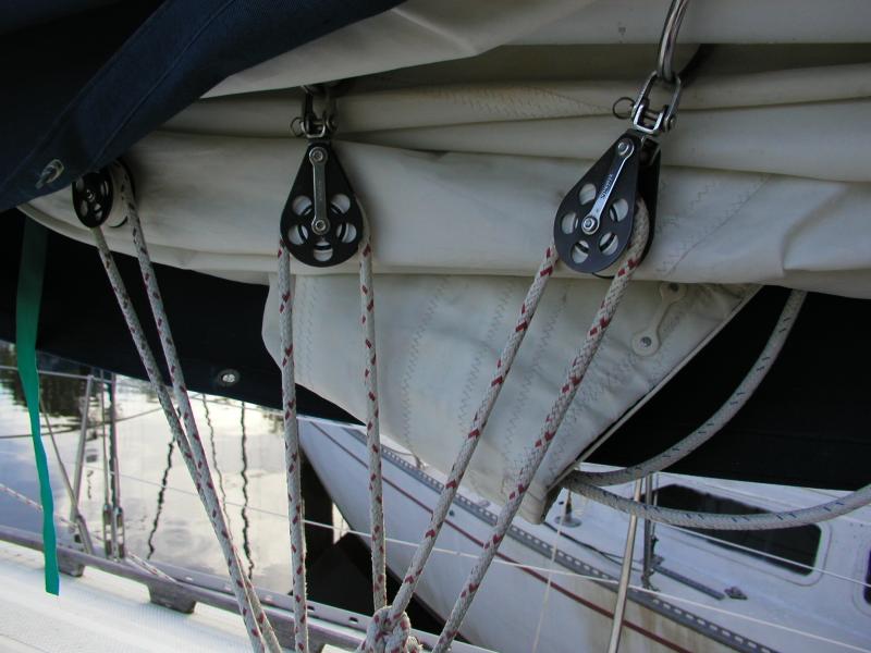

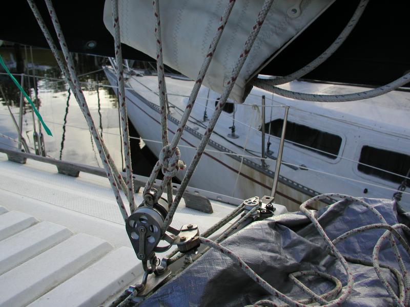

I pretty much have the same thing as Allan.. Previous owner had raced a bit and had already fixed it. Mine is 6:1 and no winch is needed. More of a tug than an 8:1, but not bad. Triple block and becket on the bottom with a cam cleat; original bales on boom.

Allan and Claude, Thanks a million. That is exactly what I was looking for. I am very happy to know that it is doable without the winch. One question: do y'all solo sail? Is it easy enough to manage it?
10,202
I do solo occasionally. Ya have to get around/forward of the wheel to set the sheet, so a good autopilot is really nice to have. It can be done easily using the wheel lock but the autopilot keeps her going straight while you go below for that beer .. heck ya had to do all that work trimming.. might as well reward yourself now that you are forward of the wheel !

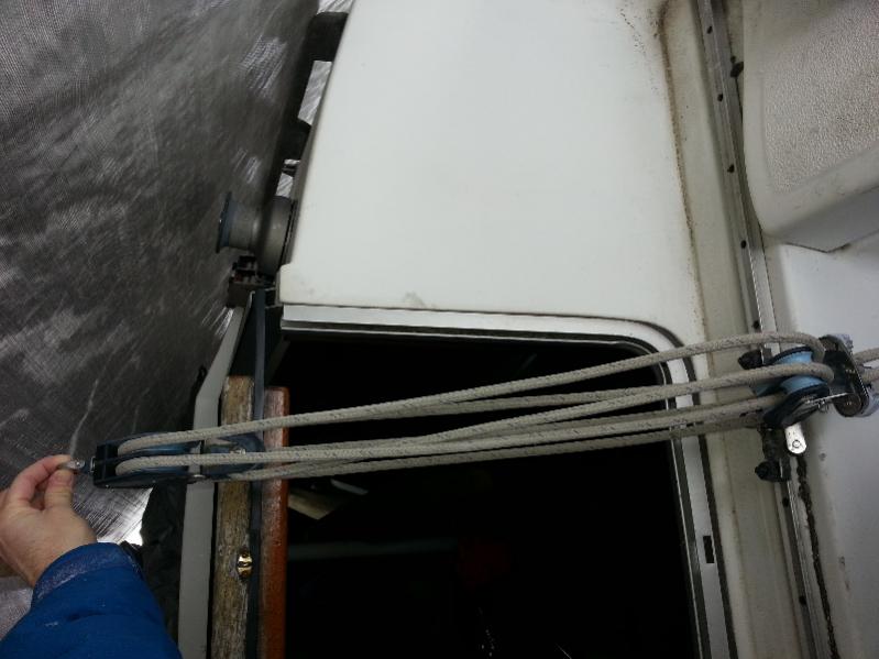

Sorry for the delay, weather and life were conspiring against me...
... I'm holding the boom end as the boom is stored for the winter. Pretend my hand is a single bail, mid-boom. :-D
You can see the 2-speed detail at the bottom in the second pic (where it attaches to the traveller). Pull one line for high power/ low speed, or both ends for low power/high speed.
