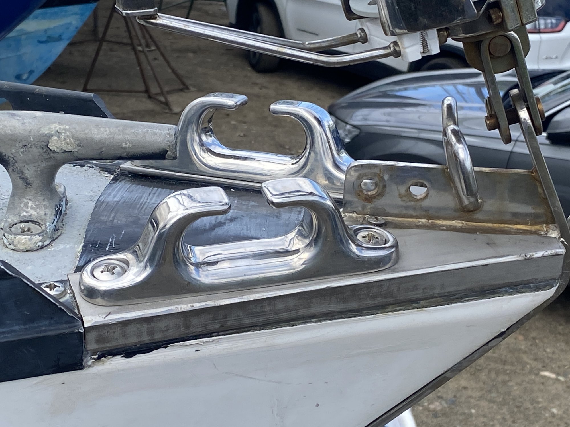

The Plate at the bow of our Hunter 33 has broken and despite a number of repair attempts,
Continued to get destroyed by mooring lines during heavy weather so...
Here's my "GO BIG or GO HOME" solution. 3/16" thick stainless steel angle stock cut to size.
Epoxied in place and thru bolted with the chocks.
Maybe this can be of help to someone in a similar situation.
