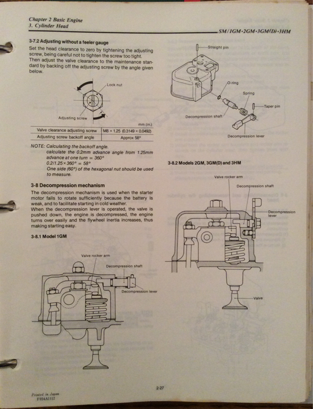

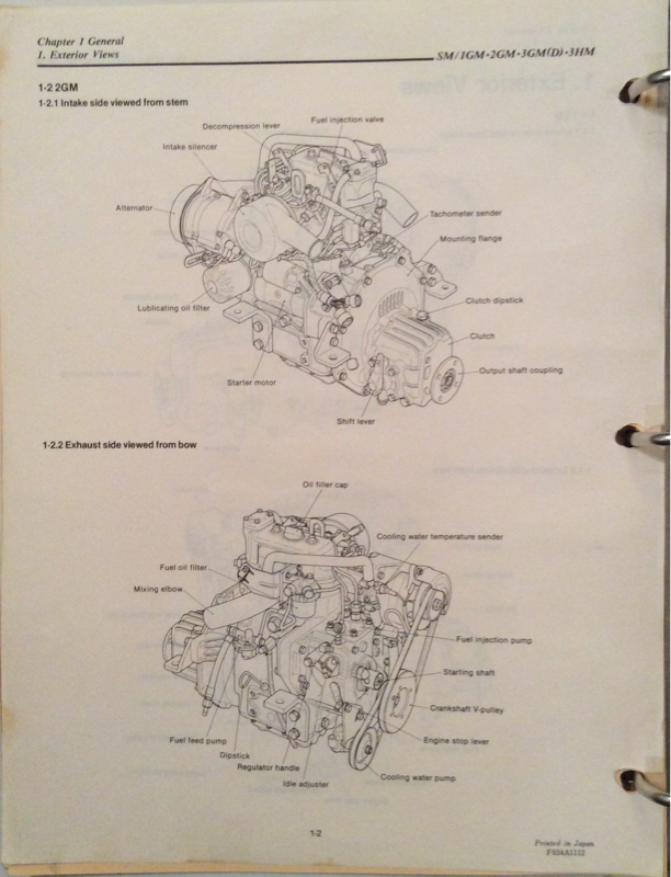

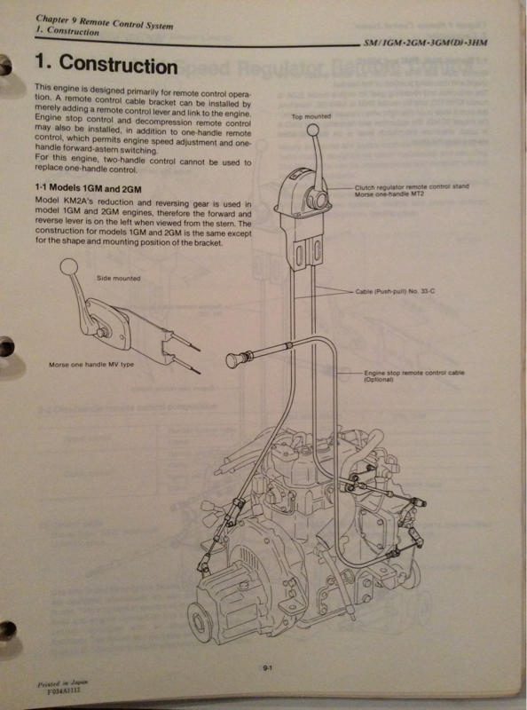

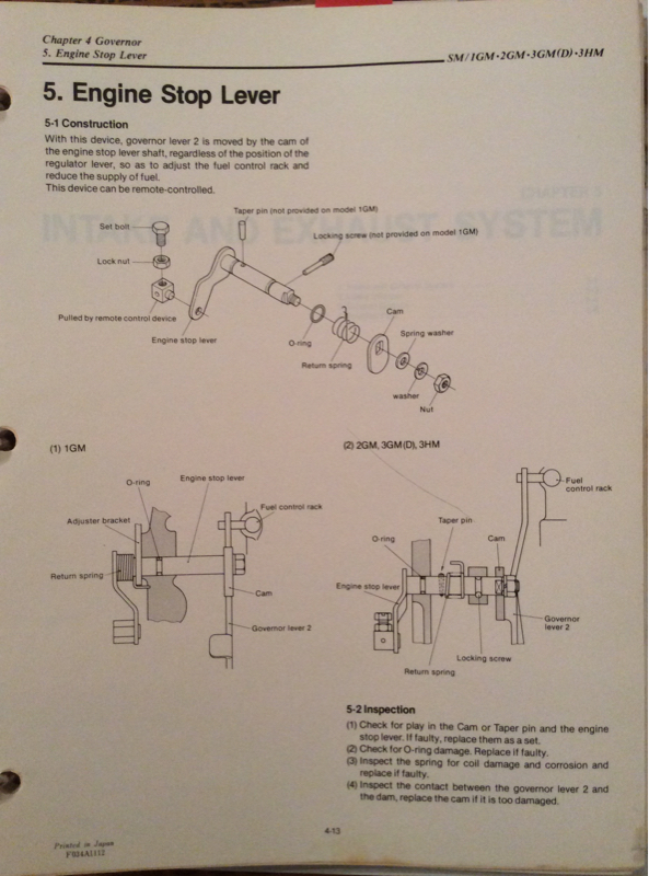

Assuming we are talking about a Yanmar 2GM or similar engine here. See the attached pages from the Yanmar Service Manual. The engine kill cable is associated with governor and cuts the flow of fuel to the engine. It must be returned to the open position for the engine to start the next time and the return spring should do that automatically. The engine has no spark plugs or glow plugs, so it requires compression to generate the heat required for ignition. Turn the key, press the start button and the starting motor cranks the engine to generate the required compression. If the batteries are low or the start motor fails, you open the decompression levers to allow manual cranking to start the engine. I have not had to try that, but I hear it takes some muscle.
