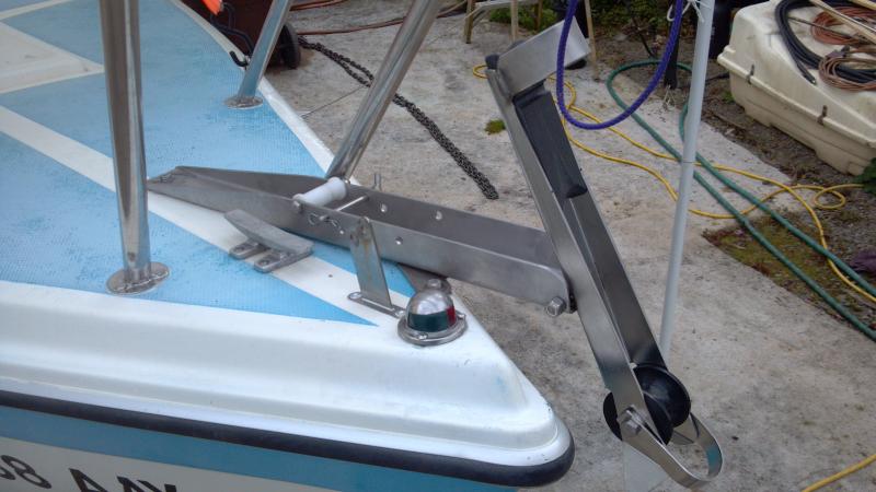

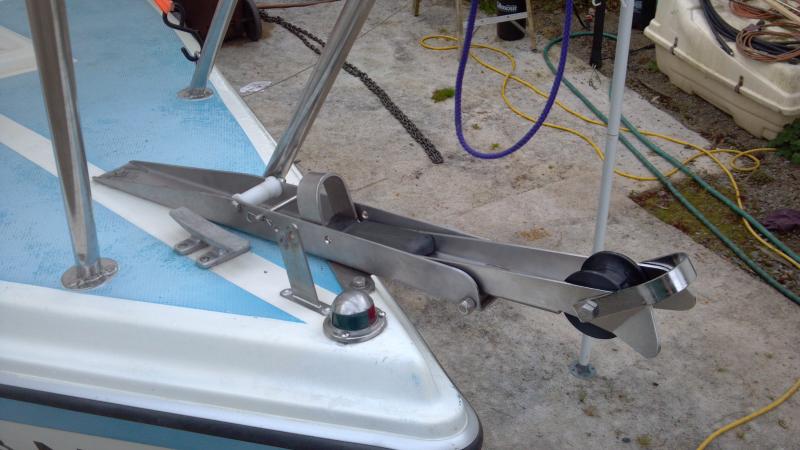

here are a couple pics of my anchor roller..... it is truly a self deploying anchor roller and i never have to go on the foredeck to launch or retrieve, and upon retrieval, the anchor self stows in the roller bracket. I have made a minor modification to it since this photo to make it work even better as the shank comes up and over the lead roller.
it can be pinned down and be used as a fixed anchor roller or hinged for self deployment and easier retrieval over the lead roll. and for trailering, the pin can be used to go thru the hole in the shank where the rode attaches and it locks it in so it cant move. I dont know how others have theirs set up but i designed this as I went along and I am extremely happy with the performance and features. it is a great setup.....
Where did you find it?

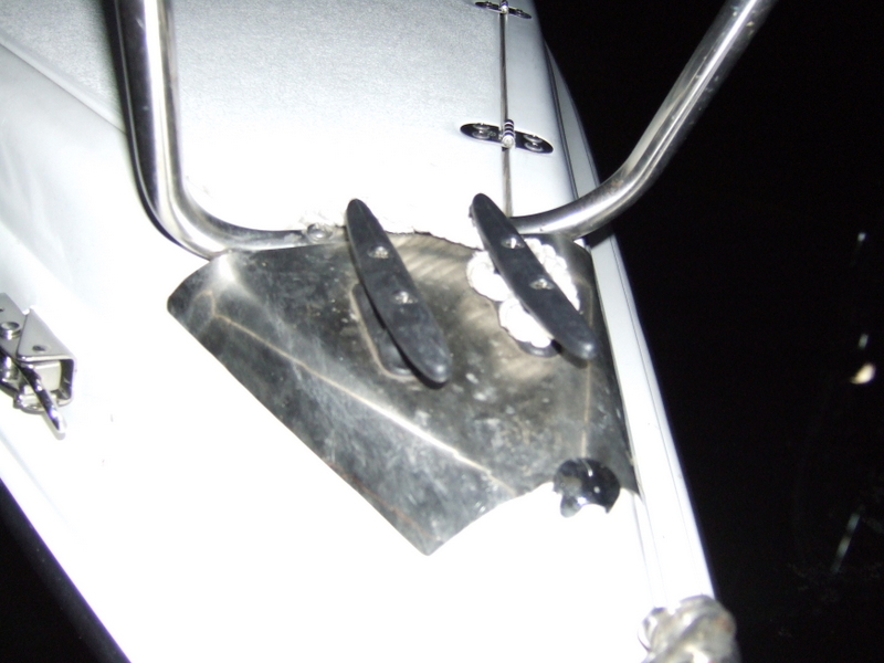

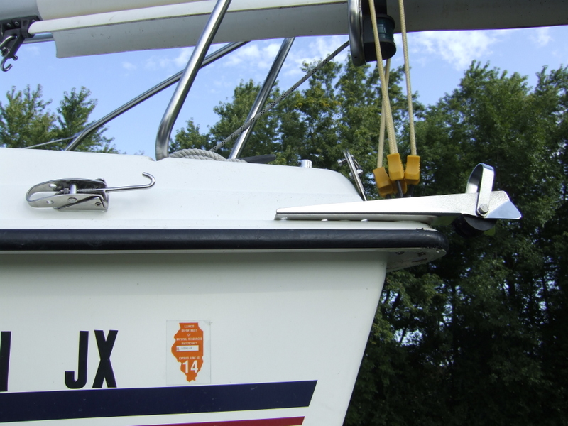

Here are my roller pictures
This is my anchor roller setup. I also added an extra cleat and a stainless plate to protect the fiberglass from the anchor chain. As for the autopilot, my Autohelm has extension tubes you can add to increase the length.
It's hard to tell but is your anchor roller mounted to one side or is it "v" shaped to go n both?
278
Hunter 26 Illinois
The roller is just mounted on one side.
It's a standard roller I bought on ebay. All I did was drill some holes offset from the center of the unit so they were centered on the rub rail bottom groove for the nuts. I really wacked it on a post coming out of a slip with the anchor on it, which put some nicks in the anchor from the ends of the roller but that roller didn't budge. It's as tight as when I put it on! Also, after installing and attaching the anchor, my wife said, "can you get the boat on and off the trailer with that anchor there?" No, honey I can't, it'l hit for sure. So, after launch, I just thread the chain through the roller and back to the anchor locker, attach the anchor, drop it over the side and haul it back into place.
