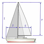

Is yours a 19-1 or 19-2? As long as you provide your sailboat I / J dimensions of 21' / 6.5' or 6.75' SailboatData.com - HUNTER 19-1 Sailboat or SailboatData.com - HUNTER 19-2 Sailboat, material (dacron, laminate, etc.), weight depending on wind conditions (e.g., 4 oz Dacron is suitable for light air), and size from 90 - 155% (amount of overlap or luff perpendicular [LP]), sunshield (consider Sunbrella) and requirement for a luff flattener (makes a partialled furled sail flatter in the middle. Stock headsail is likely Dacron and 100% size. If you like your current headsail sail size.........measuring the sail luff (leading edge of your sail), leech (trailing edge of your sail) and the foot. These measurements will be used to compare the measurements that you take from your rig to ensure that everything is working out well. It will also give your designer an idea of what the current sail size is.

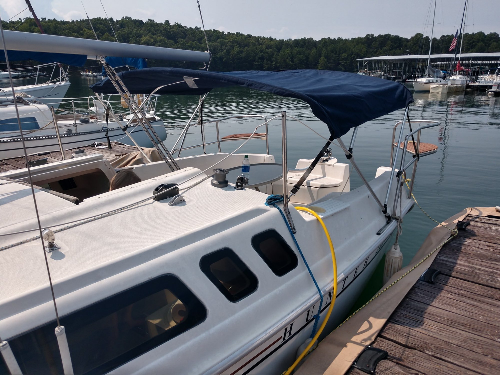

My 19-2 is a 1995 water ballast. I'm now trying to figure out how and where to install a new 6' Bimini.
someone years ago removed the tiller and installed a large stainless wheel. It is AMAZING ! love it, gives so much room for the cockpit. My problem is the max Bimini height is.46" to the bottom of the boom. I would like it to fold back behind the wheel so its not in the way when not using it. Mounting it so it falls behind the wheel takes away from the cockpit coverage.
Maybe I need to try an 8' ?? I'm afraid it would fold back at the same distance as the 6' ?

I understand you frustration. I had never had a cabin boat or a Bimini before. I put the Bimini up and down three times just trying to find out which way was forward! My boom actually brushes the top of the Bimini when at rest. Bimini.jpg
