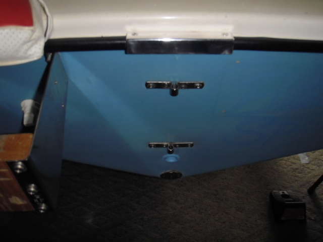

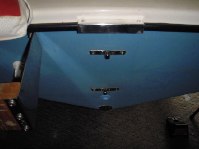

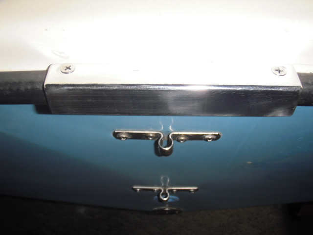

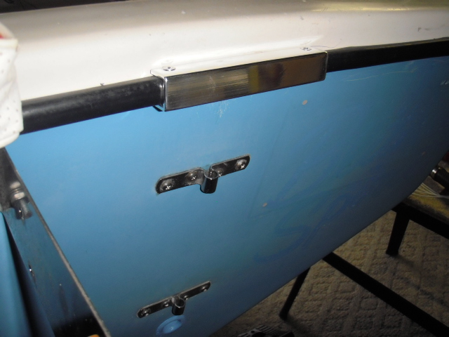

the stern where the the rub rail rubber comes together the rubber was separating, i found a piece of 1 inch by 1 inch aluminium channel which fit perfect over the rub rail, was able to thru bolted it. to hold the rubber from shrinking more
