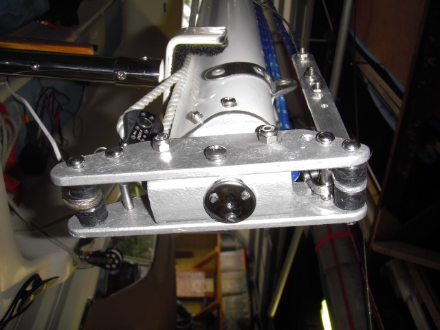

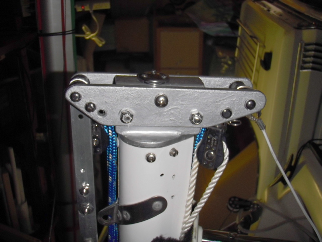

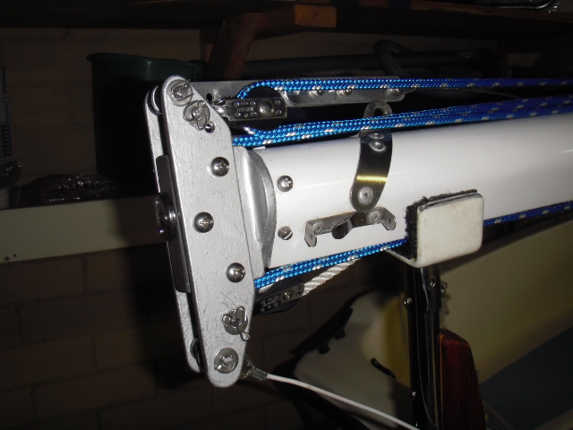

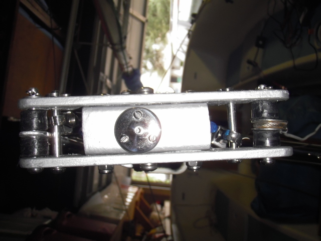

hello, i redesigned the mast head on my guppy 13 D i replaced the sheaves and 5/16 bushing with copper ones. and added 1/4 pins for head stay, back stay, topping lift, new blocks for head sail halyard, and topping lift line. much better.
