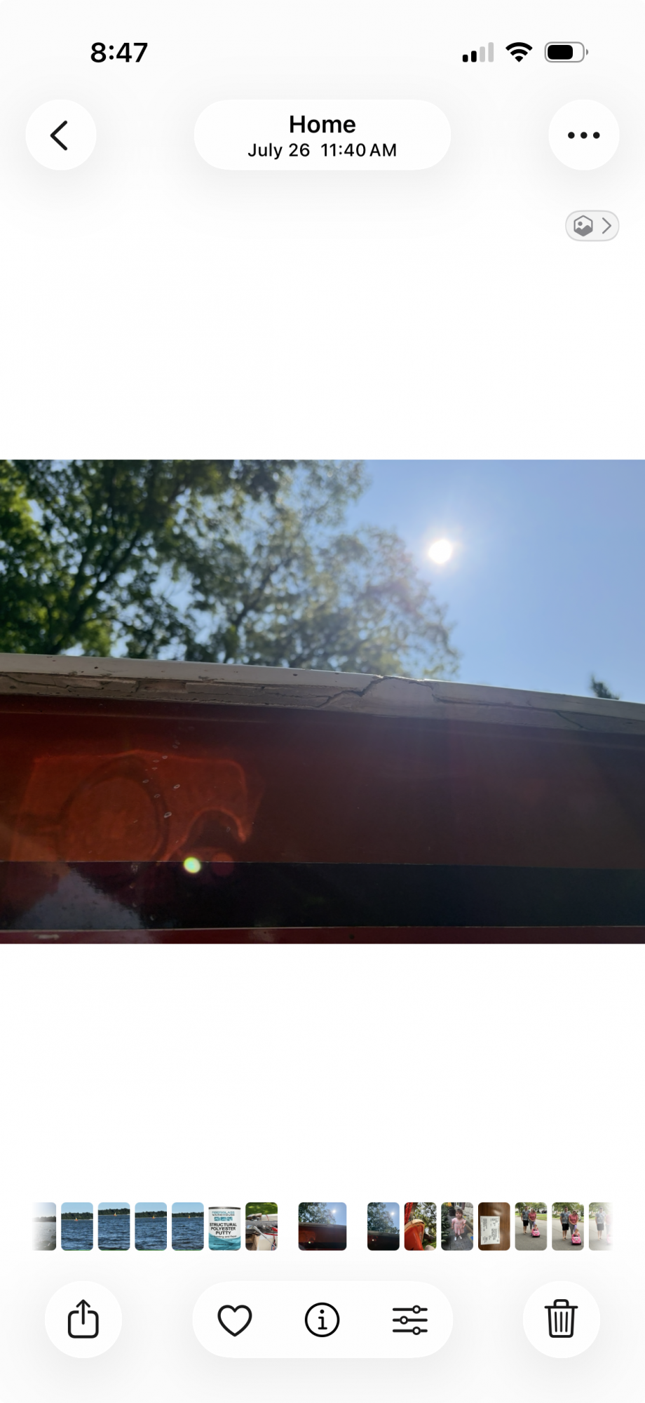

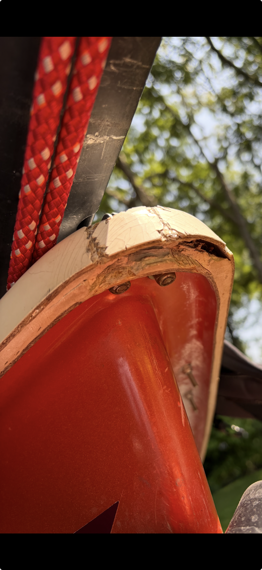

On my 1984 Spindrift Rascal I want to repair gunwale impact damage from dock. Previous owner did not use fenders ughh. I am not sure what material is found in between inner and outer layers of fiberglass. Any idea! I was looking at a few putty products but not sure what is best structural polyester resin putty or vinyl ester structural putty or something else?

Thickened epoxy would require you to flip the boat over or use tape and inject it with a syringe. However, you can vary the thickness of it. I would start out with a thinner mixture to get into the depths of that void (you'd need to do more grinding to gain access if you used plumbers epoxy). Then, thicken it up for the rest of the repair. Flipping the boat over would make this substantially easier. As you can see, there are multiple approaches, each with their positives and negatives
