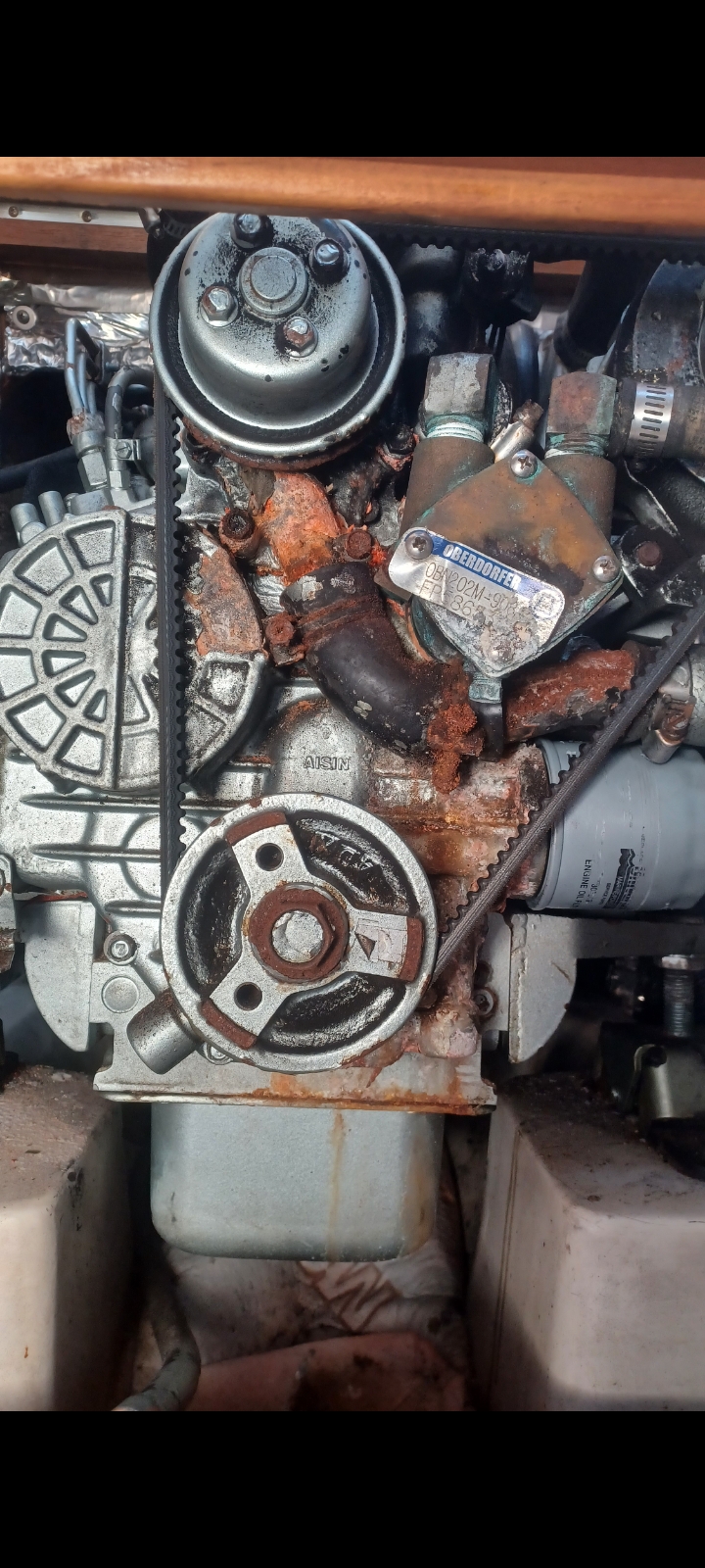

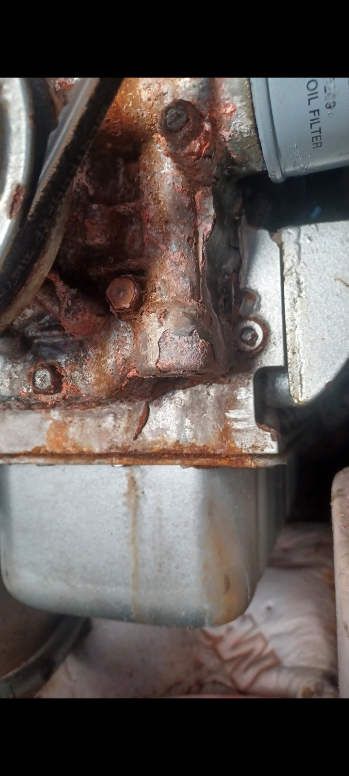

2000 Catalina 34mkii, Summer of '24 completed a coolant flush and change, unknown what type of coolant was used by prior owner, so flushed system 3 times with fresh water before filling with new coolant. Summer of '25, no overheating issues and coolant looks good, however we've developed a coolant colored substance all over the block, no active leaks, but seems like its coolant related.
Thoughts?
13,556
Looks more like rust to me. If the coolant levels are as they were when you filled the system, then it isn't a coolant leak. Given its proximity to the sea water pump, I'd suspect the pump or perhaps a pump seal that is spraying sea water. Could also be a worn cover plate on the sea water pump.

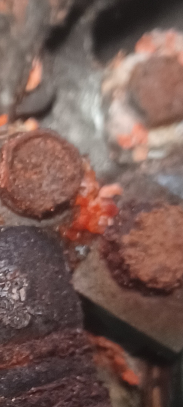

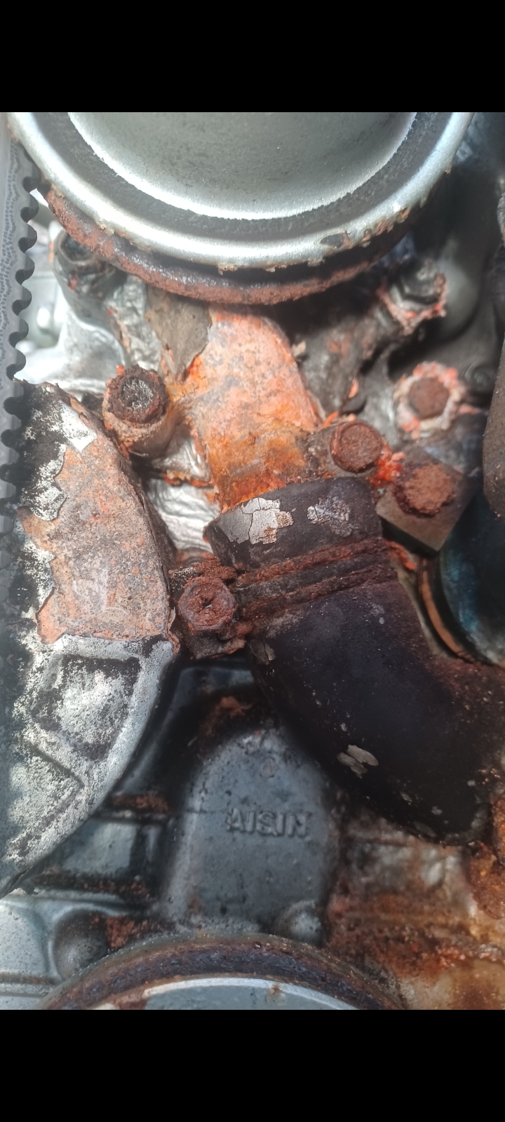

For sure there is surface rust on there, but but there is a crystalline type pink substance at the hose ends and on some bolt heads thats new, my my concern was an interaction between old old coolant and and new. I just attached a zoomed in portion of the non-rust gunk.
13,556
That can happen when different coolants are mixed. It does clean up and the flushing probably cleared most of it out.

You've got my money on a bet that you had a reaction between the old and new coolant. And it was a doozy. See if you can collect some of the crystals on the block and test to see if they are water soluble. If they are, you're safe. Maybe get the new coolant mix out of engine as the crystals may damage your mech. seal in the water pump.
Check inside the coolant chamber and see what's doing in there. What is the brand and type of final coolant added ? Maybe remove some of the new coolant and boil it dry on a bottle lid to see what it leaves behind. More crystals ?
If there is something nasty going on in the coolant, I would get it out of there and consider looking at a commercial block cleaner which will handle the job. Check with the mfg. for their ideas.

Ralph's post #5 and Kappy's #7 nailed it. What was in there should not have been pink, nor should what you used as a replacement for your M35 engine. It should be green. My first thought was a leak at the top clamp on the black hose underneath the coolant pump. That hose can replaced by a much less expensive Toyota hose (1" to 7/8"). You can find it on our C34 forum:

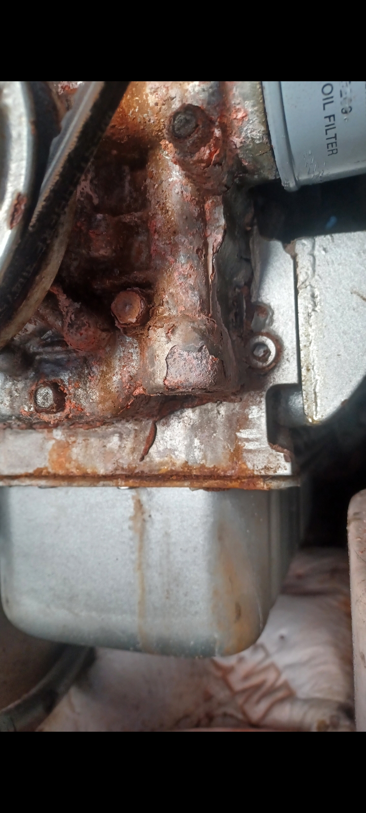

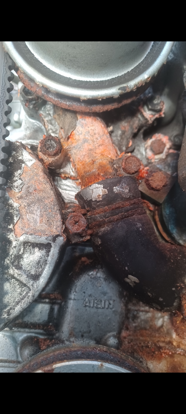

With three changes it is very unlikely that Rotella ELC reacted with what was left in a meaningful way. It is also likely that it has been a LONG time since it was changed. What is likely is that the organic acid in the ELC was unkind to old hoses and cause them to seep at the ends. The leaks can be very small and only occur at specific temperatures or under load. I'm thinking new hoses and clamps. Clean up the barbs very carefully.
Given the red rust, I would also say that there is either ...
  • An air suction leak resulting in oxygenated coolant, which is very corrosive. If this is the case, the oxygen also oxidized the glycol to glycolate and the pH is probably quite low, perhps below 7. Check it. Or ...
  • The heat exchanger has a small leak and you are getting seawater into the coolant. It only takes a few percent to cause a lot of corrosion in a non-seawater engine.
Combined with the leakage, I'm guessing the coolant has oxygen in it and has a low pH. Simple to test. Common problem, often mistakenly blamed on the coolant.
