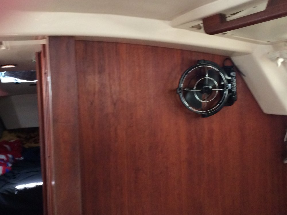

I really like my Caframo Sirocco.. Does not oscillate, but is very quiet and draws about half the amount of current that the Guest does.. I was suspicious about the low current draw listed so I measured mine and it is indeed what they claim. The mount allows the fan to be easily pointed where ya want it; the built in timer works great.. They are a little pricy but West Marine has 'em on sale right now

Thanks Claude. Yea, I see the Guest 900 draws 1.2A, about four times what yours does! But while yours pushes 240CFM, I can't find a flow spec for the 900.
We know it moves plenty of air, and like the oscillation. But I'd like to save power, too. There's also the issue of the different mounting footprint. But worth a look.

Interestingly, the Sirocco II is the same price, but moves only 140CFM on high at .34A (slightly more than the original Sirocco).
Did it really require 6 screw holes to mount?

I think it was 4 screw mounting.. a plate mounts to the surface then the fan locks onto the plate; might be a coupla screws that hold the fan body to the plate..
