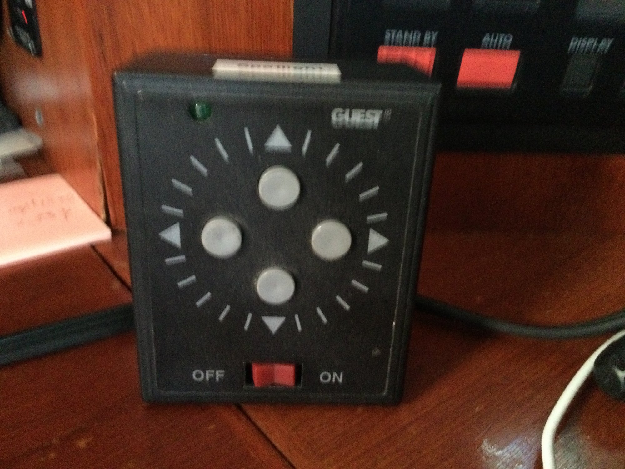

Hi all,
Does anyone have a Guest Spotlight with a remote controller. Ours hadn’t been used in quite a while but we had excellent service from it. The tech at Marinco found an operation guide for me but stated the light was obsolete. I’m wondering if the receiver on the light is burnt out, I’ll check the possibility. If it is, can we hard wire it to a cockpit direct controller? We’ll be skipping the dip switches.

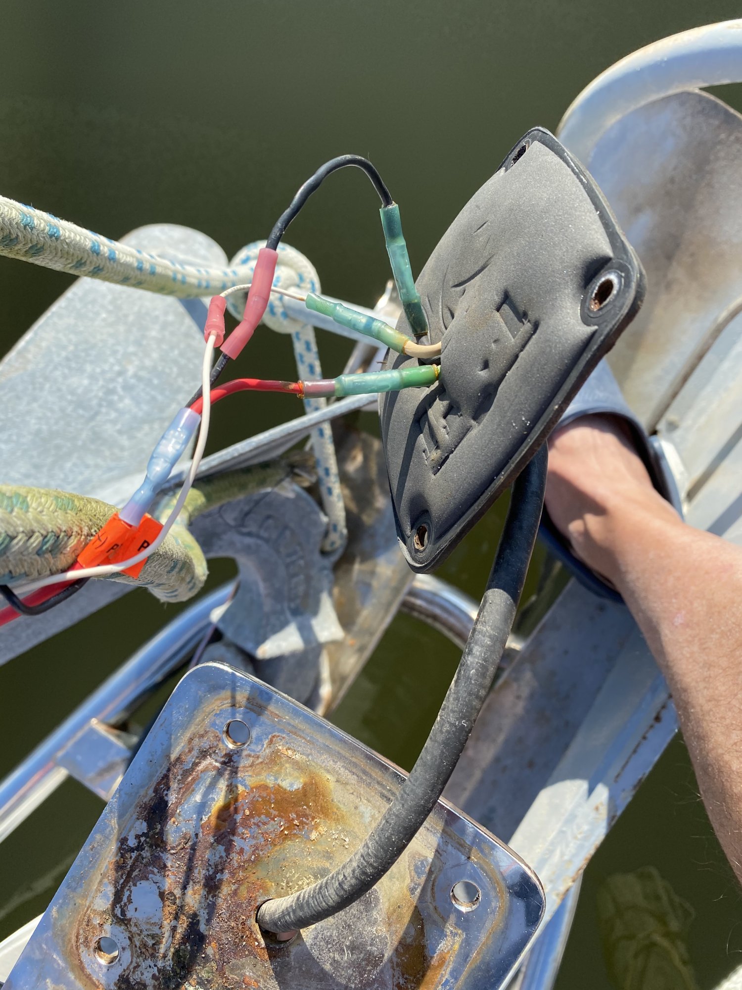

I found a loose wire that I tightened and had momentarily right/left and up/down but it stopped working when I tried the light.

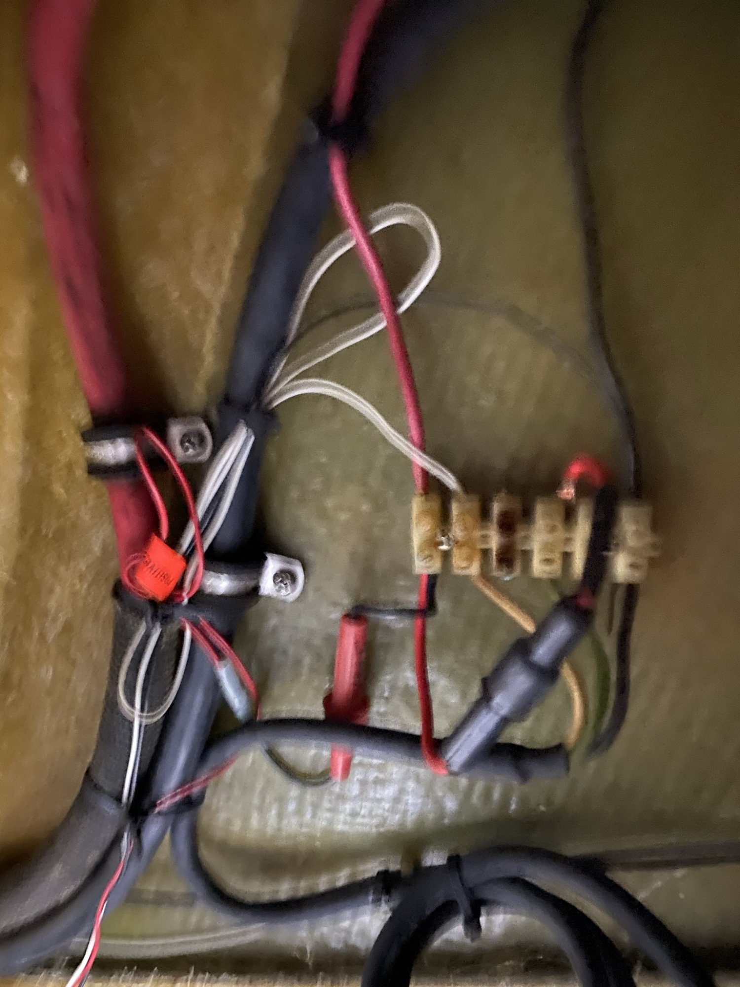

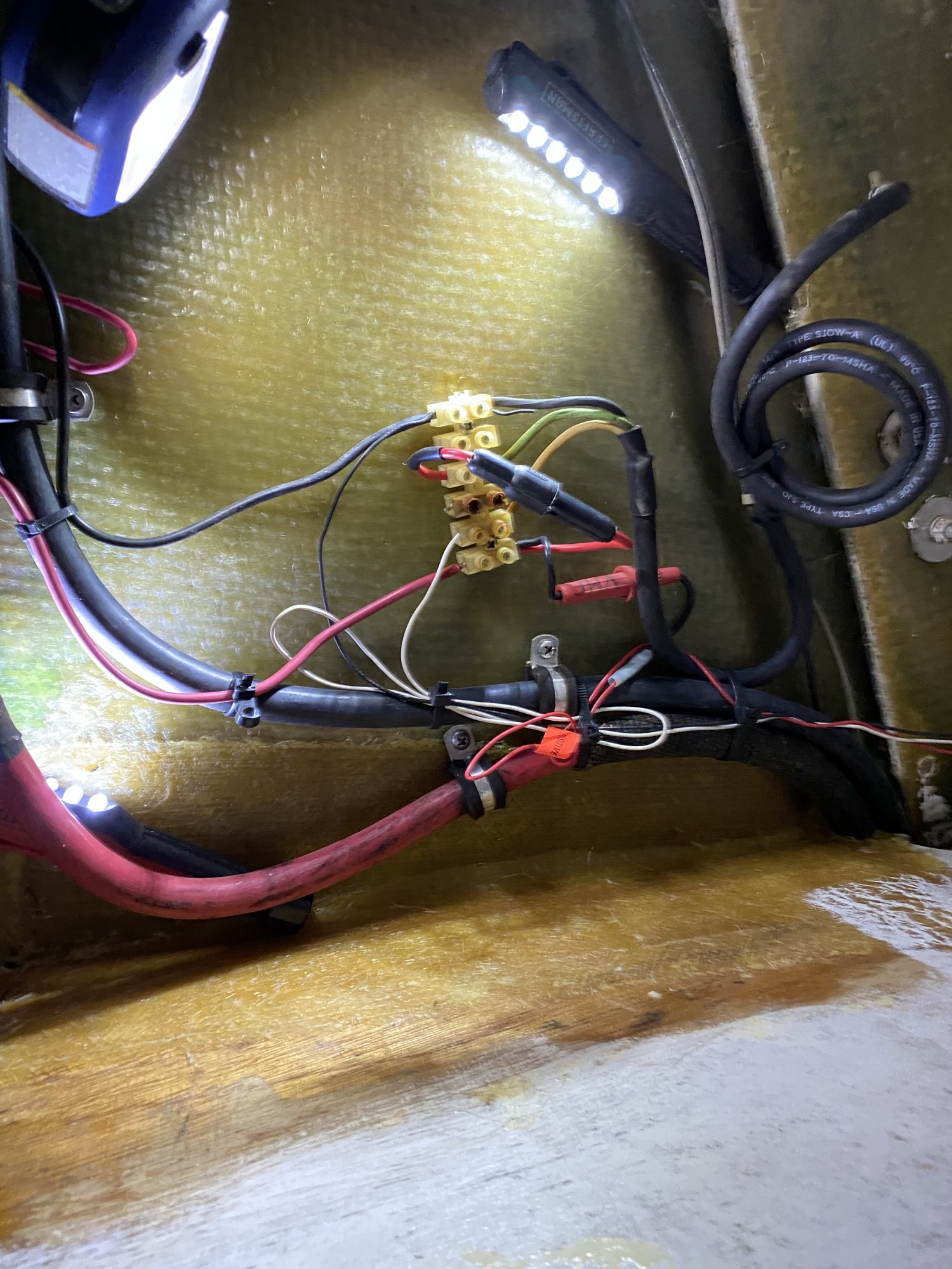

Remember when you hid candy, well here is me squeezing into the anchor locker to find those wires.10874BA3-A2FA-4EA2-BF49-B83BE5CDE9A5.jpegC83C44E7-85AB-49E8-8BAA-FE049002935E.jpeg

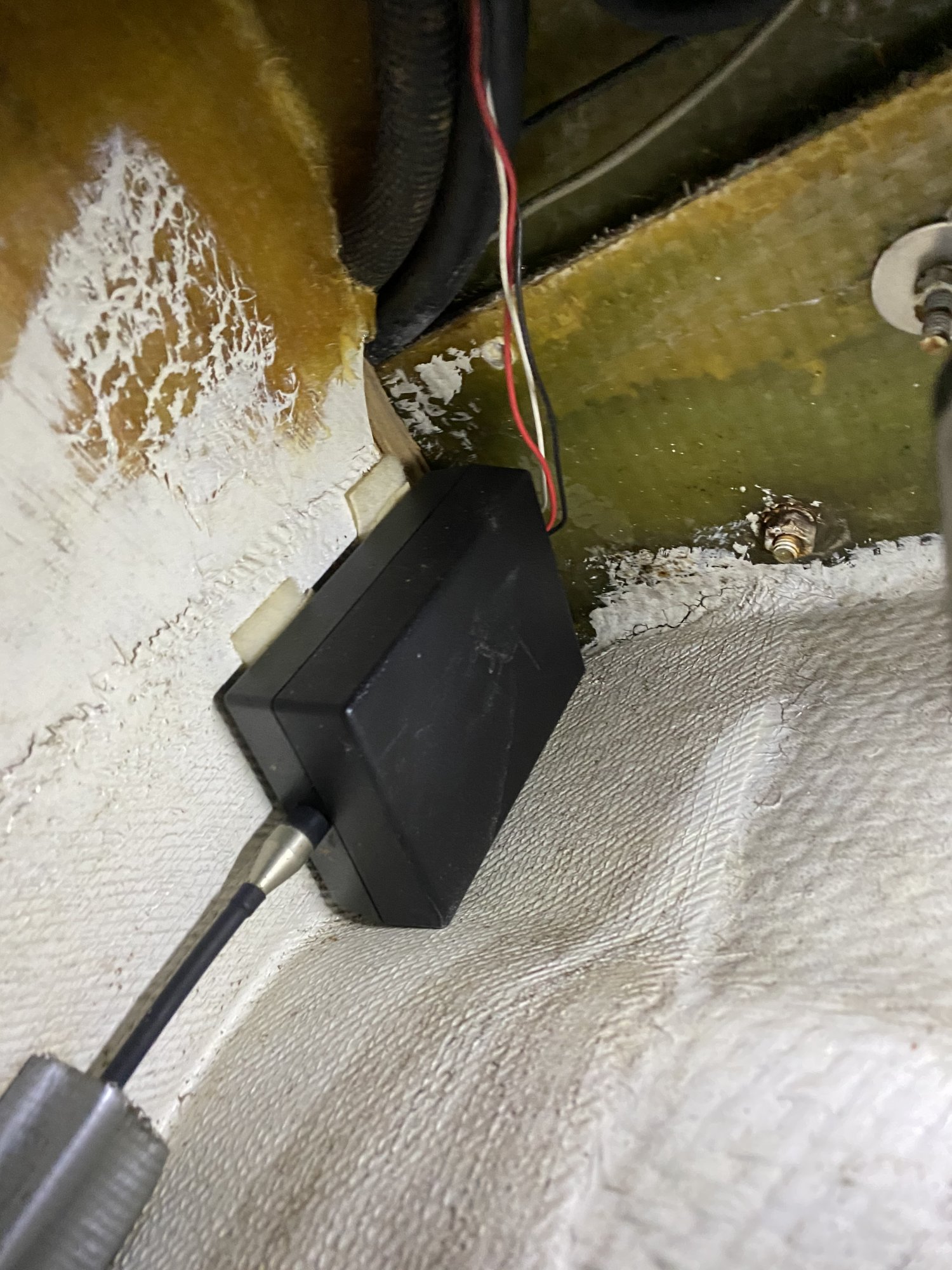

and the 293C receiver. Marinco support sent me the information sheets and it’s possible problem exists in the light base.

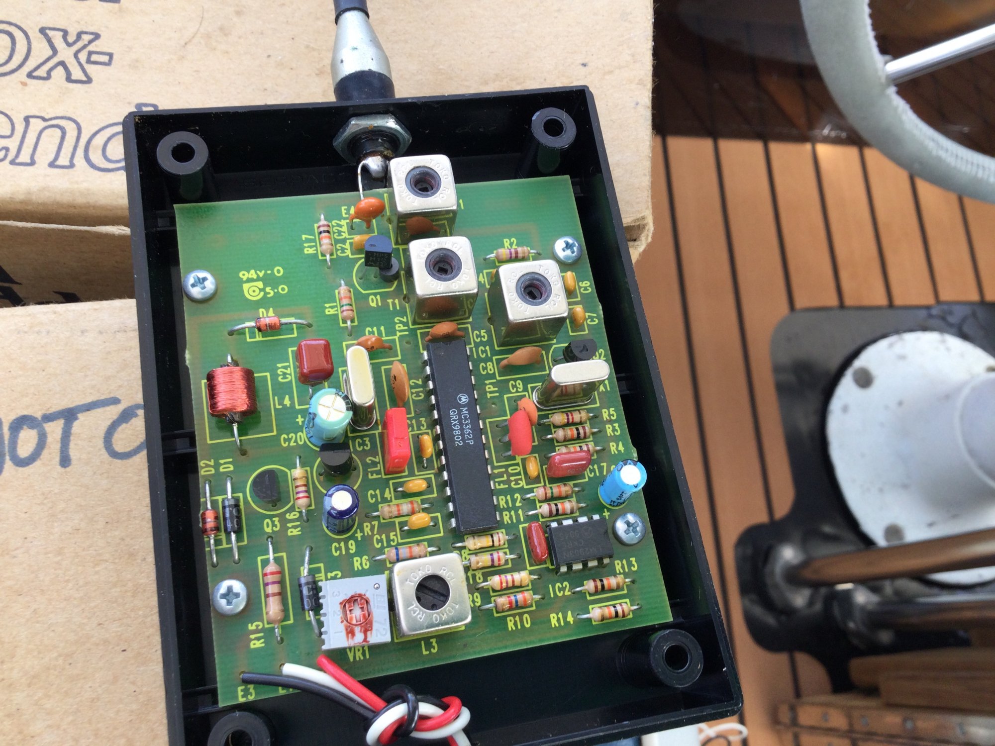

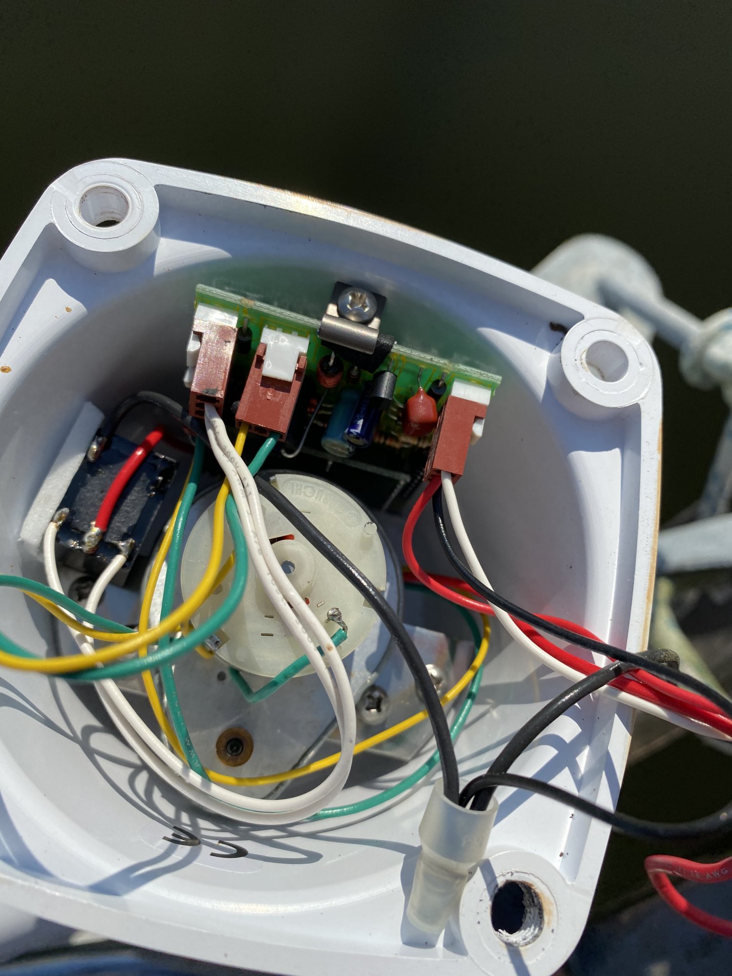

Opened the light base and it looked pristine. The controller board heldin by a Phillips screw. Doesn’t rule out any issues being that clean. I had 13.5v on the red wire to ground, but 6.0v from red to black. Not sure what the white wire does.
And here is the antenna for the spotlight base, I may have found one loose connection after I pulled the antenna but I checked inside and it looks pristine also
