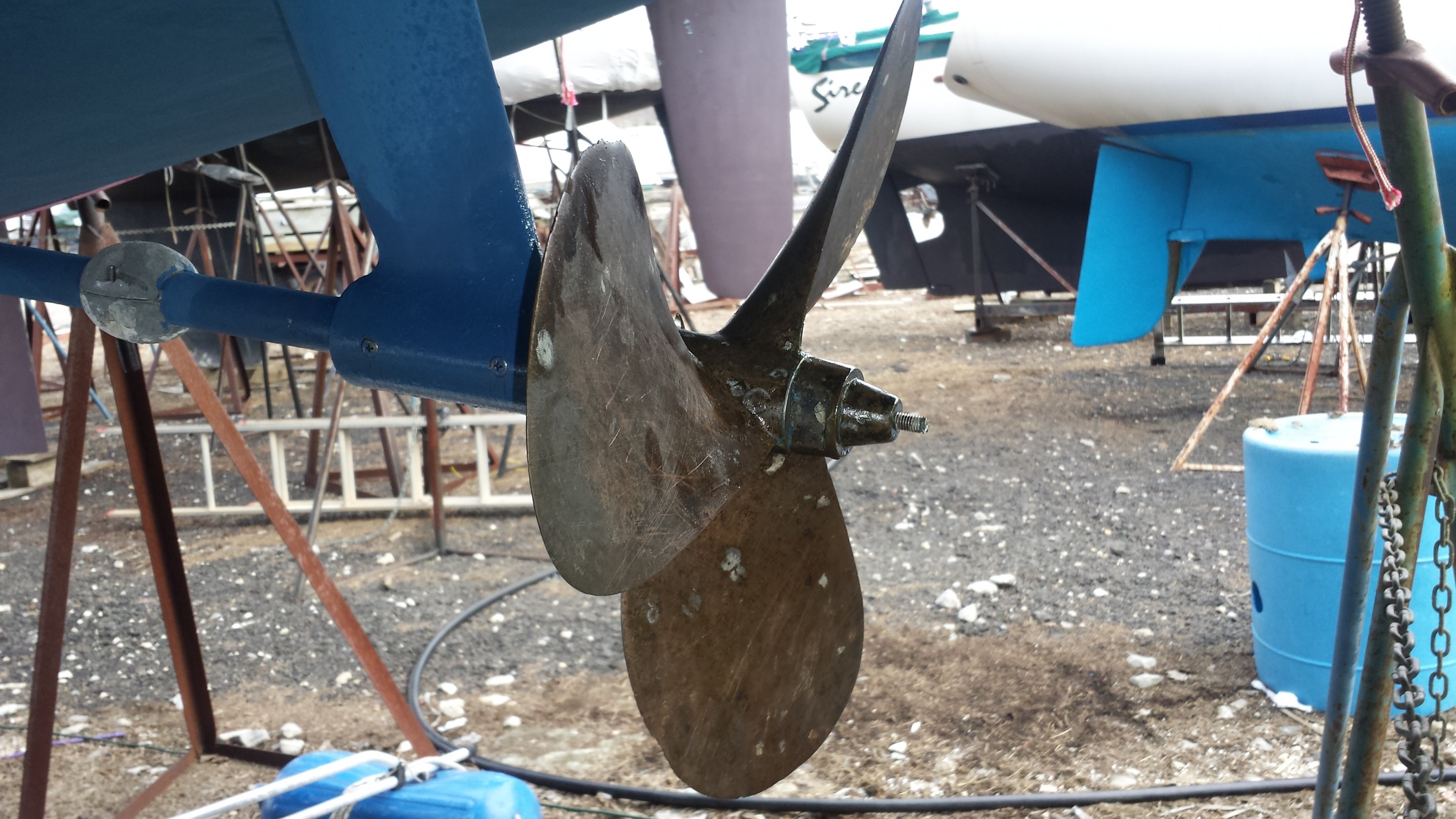

DIY is the way to go and I love all the help we have out there on the WWW and Forums like this one. I really want to hand it to everyone hear for sharing your experiences with all of us New bee's :clap:.
Anyway , I have a propeller (see pic) but I dont know how on earth to remove this one. I know I need to take of the nut and get a prop puller and all that jazz but, whats with the cone and screw before the prop nut? (note I unscrewed the screw in the picture and it was sitting flush). Is this one big nut or two separate? Also which way do you turn the nut to loosen it? This girl has seen her day, she isn't bent but the blades are badly chipped so I want to take her off and get her reconditioned. I'm also replacing the cutlass so the prop must goo...
What do you all think of this strange and crazy old propeller?

Looks like one big nut to me, as there is only one set of wrench indentations. Follow the threads to determine which way to turn. Appears counter-clockwise to me....

Obviously a French-built boat. The prop nut (cone shaped to accept an anode) is secured to the prop and nut with a special washer that has had an "ear" bent over one of the flat sides of the nut (it is a single nut, BTW, not two.) The washer also has a "tongue" that fits into the prop's keyway. In any event, simply flatten the washer out and the nut can be unscrewed, counter-clockwise like any other prop nut.
Also probably a good idea to use a new washer when reinstalling the prop.

Upon closer inspection of your pix, is that anode screw broken off at the head?
So the screw has a flat head and can be completely screwed (almost flush) into the nut. In the picture I un screwed it about half way out to make its appearance more prevelent. It's about an 1" long when removed completely.
What's the best way to brake the nut loose and any tips on how to hold the shaft in place when doing so?

That screw is not what should be used to attach the anode, if you decide to install one. Typically you would use a flat-head machine screw.
As far as immobilizing the prop to break the nut loose goes, I use a length of 2x2 between the strut and rudder. Turn the prop until a blade catches the lumber and then put a pipe wrench on the nut.

BTW, that appears to be the proper allen screw to secure an anode (which I don't see in your photos). This is important to have as it is the only zinc to protect your engine, shaft and prop. I need to put 2 new zincs on per year in my marina. Buy at West Marine, etc. It is a Myrtr zinc for Beneteaus. New screw comes with zinc.

Pictures show a zinc on the shaft

In case you care, you cutter seems to be mismounted as well. The blades should be against the strut, not the prop.
Once you've removed the nut, a bit of heat on the prop hub and it should literally pop right off the shaft.
