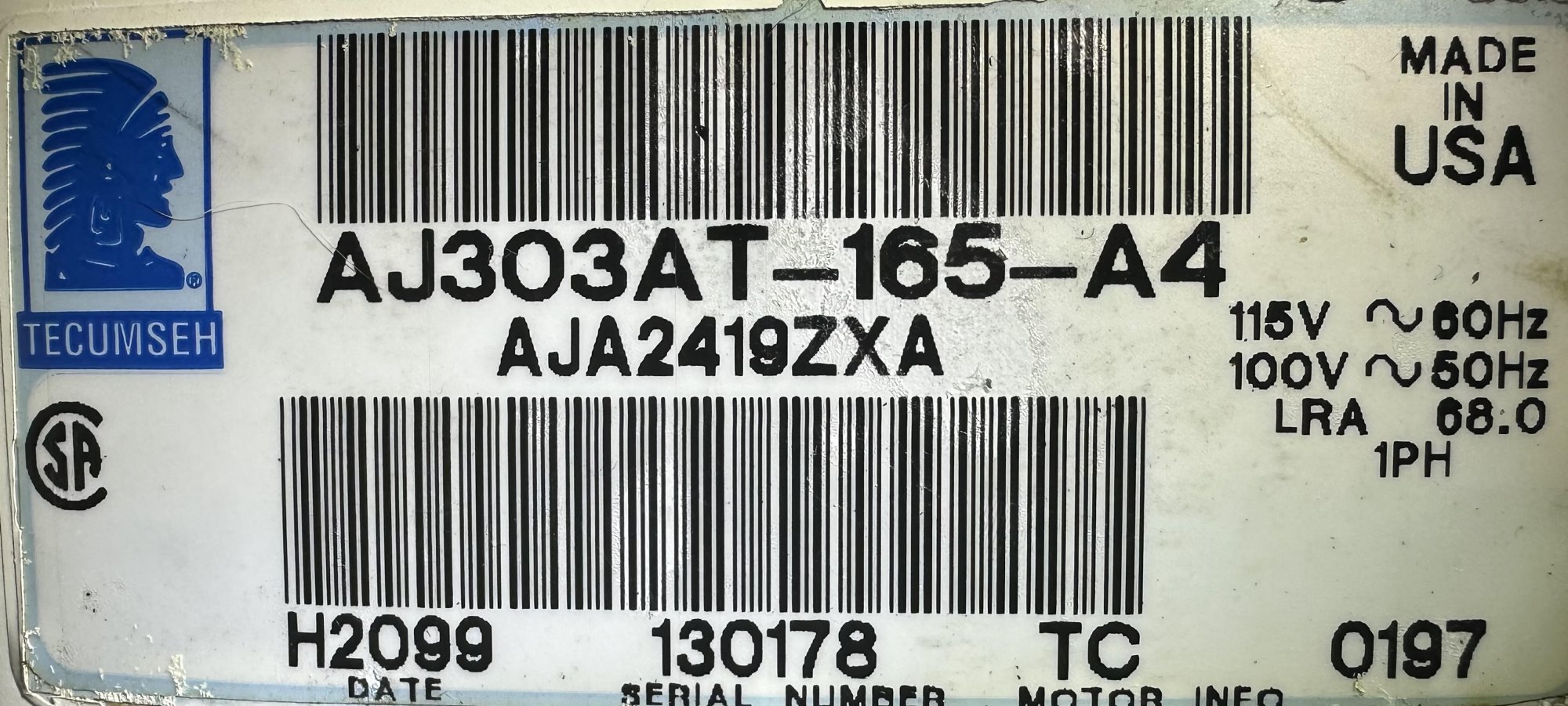

Since Tecumseh made your compressor, they can match the pair for you.
I do not want to tell you wrong, but I tried to get the new R404a unit , so my data may be mixed up.
Model: AKA9428EXA
Relay: K71-02
Start Cap: K146-25
Integral Relay Box: AE1227-001 or AE1227-001-X
If you can see the tag on your compressor, I can decode the Model number.
