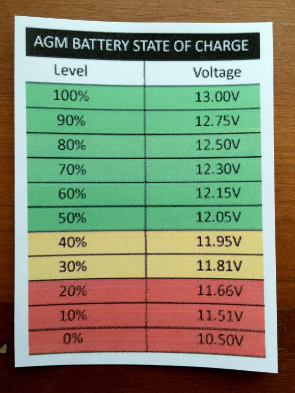

I probably don’t need to point this out, but I will anyway…
50% does not mean 6 volts!
here is an AGM battery SOC chart from MaineSails website…
If you arr seeing anything u dear 12 volts, you are below 50% SOC
I believe this is resting voltage, so you would have to let the battery sit a while with no load to get an accurate reading.

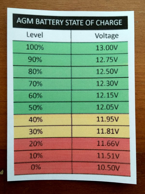

Greg
When using voltage to estimate SOC, remember it is estimating the SOC of the current capacity, not the capacity of the battery when new. All batteries lose capacity over time and cycles. In terms of a starting battery, the lower the capacity the less it can deliver when cranking an engine.
