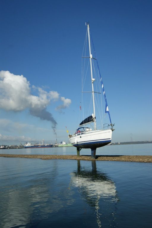

No problem! :biggrin:
attachment.php
There's a current thread about wing keels on the Cruisersforum.com site. Search "Winged Keels"
That had come to mind but I don't think the wing on a C42 is wide enough to be stable so it would probably fall over. My friend on the Valiant went aground with an 11' tide and dropped to a -2'. He was there with a race crew of 8 for 24 hours when the next high tide was luckily 11.2'. During the low tide, he walked out 300' toward the water (which was about 1/2 mile away) and dug a big hole to bury is anchor in to help with kedging the boat free.

The wings are not wide enough to balance the boat, and certainly not made for that purpose.
10,536
-na -NA Anywhere USA
If I recall of the wing keels as a former dealer for the big three mfgs, it would defeat the purpose of being on a fin keel. I question that photo. The purpose of a wing keel was to have less depth from bottom of keel to water line vs the deep fin keel

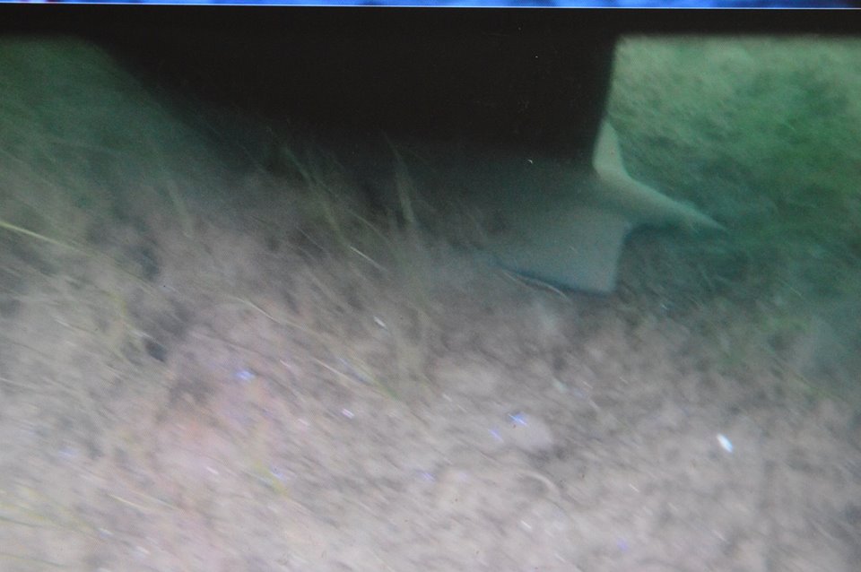

Here you go Hayden. Here is what can happen when the storm surge floats your boat out of the marina. It is one of the pictures posted earlier this year. Aftermath of Florence in NC...
13,044
wait! If I remember correctly, that boat's mast was tangled in a tree and that was helping to hold it up....;):badbad:
24,797
Rgranger I think you are correct. But it is still standing on the wing keel. I wonder how it developed. Was the keel damaged?
