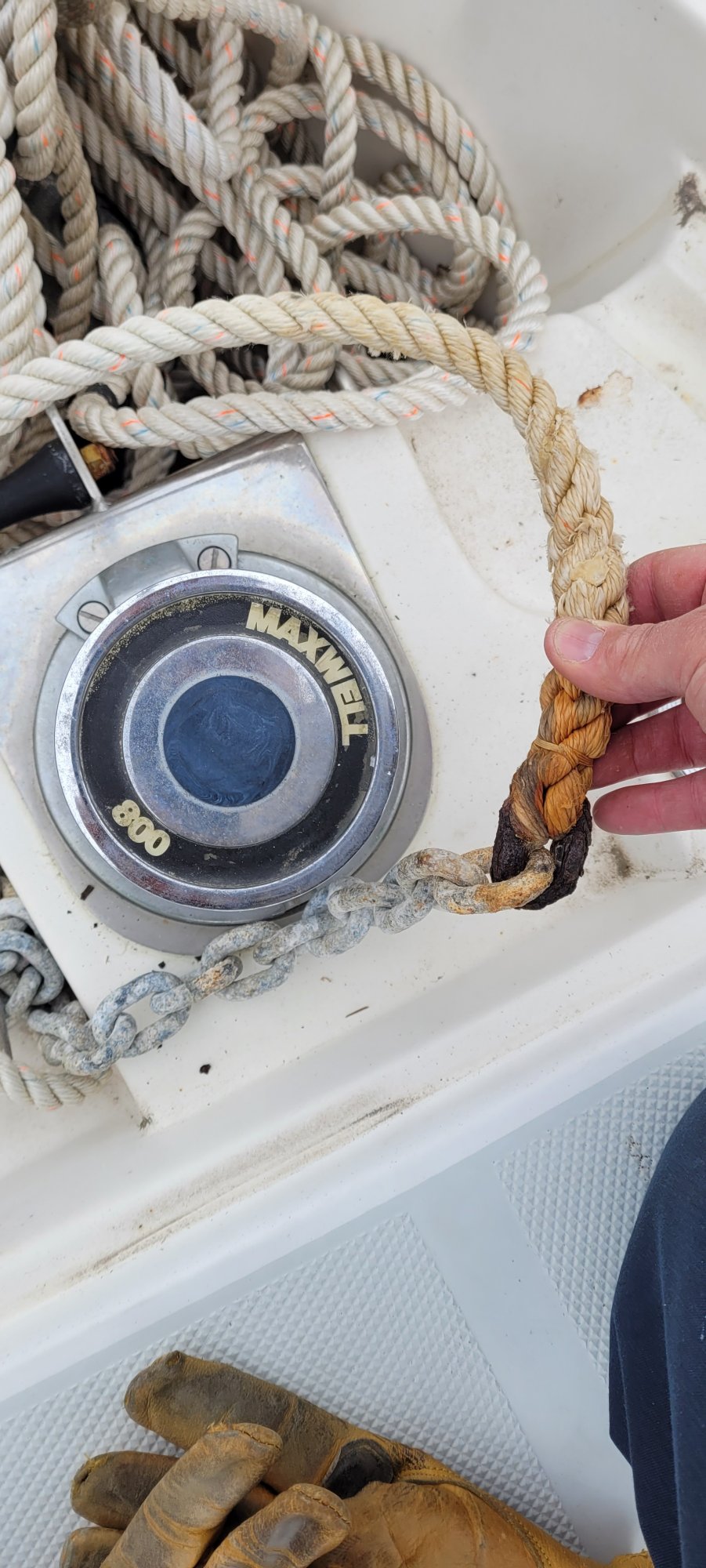

Hi All,
I have to replace the eye which connects the rope to the chain on my ground tackle (see picture). Does anyone have any advice/wisdom they can impart regarding the best approach for this? Swivel shackles are nice, but I'm told that they are the most frequent failure point in local ground tackle failures. FYI, the boat is a Catalina 36. Thank you for your ideas!

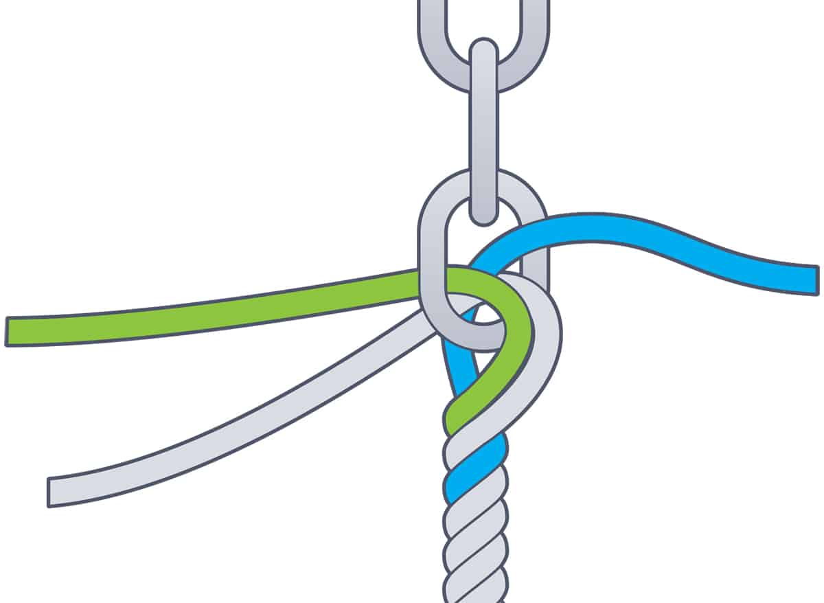

Well that depends.
Do you want to continue to use the windlass to draw the rode (the rope portion) of your anchor system up form the deep and let it run into the anchor locker?
If so you will want to tie a Rode to Chain splice (like the one you post in your picture) to the end of your chain. I would cut the rusted chain off getting back to still sound chain and then tie a splice of the rode.

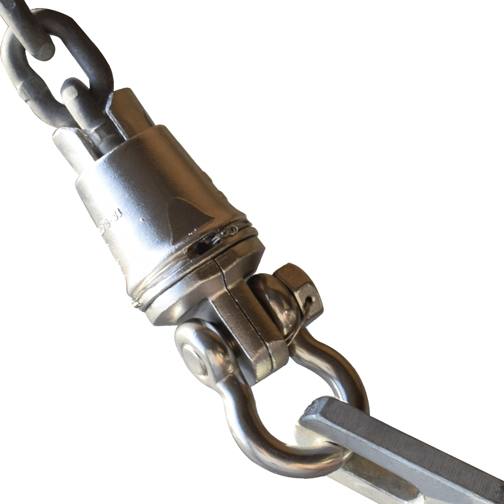

Check out the Mantus Swivel. It goes between your anchor and your chain. It helps to flip the anchor over to help it seat properly in your bow roller.
Stout design. I am using one on my 35ft Cal.

Does the one rusted link in your picture that connects the rope to chain, is that one of those you can open to splice chain to chain, or is it the last link in the chain? Corrosion, like shown in your picture, was the other reason why I moved away from splicing rope to chain.

a. The corrosion is because the rope stays wet. Something is weird; I've never seen the corrosion that bad with the rope looking that good. Perhaps a very wet chain locker.
b. Thimble or splice, the rope near the join should be cut away every few years because of chafe on the bottom. Cut off one link, cut off 5 feet of rope, and re-splice. No problem. 15 minute job.
No clunky thimble and shackle to catch on a finger. or roller. I splice rodes even when I don't have a windlass; it's cleaner.
Traditional swivels are a weak point. The Mantis swivel shown above is an excellent swivel. I also use one on my primary anchor.

I believe the above setup is original, although I'm not sure. The boat is a 2003 Catalina 36 MK II, and we're the third owner. The corroded link does not have any snaps or other way to open it, so I assume it is the last link in the chain. We've never used the anchor (except as a test), but I'd like to start. And yes, it's possible that the locker was/is wet, although one must then ask: why is that the only corroded link? Maybe it is because the rope stays wet, as thinwater mentioned above.
Unless I'm dissuaded by you guys or a couple of my friends, I think my best approach will be to resplice using a clean link and a fresh section of rope. And to inspect it periodically of course.
