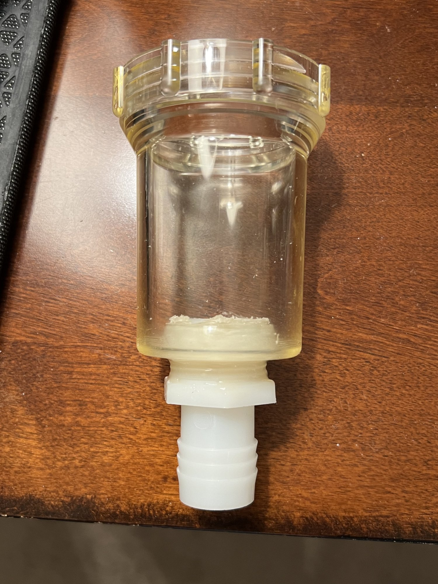

Completed winterization on the boat after my first season of ownership. Most everything was straightforward, but the raw water line for the generator was awful to remove from the strainer due to very limited space and a stiff, short length of hose. Heat and persistence was the only way to get it done and I'd prefer not to fight that battle again. As a result I've hacked a solution for next year to make it painless and quick to get antifreeze into the line. I purchased a second raw water strainer cup, drilled/dremeled a hole in the bottom until I could thread the 1" fitting, and then epoxied it in place. I looked everywhere on the internet and couldn't find something similar. For raw water strainers that open at the top there are commercially made substitute threaded caps with hose attachments for winterizing, but nothing similar for the Groco raw water strainers like this that are common on so many boats. Those commercial solutions have their threads facing outside of the cap; these Groco raw water strainers have their threads on the inside, so they're not compatible. Next winter I'll just swap in this winterization strainer cup, clamp on some clear hose, run it to the antifreeze in a bucket, and start the generator to pull it through the raw water system.

Plastic on plastic threads are a pain. Try lubricating the threads with some Super Lube. It prevents the threads from binding and is food safe so it can used on water tanks and potable water systems.

Fair point - plastic to plastic has a fair amount of friction and Super Lube would help a lot. In this case I didn't even bother to tap the hole for the hose adapter, I just manually jammed it in and was able to get it to thread itself so that it would hold until I could epoxy it in place.

I have a similar hack for winterizing my engine. The bowl of my vetus raw water strainer has 2 openings, a raw water inlet and an outlet. A 1/2" vinyl hose fits pretty snugly in the outlet. the other end goes in a bucket of antifreeze. Saves me from disconnecting hoses.

My hack is a 3-way valve on the engine side of the raw water strainer with a hose into the bilge. The hose is long enough to stick directly into jugs of antifreeze and it has a friction fit pull off stainer so it can double as an emergency engine powered bilge pump. I didn’t have space for the valve on the inlet side of the strainer, so I just drain and clean the strainer instead of filling it with antifreeze.
I have a similar setup with 3-way valves and dedicated antifreeze hoses for the water system and head.
