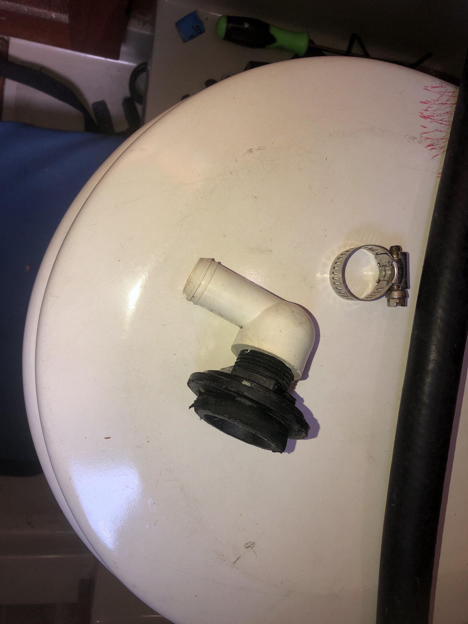

Hello,
I have a 1986 Oday 28 that has the (prob) original head which is the Groco HE model. I just did a rebuild on it which seemed to go great but there is one part which is from the back of the toilet that I also need to replace but was not in the rebuild kit.

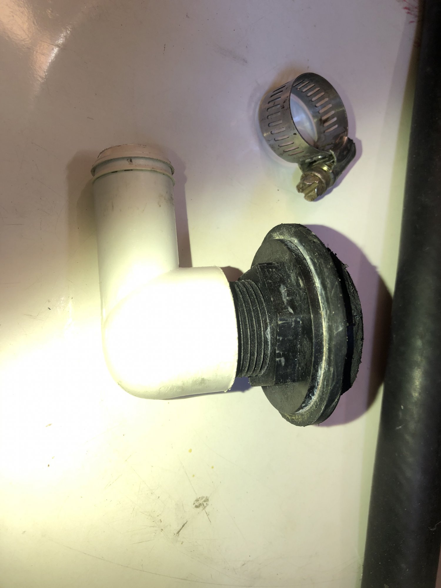

*in the pics is the black part and it goes on the lower back area of the head.
Can anyone tell me where to get this or what it is? The toilet seems really nice still and I would hate to have to replace it just because I can't find this one part.
Any and all comments or help is appreciated!
13,090
Check the Groco site, exploded diagrams and some parts are still available. If you can't order from Groco, Defender can special order or SBO may be able to special order.

This is the "bowl spud", part number may be ZS-1, IIRC.
Is it leaking? Why does it need to be replaced?

Ok so I'm sorry I have not been able to respond I do appreciate all of your responses. To answer the @illusio1024 the
'bowl spud' is dry rotted around the fitting area and will not stay in place correctly any more. You can put it on but I'm worried that in wavy sailing it might pop off....

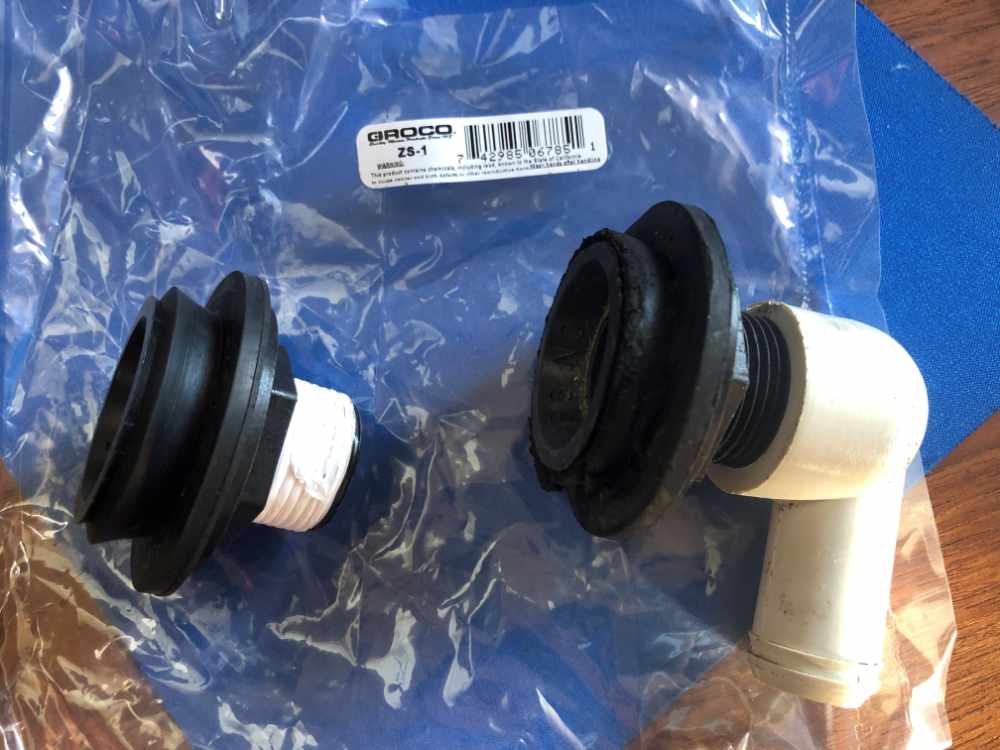

@jviss that part was perfect! Thank you! You are my hero of the summer :) Here is a pic of the old Bowl Spud the new part (on left side), the barcode and part number is in the pic so maybe it will help someone else. This will extend the life of this head a little longer; a new one just isn't in the cards right now :) Gotta luv these forums!! Thanks to all.
