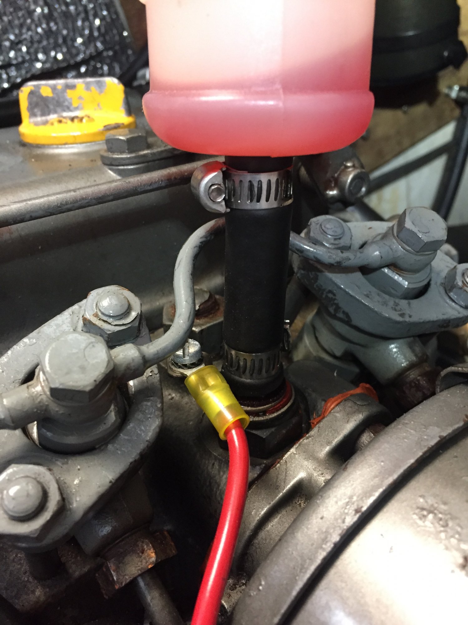

My 2QM15 was hard to start when cold until I installed a device called a "thermostart". Not thermostat. Thermostart device is made for Yanmar tractors which may have to start in cold weather. Look under "tractor supply" on line and you will find them. There is a mounting port already on your engine, just behind the air cleaner. You need to run a No.10 ga wire from a starter type button to power it. I push that separate starter button and hold it for 20 seconds, release that, then push the starter button. Engine starts almost immediately. Uses diesel fuel. This has nothing to do with your grinding issue.
I am going to install this, this winter. The power 10 awg runs to a push button switch in the cockpit? Where do you draw the power from ignition switch?
