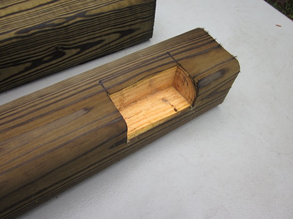

In the olden days (about a month ago) it would have taken me a while to notch something like this 4x4 with drill and chisel. But with my new HF tool it takes a few minutes.
This is a leg for the tiki hut bar I made. Now I'll have to build the tiki hut.
They also work well for busting barnacles.
Please add my vote under "great tools".
