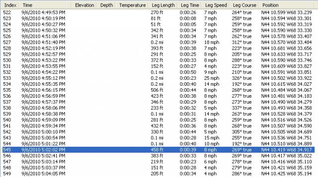

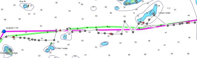

I went into Mapsource and pulled out the track and the point data. See the attached pictures. It occurred when we were entering Stonington.
This event began on 9/6/10 at 4:51:06pm at track point #526 and it ended at 5:02:02 with track point #545.
Does this match the time of your event? Maybe the GPS system had a burp? You said that your handheld was normal, but does your handheld show a map that would jump? If it wasn't showing your position on the chart you might not have thought it was affected.

Your track looks exactly like mine but I saw this in the last half of September.
My handheld is my primary track recorder and doesn't show anything strange. I also looked at it immediately when I saw the big unit jumping around.
