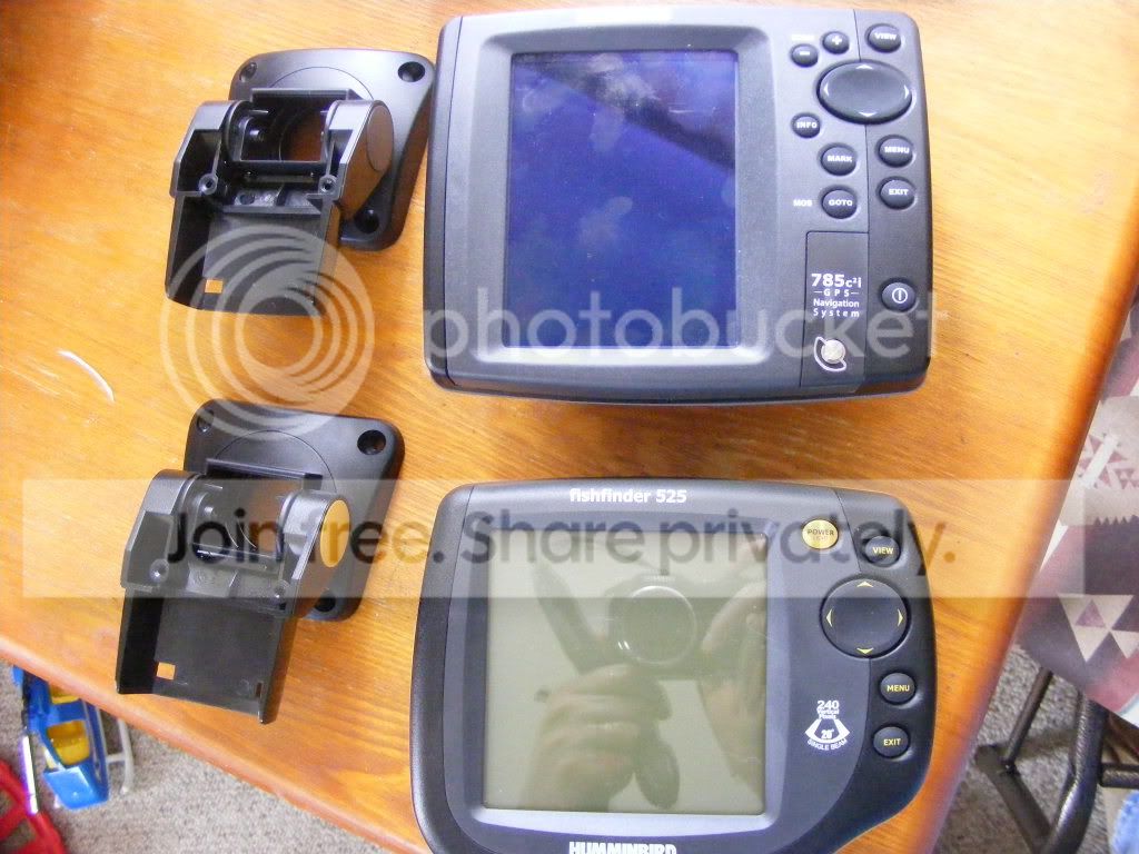

I just went through what you are looking to do. I found, because of the deals I hit it was less expensive to split them up. Thanks to Scott posting a deal on this board I got a Humminbird 785c2i GPS chartplotter with Navionics Gold+ maps preloaded for $235. I kept looking, almost daily and found a Humminbird 525 fishfinder that has several alarms and a hefty 5" by 5" screen for $128 shipping included. Just recieved it yesterday I can have both systems running together and get more visual information without using a split screen.
Hope this helps. Look for those deals daily on Google Shopping.
