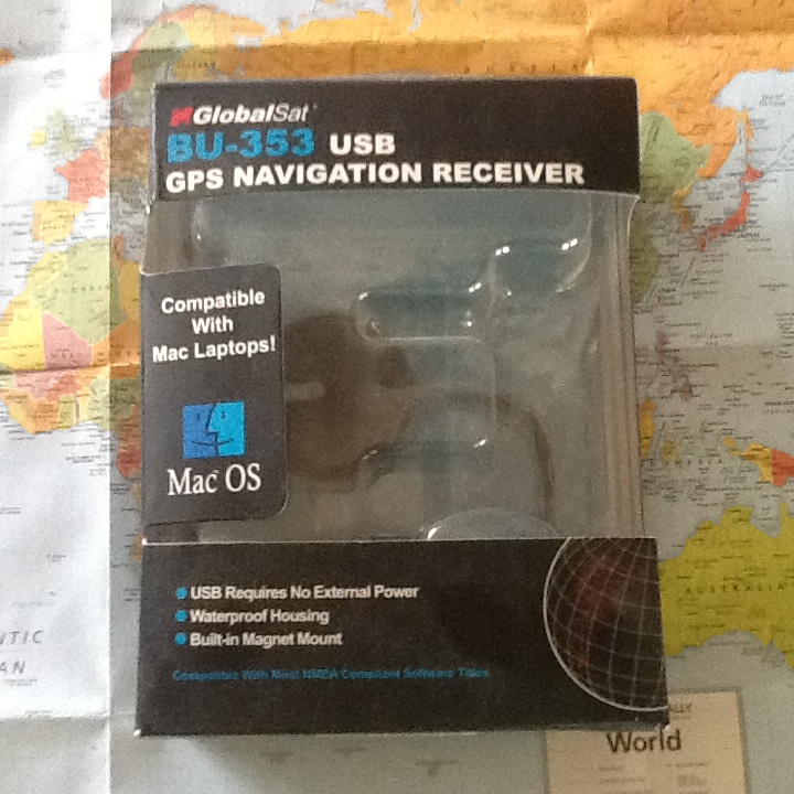

Can anybody suggest a GPS unit that I can install at the chart table that will send GPS info to a computer via USB?
kloudy1's already set you on the right course.

It does not appear that this unit has a screen which will display the current GPS information. For us the computer nav program is just for teaching and fun; I need a dedicated GPS unit installed at the chart table that can send info to the computer.
Feb 20, 2011
8,062
You're familiar with the programs OpenCPN or Google Earth, correct? They're free, and will display your lat/lon from the puck.
