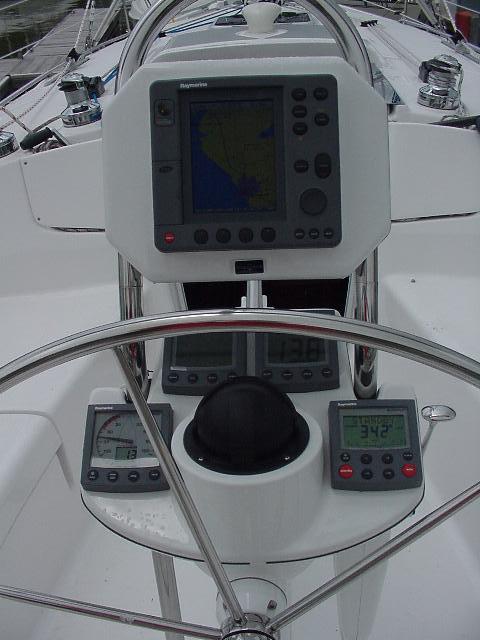

I have an integrated Raymarine HSB2 system with the 7" color chartplotter at the helm and laptop at Nav Station with Raymarine software. I have yet to fully utilize the laptop and it's planning capabilities, but will. I use the radar overlay on chart with the marpha tracking function quite frequently on Kentucky lake to avoid barges. When going into a cove, I split the screen with the chartplotter and sonar. This is great for shallow areas. I use my autopilot with both waypoints, going to cursor, and with waypoints and routes. I recently motored 30 nm back at night avoiding 2 tows- all with this system. I have ST60 instruments, 6001 below decks pilot with 150 course computer. Highly recommend this system! sv Persistence H356.

Jerry, Thanks for the photo. This is exactly as I envisioned my helm - nice and neat. Who's pod did you use to install the plotter head? I hadn't really thought about using a laptop instead of a second plotter head at the nav desk. In fact I liked the CP1000C because it doubles as a 10" display for a PC - backwards thinking? Could you post a picture of your nav desk? BTW my new boat is the Hunter 33 just announced at Annapolis boat show. Thanks again, Barry
